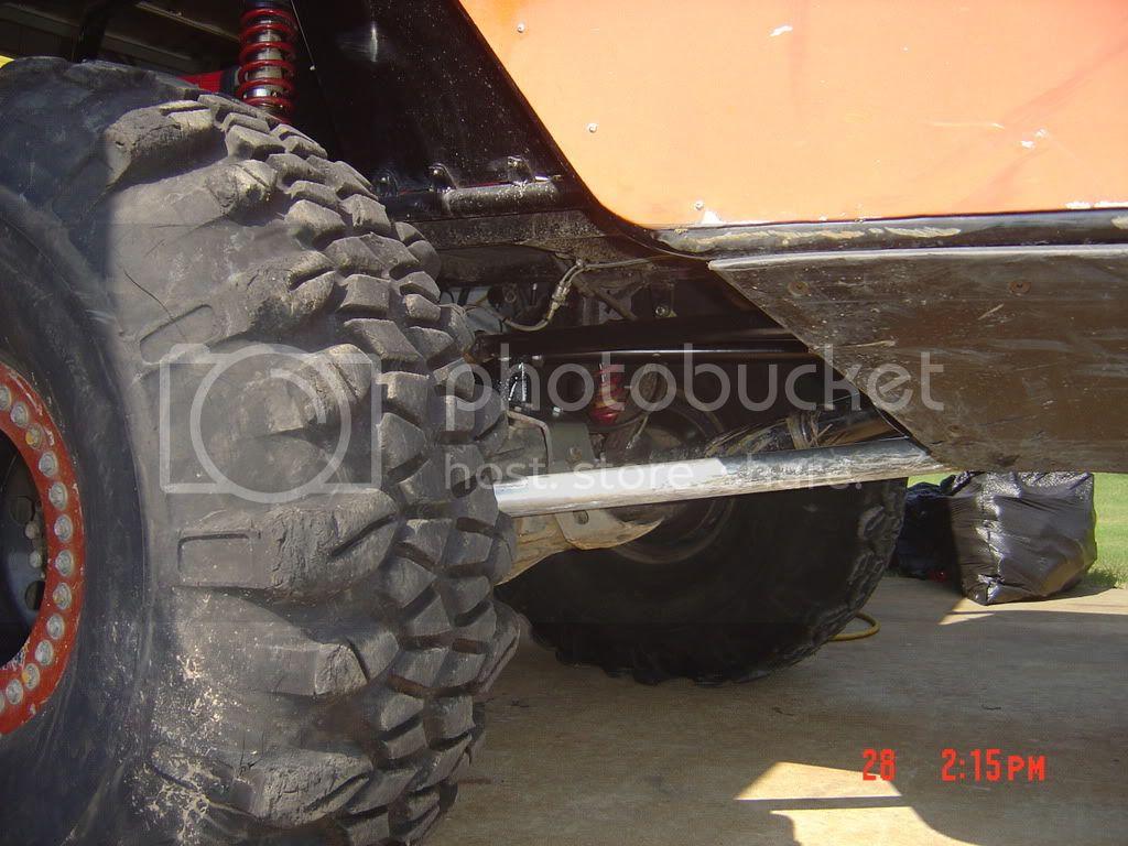

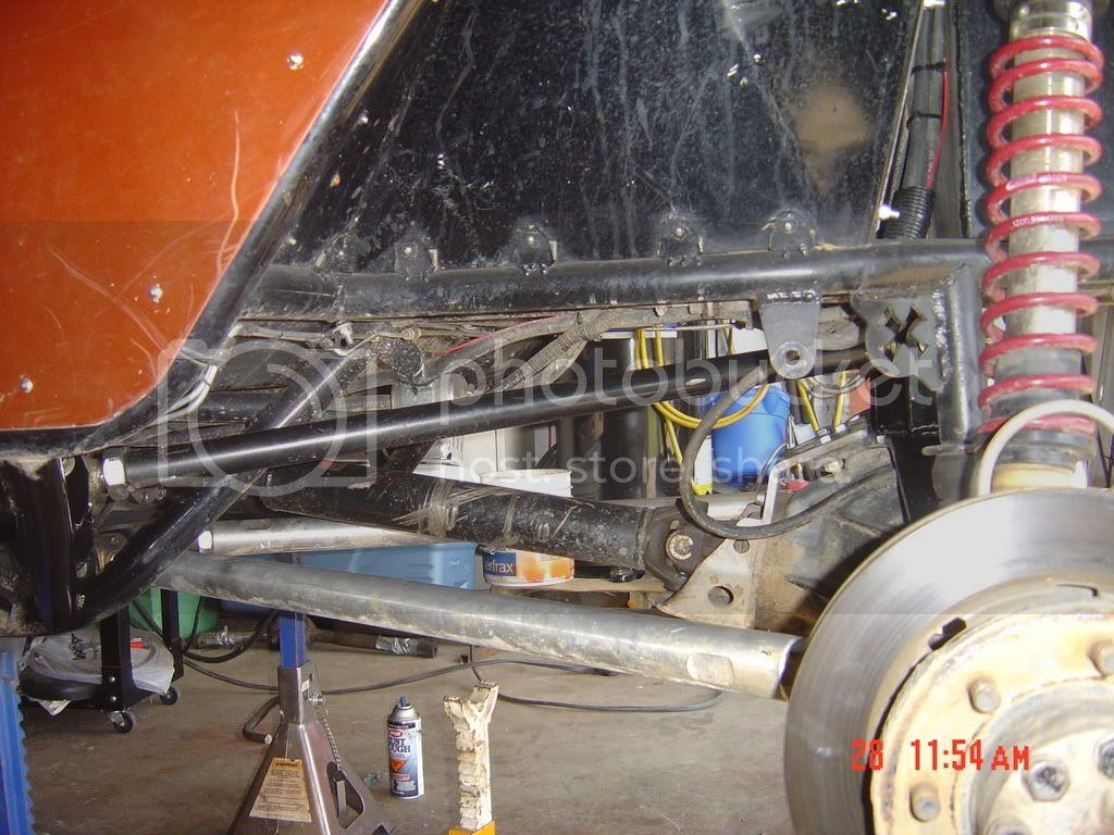

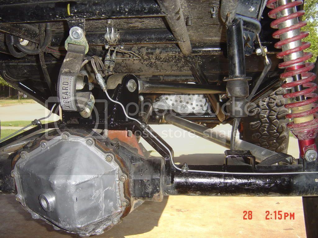

What I did was raise the uppers at the axle 2" and lowered the uppers at the chassis a 1-2". Now I have 10" of vert seperation at the axle and 6" at the chassis. The uppers actually have a slight slope downward towards the chassis at ride height.
Here is a pic at 1" from full compression just for ****z.....
