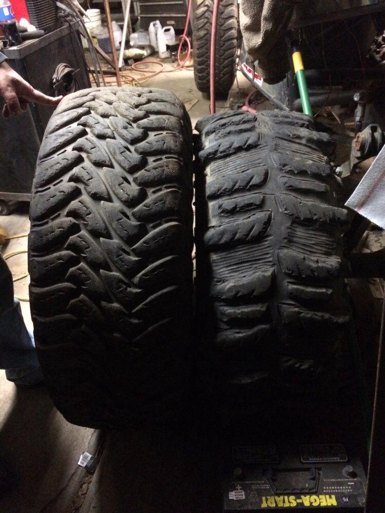

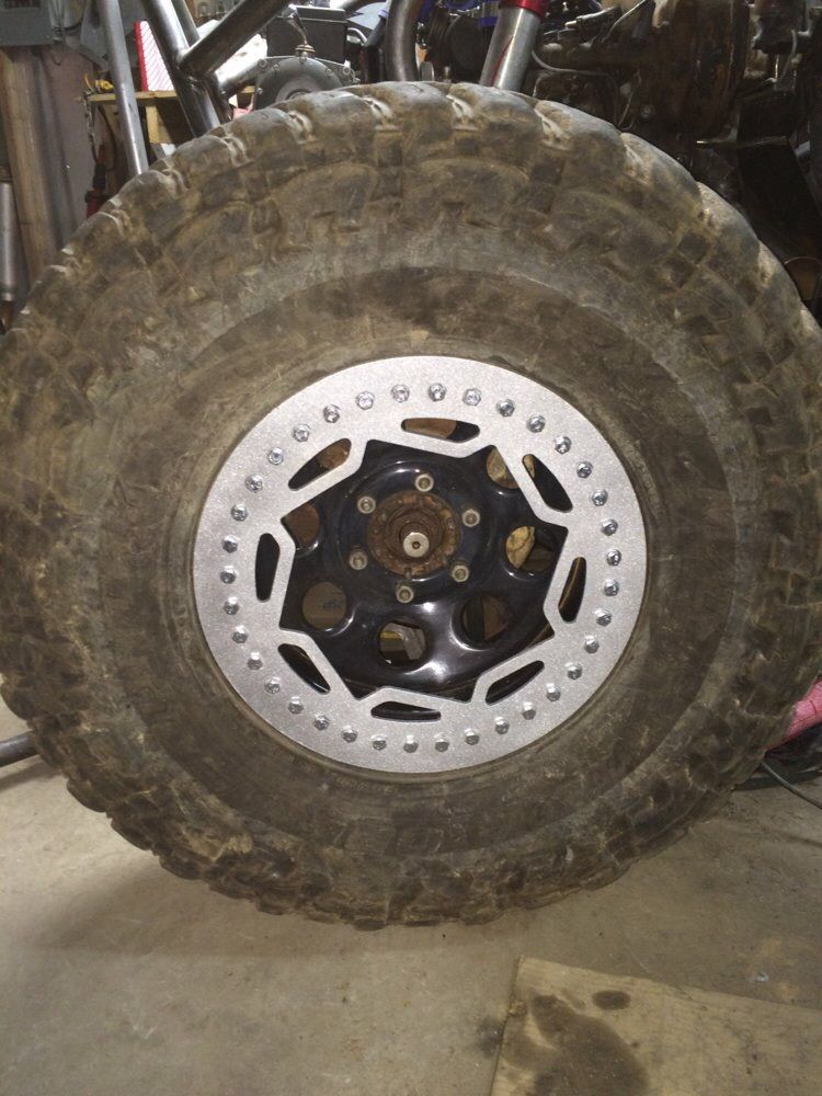

Was able to grab some beadlocks and used toyo stickies, don't know much about them. But I hope they were worth it. Got a great deal on the beadlocks, and started mounting my seats that I got last christmas, ::)
If anyone has info about the toyos, post up,

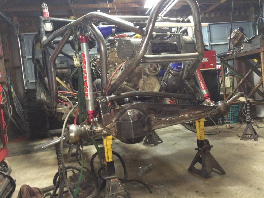

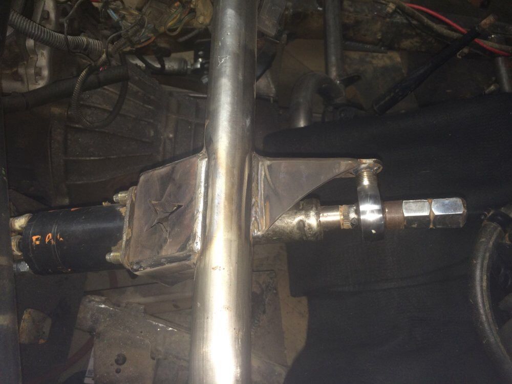

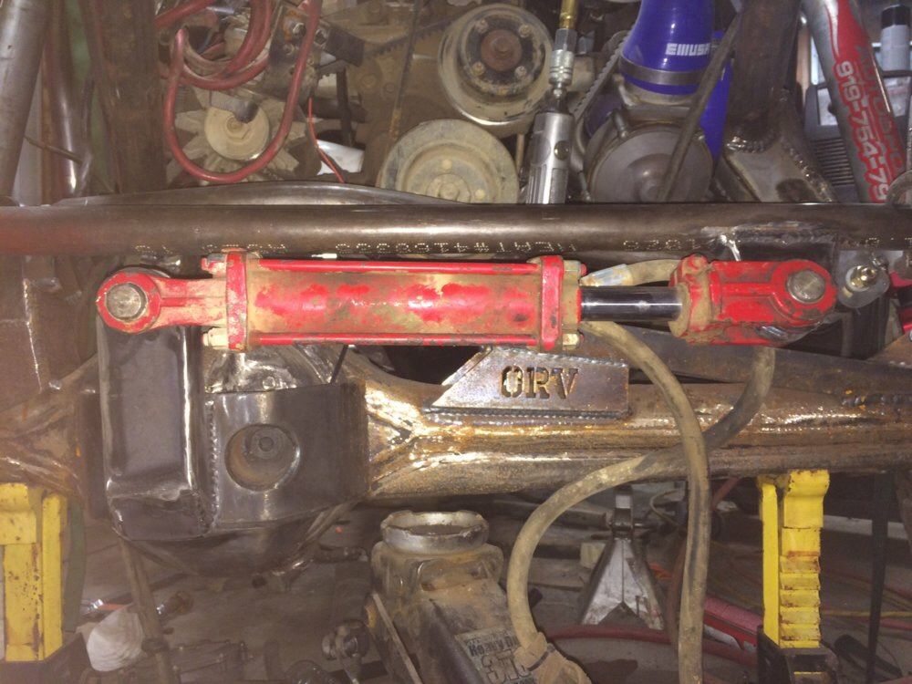

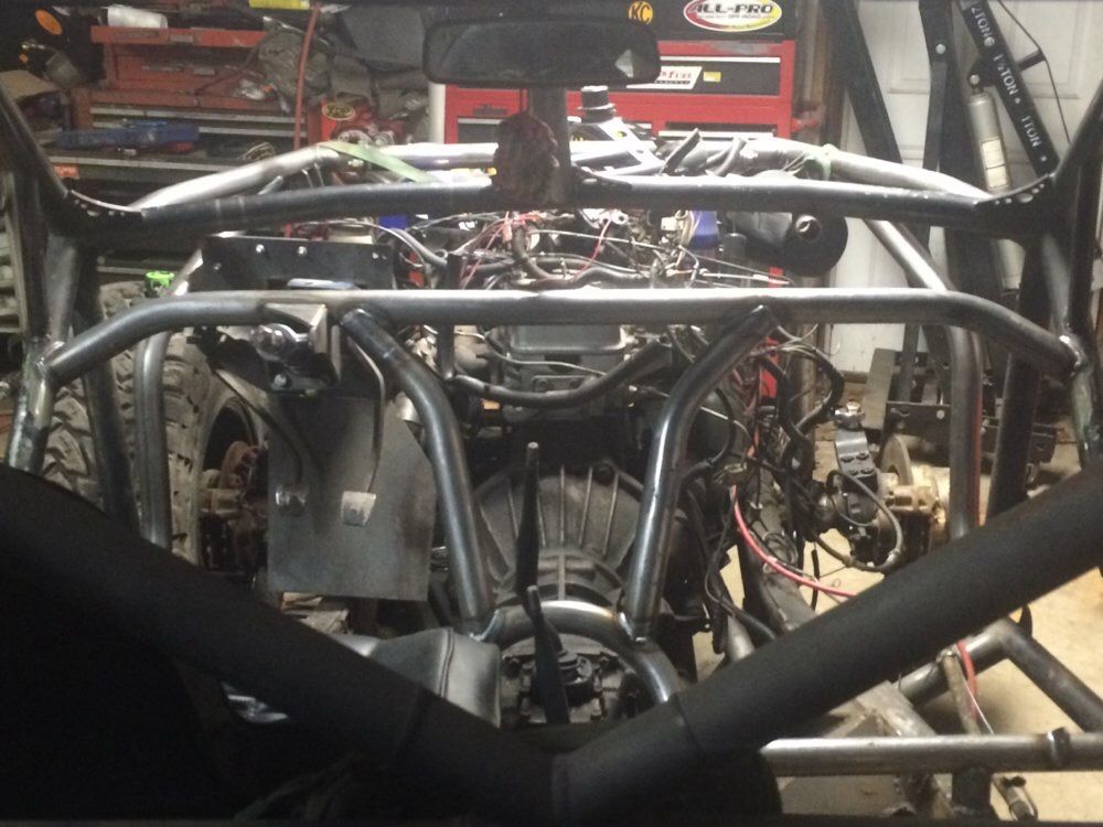

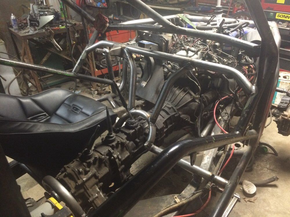

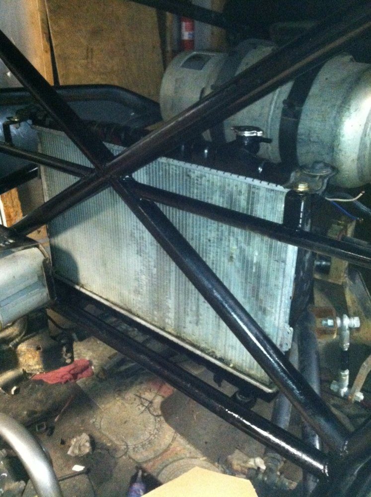

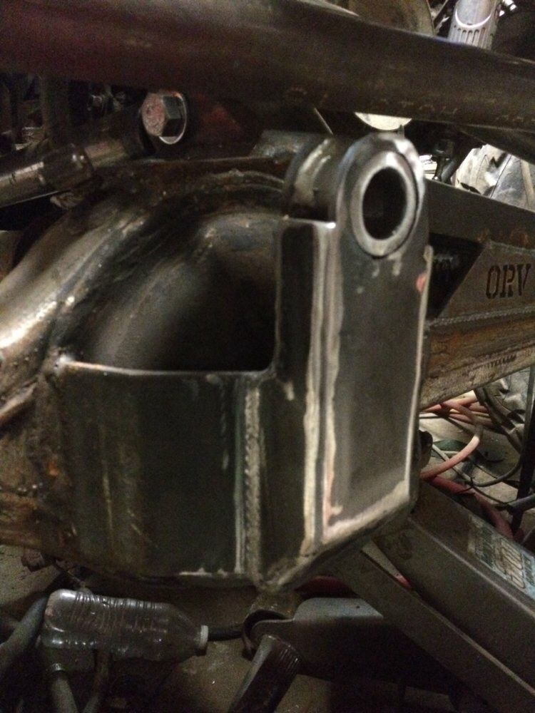

I have been trying to knock things out at a steady pace, thanks to a lot of friends that come over and help me make decisions and help get it moving along, I'll shut up, here's the pics

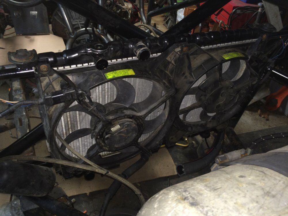

I have the seats mounted, I have the rear radiator mounted, I am in the middle of mounting the marine exhaust tubing for the radiator and moving onto floors and brake mounts, trying to keep factory brake booster and clutch , just cause they worked so well, we shall see
