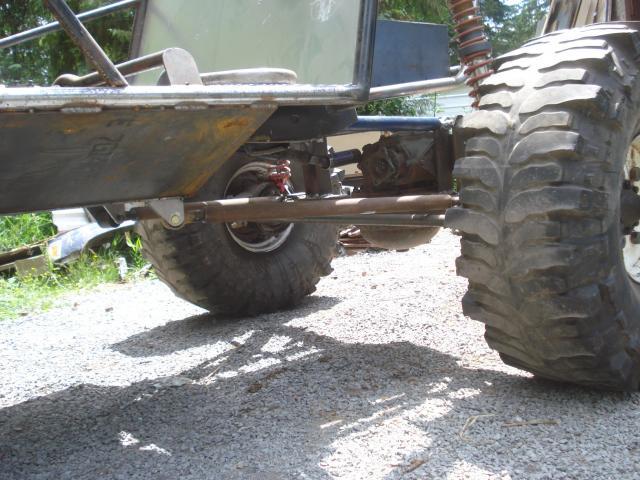

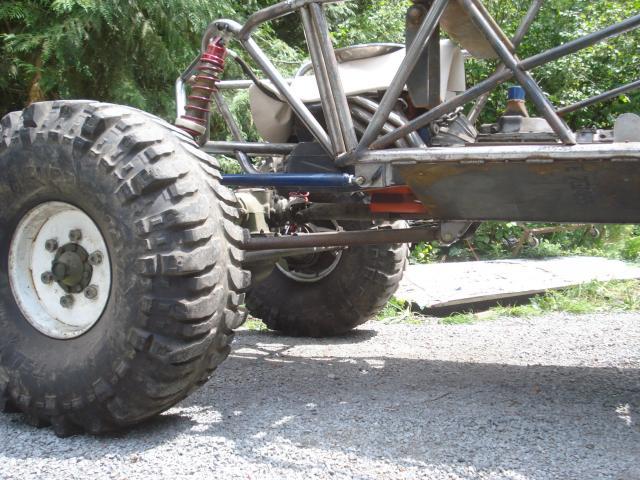

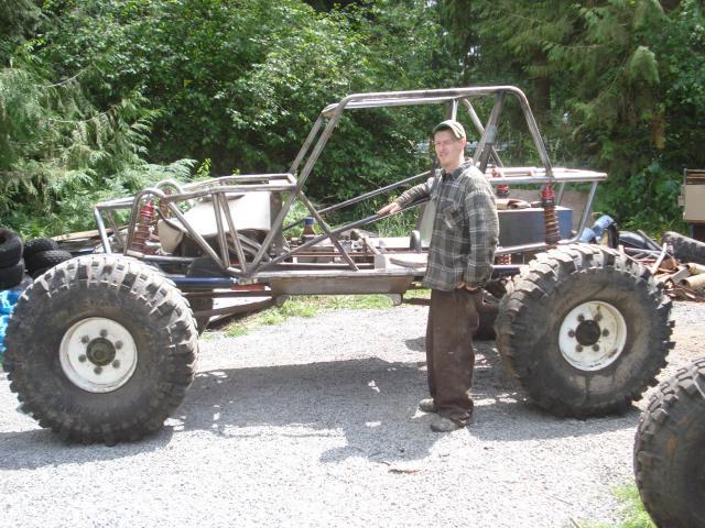

I didnt really do anything, but i did roll it out for a couple pics.
Our model Paul shows the size of this here machine.:D
