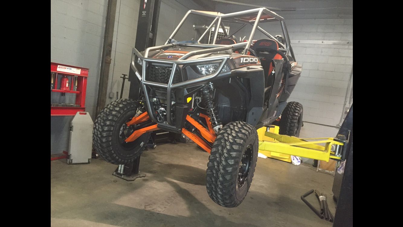

The first step was a cage. Wide Open SXS has a bunch of production cages available, and while they all were top notch products, I was looking for something a little more out of the box. They came up with a new design which is now a production cage. I think it turned out pretty great.
The roof bars are directly over the driver and passenger head for safety, with the stylish bend there is plenty of room for me in a helmet with factory seats (6'2")

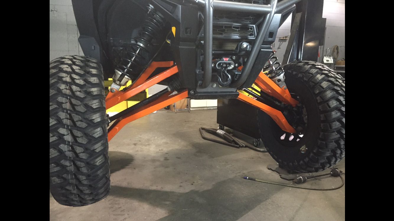

Once they cage was finished the next order of business was suspension parts. I'm not a believer in high clearance radius rods personally. I feel like a pre-bent part is just asking for trouble. Again, just my opinion. I'm planning to go with Wide Open SXS's 7075 Aluminum links with 5/8" rod ends. You can see they're twice as beefy as the flimsy stockers, not to mention a way stronger material.

Picked up the cage from powder, installed the PRP seats, PRP harnesses, PRP doors, storage bags, and put the cage one. I consider this to be "stage 1" of the build with a bunch more to go... Update coming soon!
