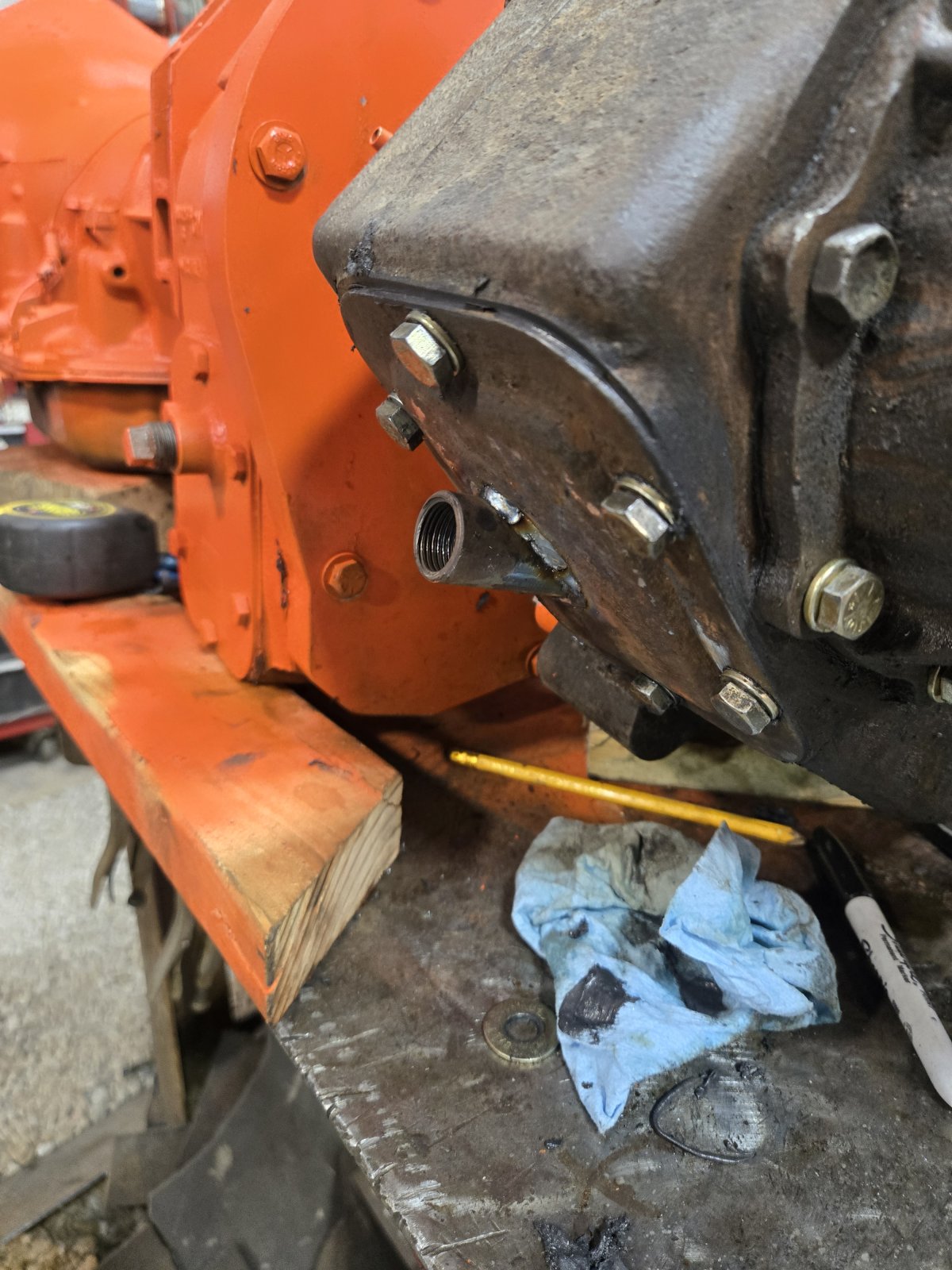

Started tinkering, hated the fill tube i installed years ago works good for filling, but no easy way to check fluid level.
Thought about a sight tube, then decided against it.
205 is clocked flat, came up with and idea of using the lexan had laying around, made a window filled case with a little over 2.5 quarts. Scribbed a line transfered that to the metal side plate.
Still need to fined a plug, might order or make a magnect drain plug.
