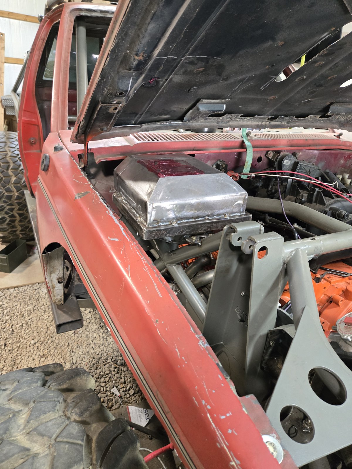

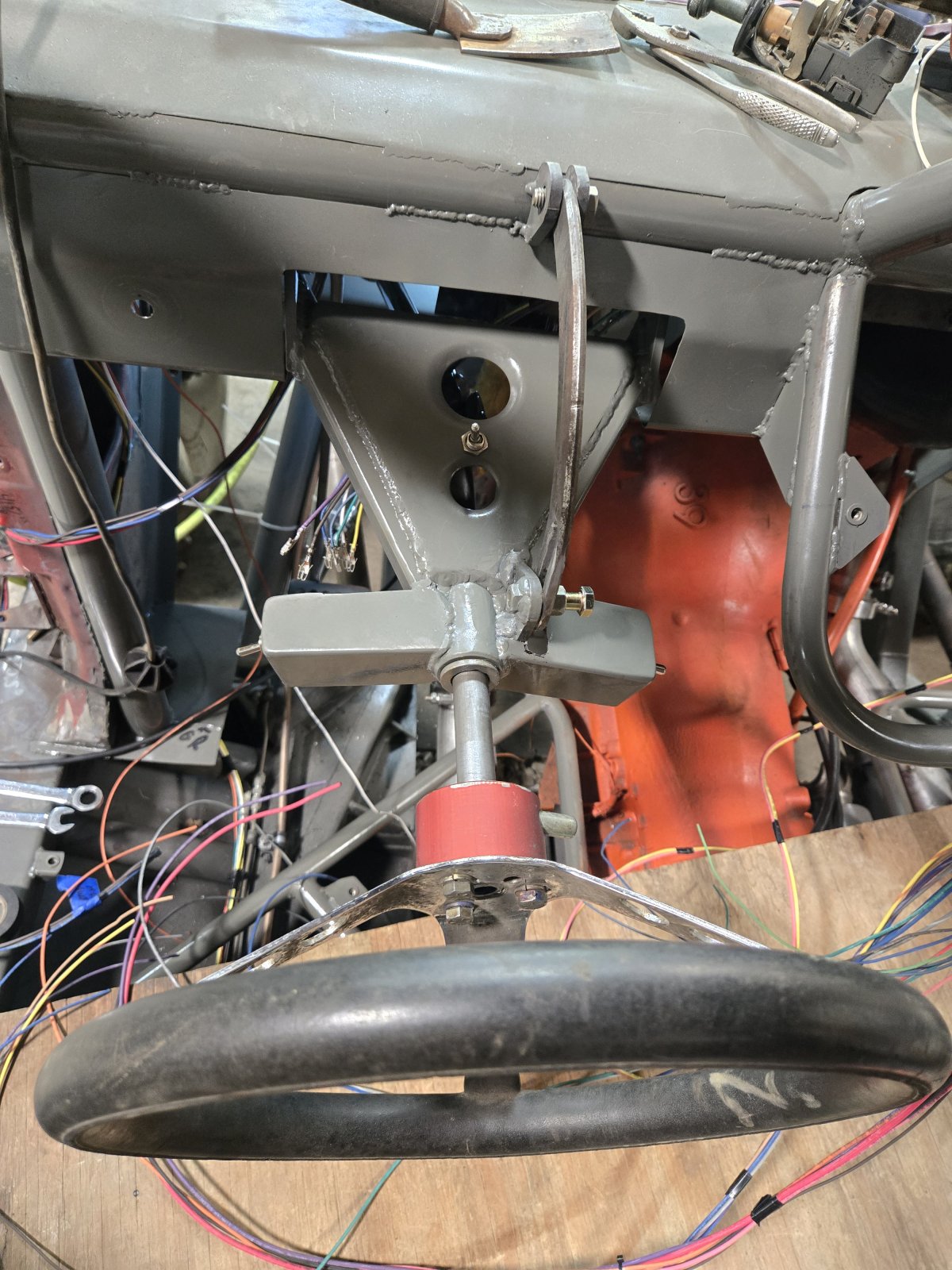

Got the PSI harness in looks top notch. But, I screwed up payed them to loom it out.
Not thinking about Im running the intake backwards, so I will have to cut their work apart and and move 3 plugs to different spots in the harness.

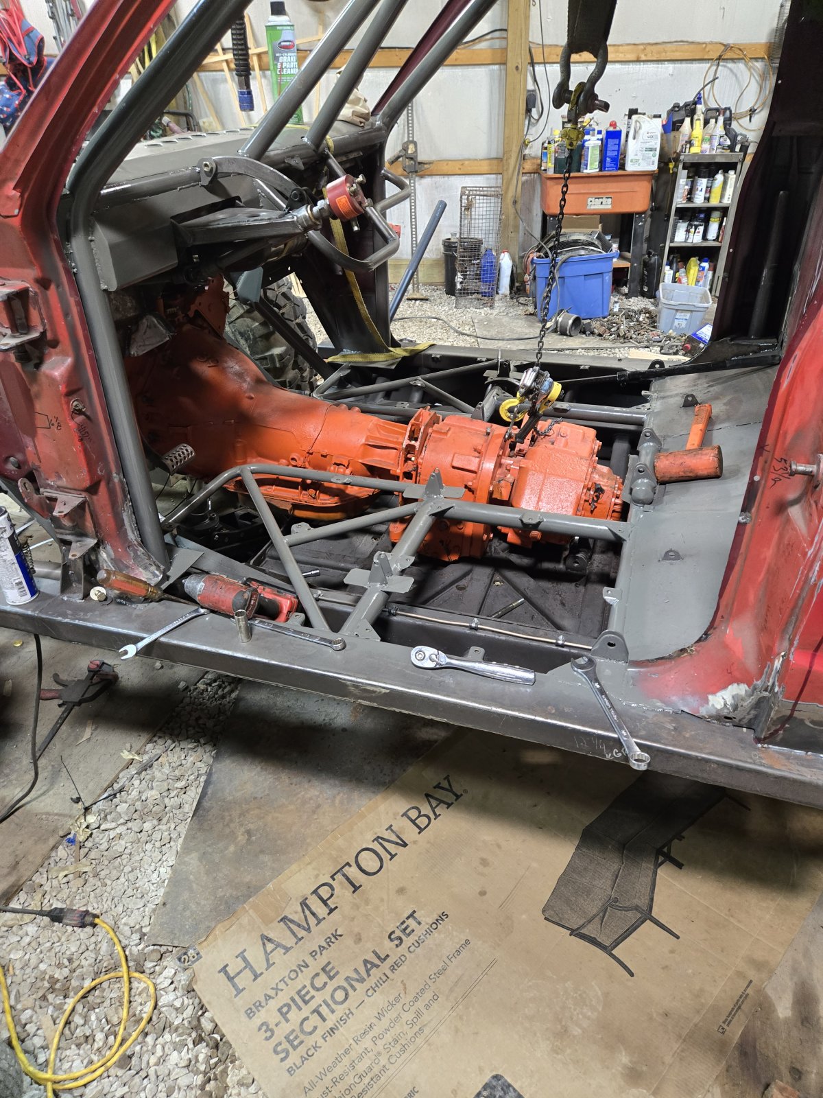

She is going back together, had 4 day weekend so ive sweat my balls off to get drive train in.

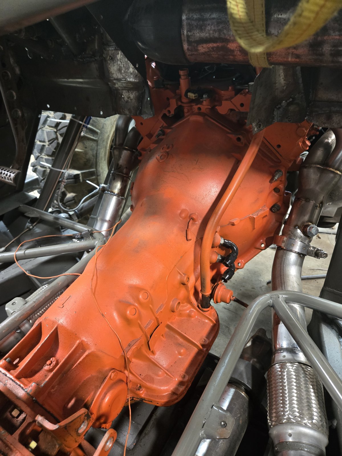

Forgot that the transfercase has to go in, in a certain order started to cuss the engineer, remember it was me :rolf:

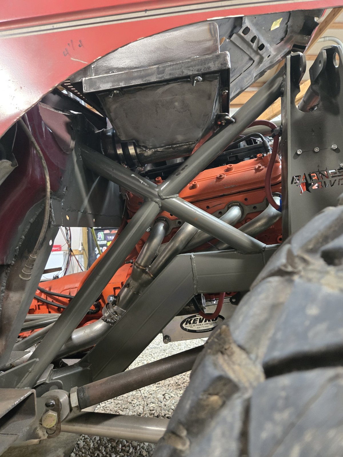

Started reworking the exhaust, deleted the 3 bolt header flange collectors. Gonna have to rework the pass side a little bit and added O2 bung, next step will be plumbing, and wireing.
