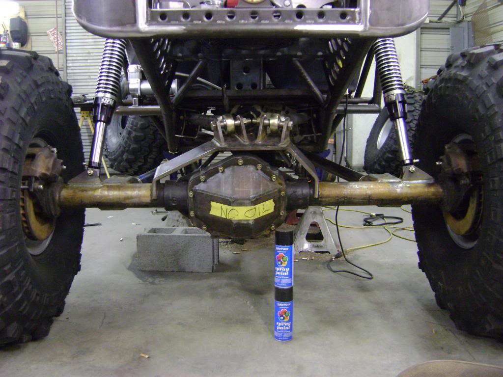

I have the original Ballistic fab kit and ecgs shaved 5.13 gears, 4 years strong. Much more confidence on not getting hung , just add woopow.
These pics are with 42sx2's, now running 43 sticks

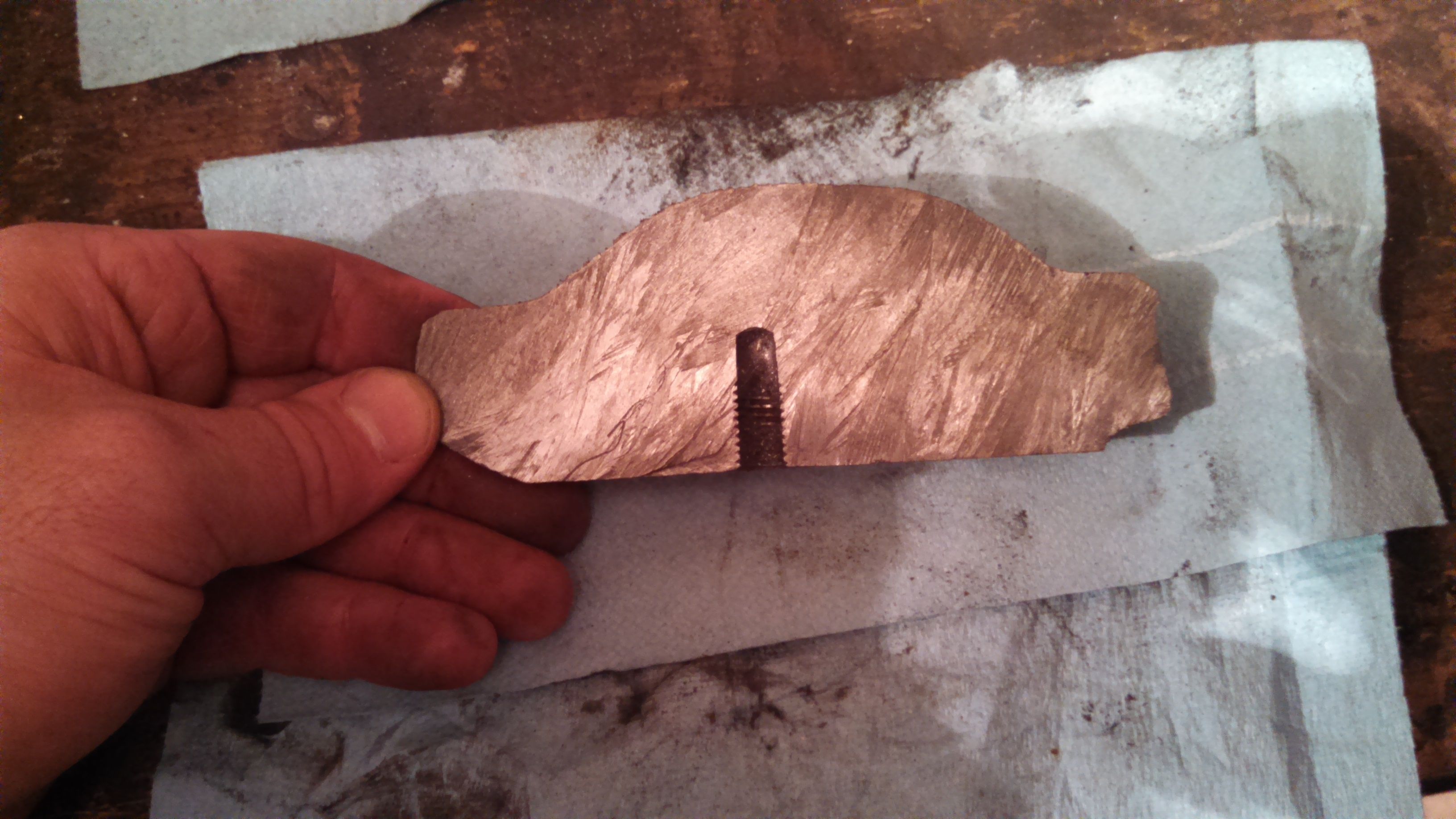

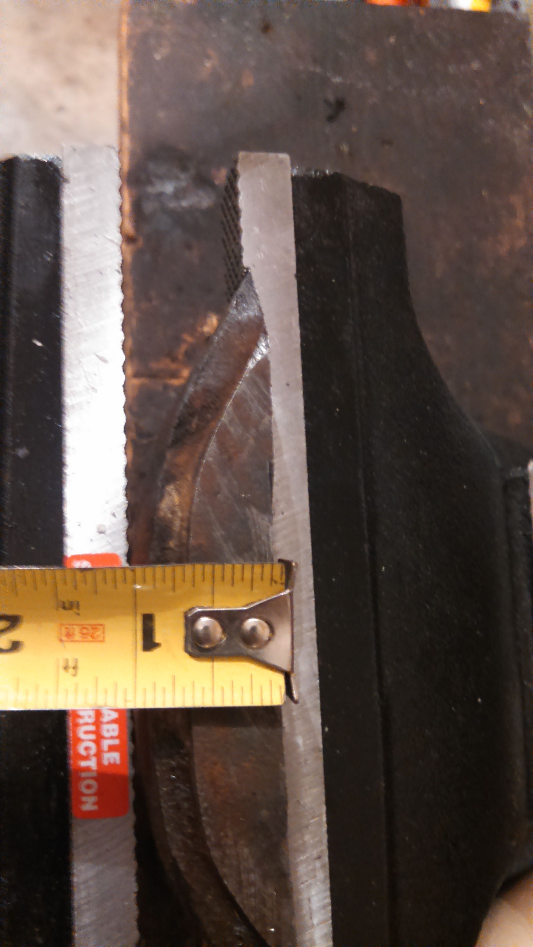

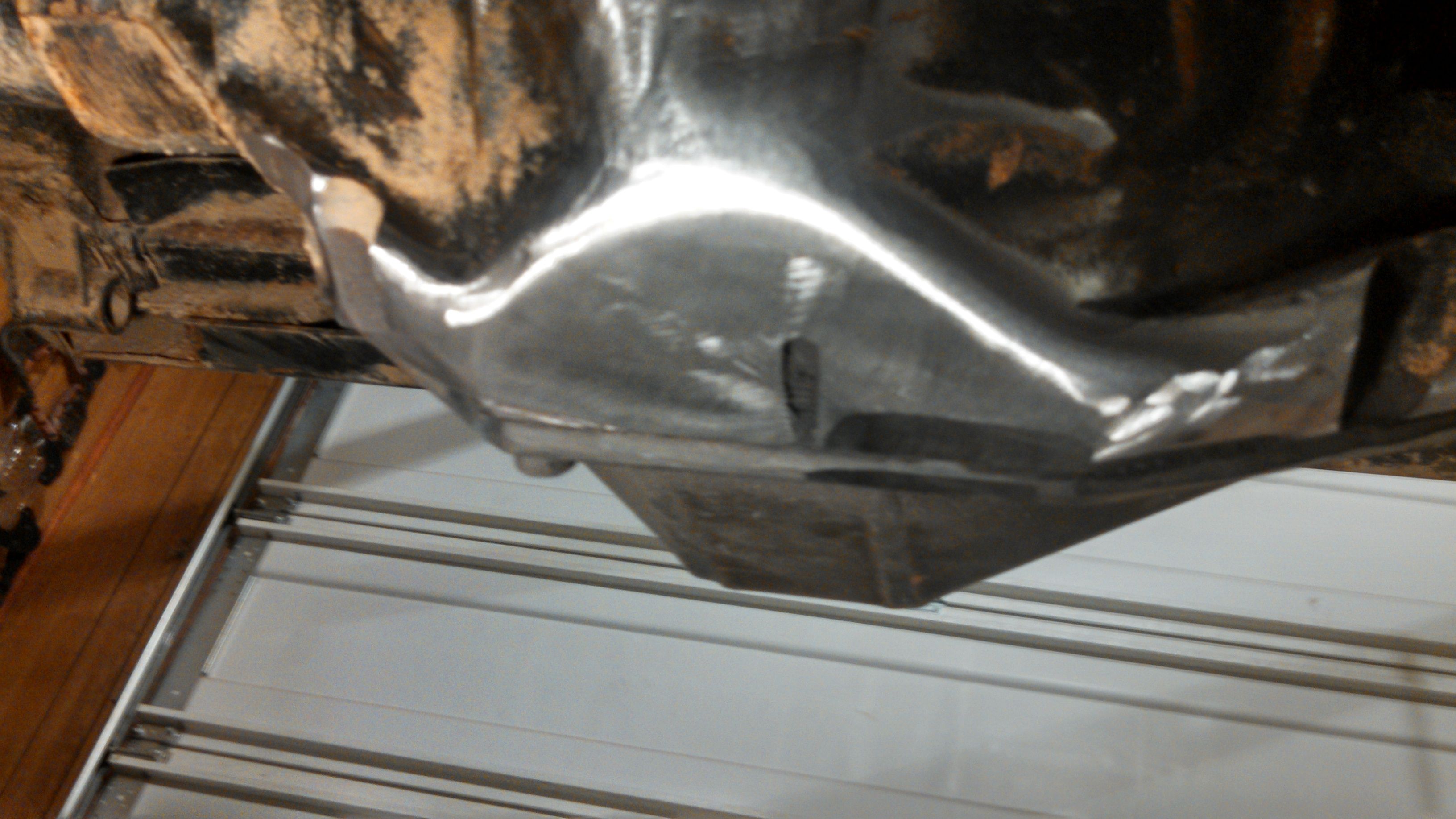

I ended up with the Barnes cover for Christmas. Few pics if anyone cares or wants to do this on their rig.
We've used the barnes cover on 3 builds now, very happy with it each and every time. Its just to easy to do, can't see frustrating myself with someone else's kit, no matter how good they are.
