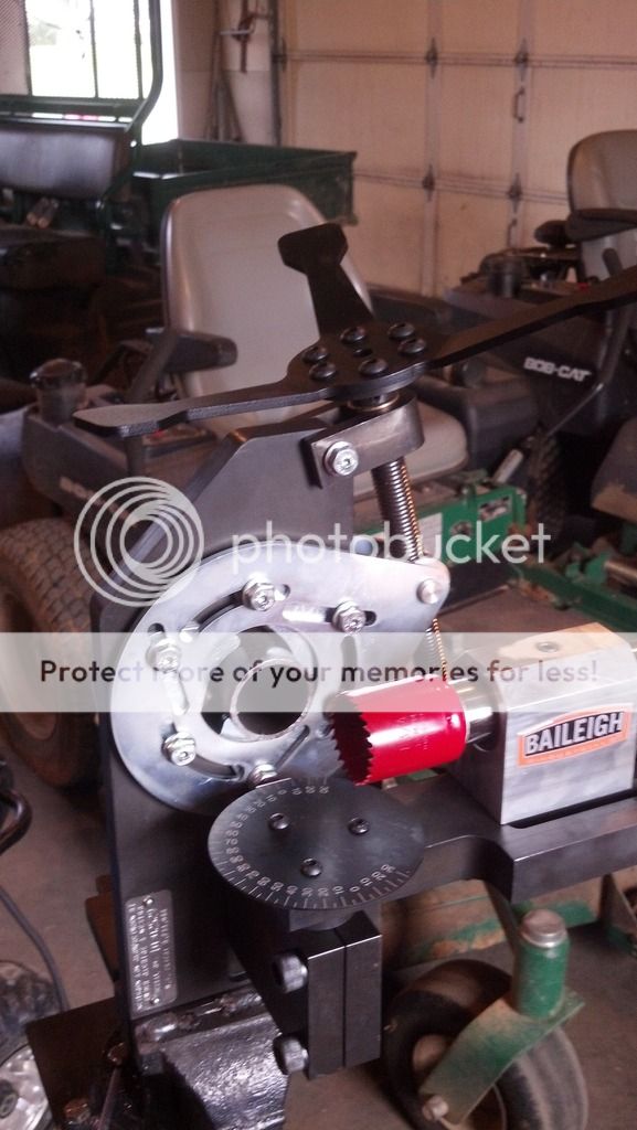

Baileigh TN 250 with Blu Mol hole saws, been using it for 4+ years. Worth every penny...
