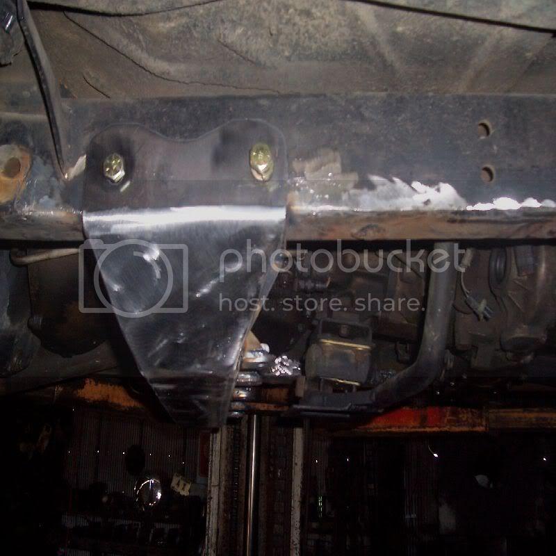

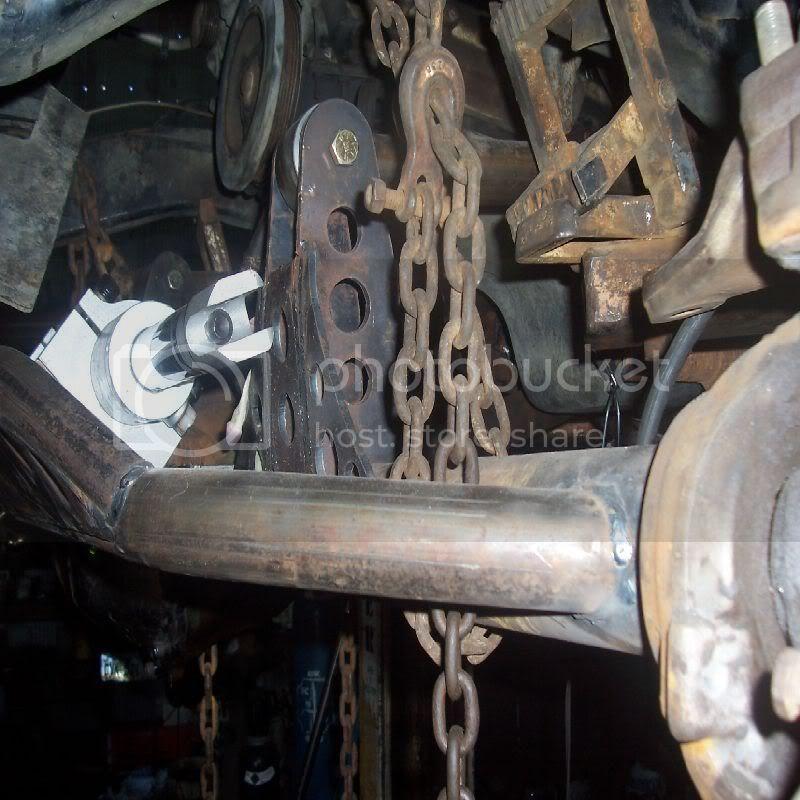

Currently I'm pretty much done with the layout on the upper links. At full stuff the front end is just in front of the front damper, and stuffs pretty much to the frame. 12* on each upper and 18* on each lower. I triangulate the lowers in because when you mount links on the bottom of a jeep frame, your tires are in the lower links at about 28* steering. gay. with this setup the tires hit the frame at the same time as the links. 2 piece front shaft with 1410's, links are 3/8" wall DOM with Johnny's at the frame and the same thing as a johnny with no shank at the axle.
the ram mount
the upper link mount

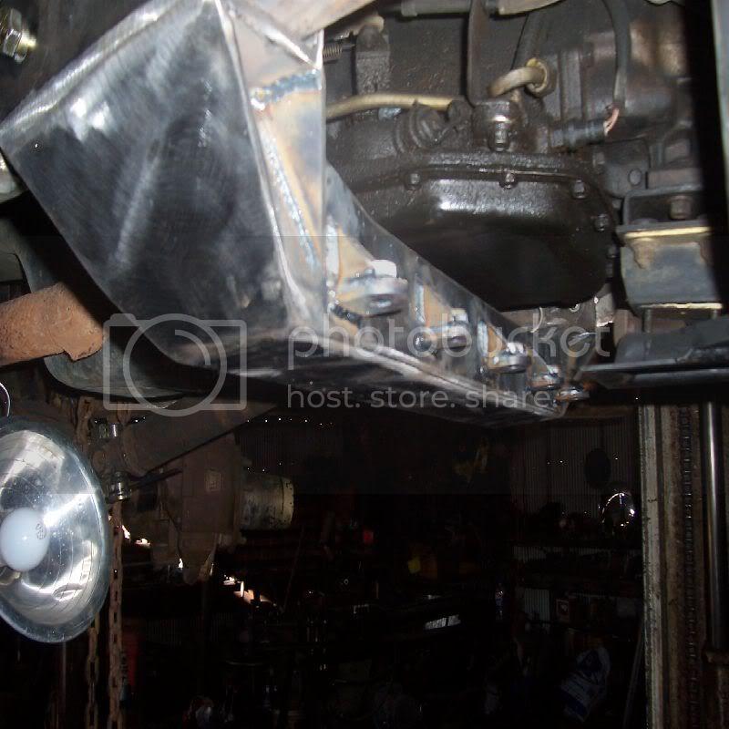

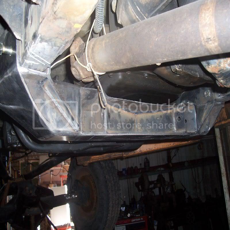

lower link bridge. the tabs hanging off the back are for the skid plate to bolt to. there are slots cut in the back of the crossmember that they drop into instead of just being welded on the surface for more shear strength.

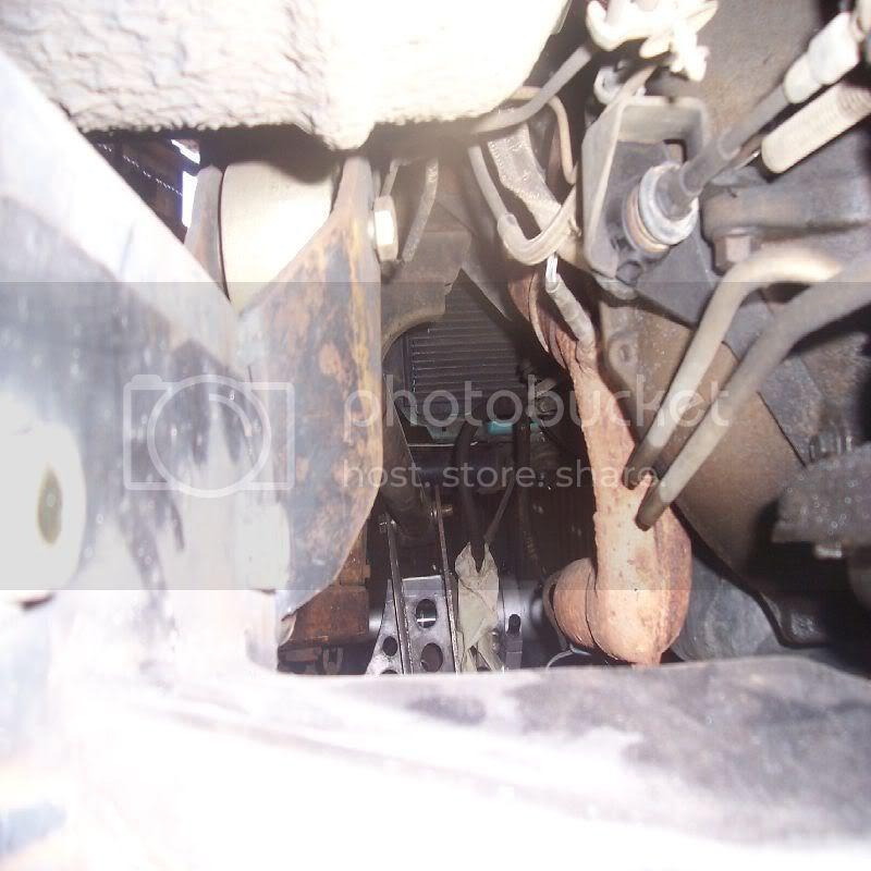

a shot fo the uppers headed forward at ride height. they stuff up till they hit the curve in the motor mount gusset. I feel they will get moved in 1/2" and down 1" before done, its whatever clears the front 2 piece shaft.

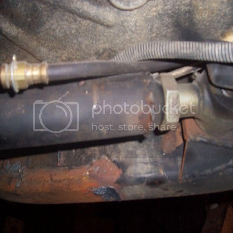

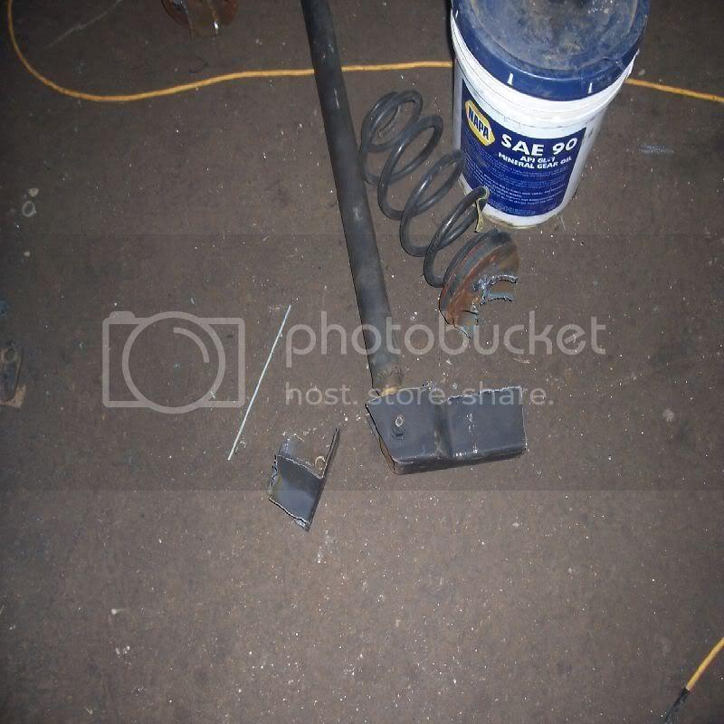

what it came to my house with on the frame, it was started by another guy in KC that is buddies with Ryan (tealJvl)

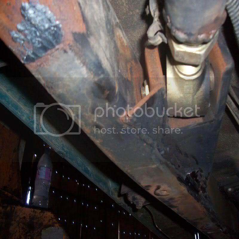

other old mounts

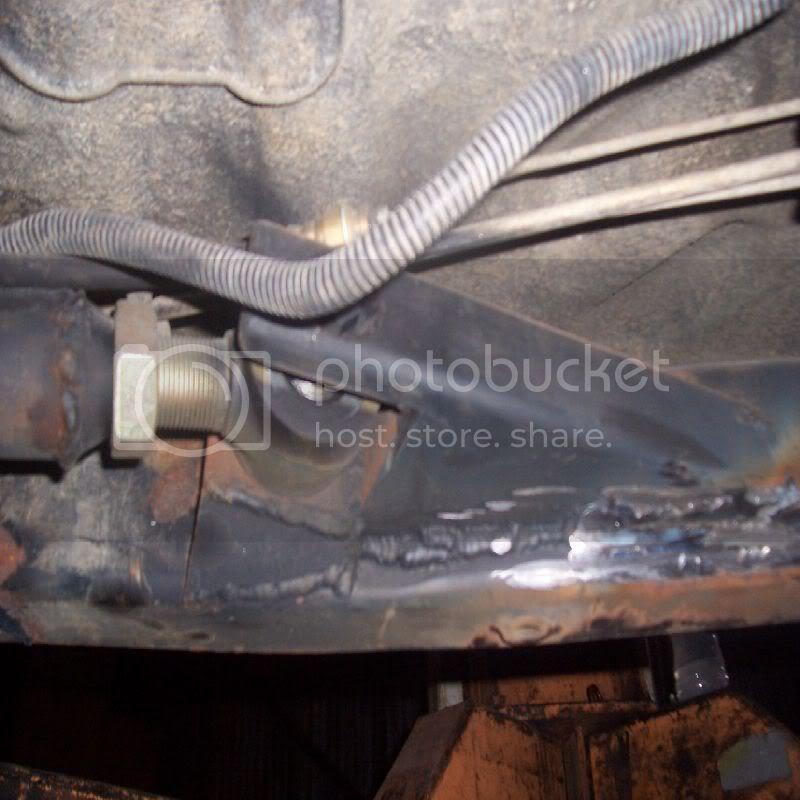

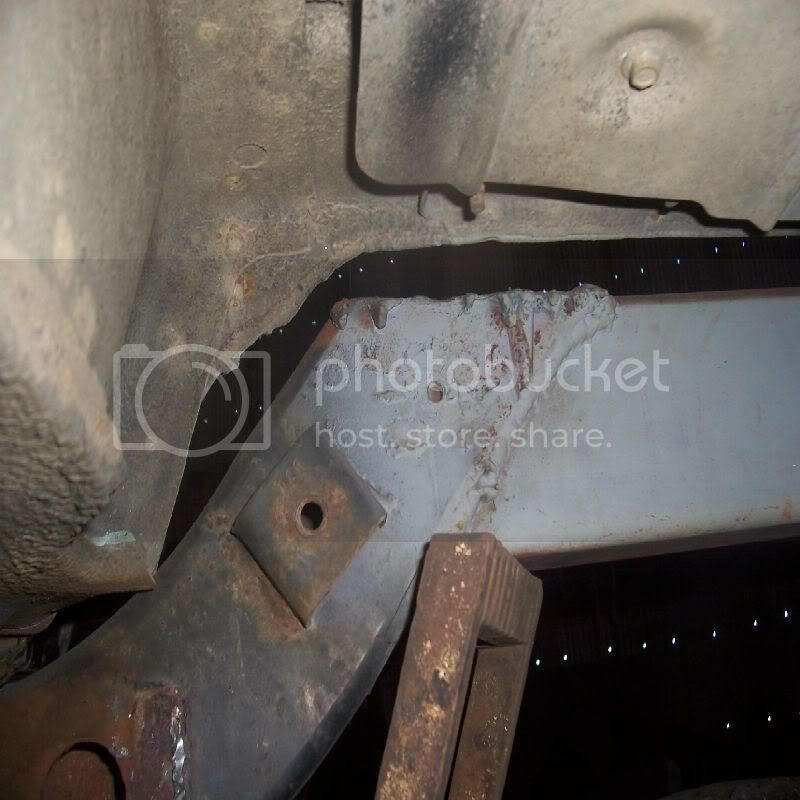

welds on the link bungs. I obviously have to gouge all these and reweld.
Frame is getting chopped again right in front of this to run the airs up into the tub. its getting dove'd at the same time quite a bit to make room for a big tsl stuffing from a crazy low ride height.

Going to go clean the frame and knock out the rear link crossmember now. thinking about making it bolt in as well, I hate pulling a tcase with a cmember in and you can do it without taking the engine loose.
that crossmember is beefy! Lookin' good so far! Ryan was trying to describe it and I was kinda confused.. I see why he was so excited about it though!! thumb.gif
