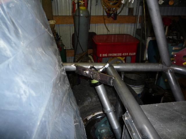

The rear seats are in place tacked and i am working on the upper shock mounts.
basic rule of thumb is shocks should be 5 degrees in and 15 degrees forward...if ya just could not get exactly that which would be more important? id think the 5 degrees in .

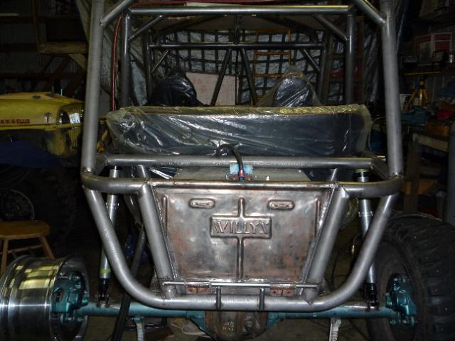

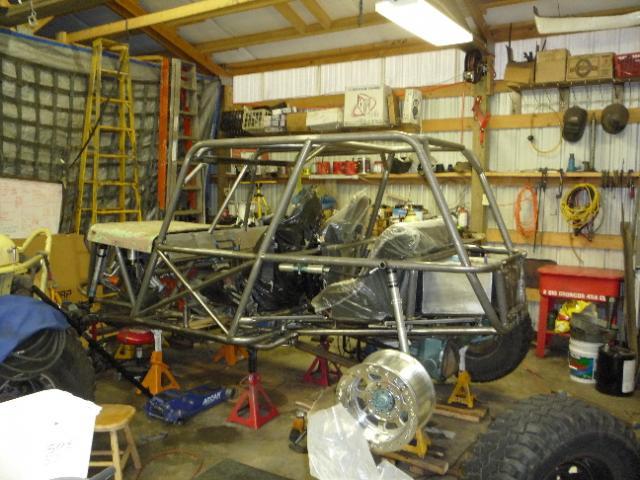

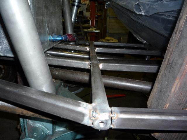

Rear seat mounts are in for the third time.
Subfloor frame is tacked in.
Rear suspension upper mounts are in.
Chassis is pretty much done except for production welding.

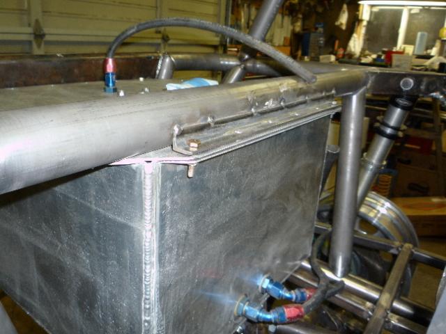

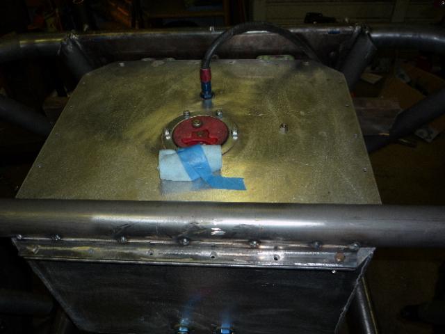

Fuel cell mounts are half made, upper front is done but i want two lower rear also.

some pictures of recent progress.
more
last ones for now.

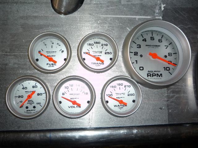

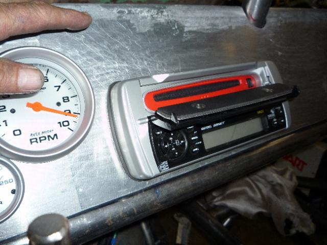

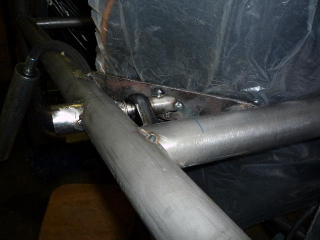

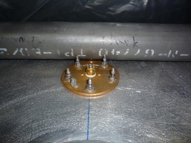

worked on the dash a little. also added a sending unit to my fuel cell.

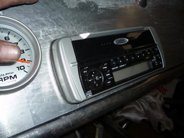

notice the lid on the stereo, hope this will make this one last a little longer by keeping the dust out. its a marine CD with sirrus and you can plug a mp into it also.

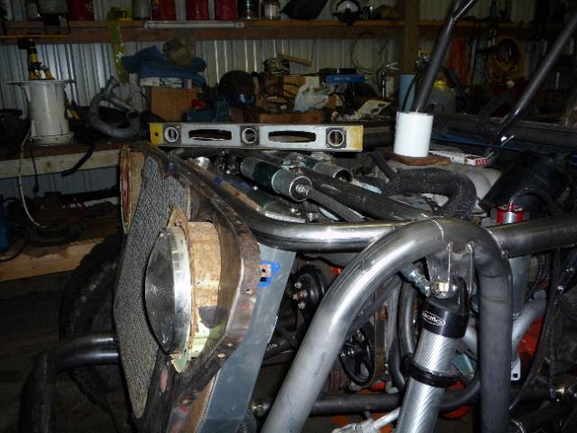

cut most of the front end off as it was barely off center when i put the hood in place. now its all straighter. hard to do this stuff with no help. made the front shocks at 6 degrees in, vice 5 degrees in, as it allows the original hood to be used with two small holes for the shock hoops to poke out.
will need to modify the grill somewhat to fit over the winch.:awesomework:
