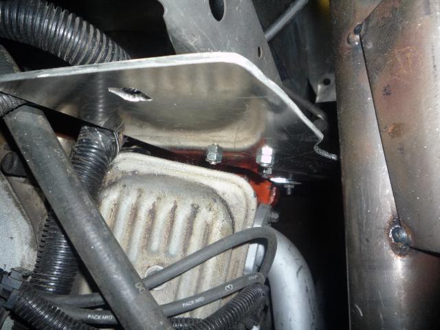

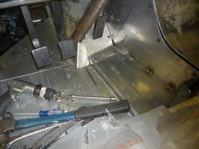

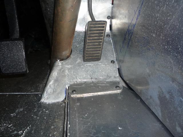

worked on more sheetmetal, center console and driver footwell for the gas pedal. ill post picture tonight if i remember.
made a real busy little piece for the foot well.

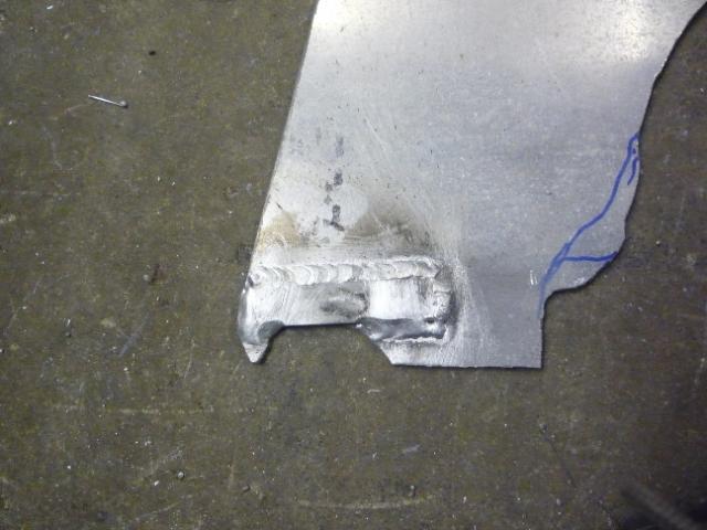

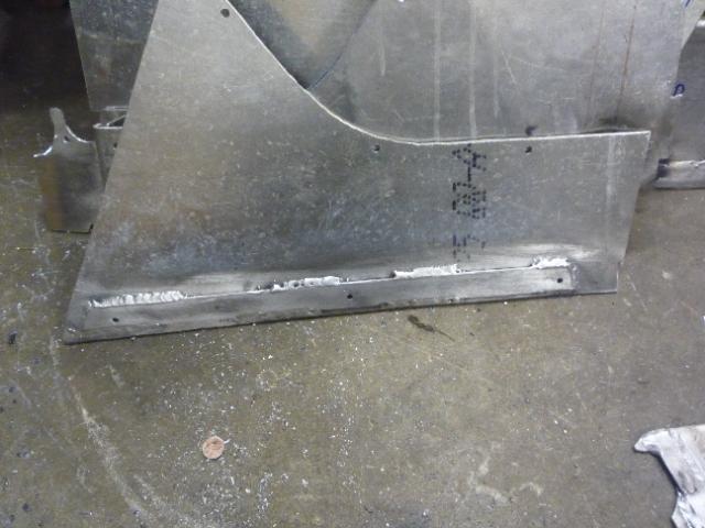

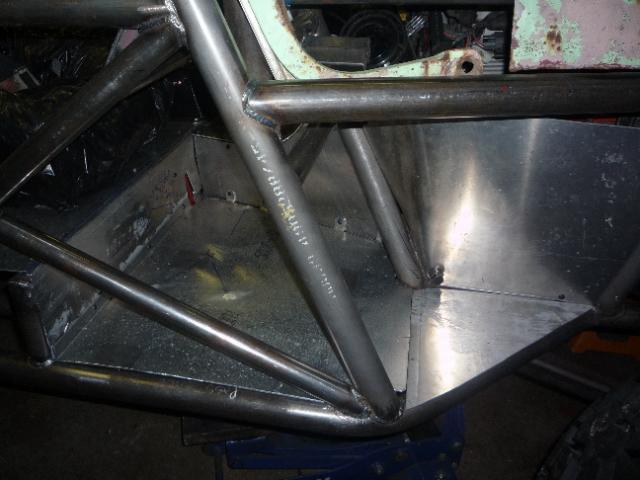

im not very good especially without a break, im just using a vise, torch, a couple large pieces of metal with a couple of C clamps:redneck: i got this little carbide tipped saw blade that i made fit a 4 1/2 grinder and i cuts aluminium like butter but it sure makes a mess. all the little sparkles are bits of razor sharp alum.:D

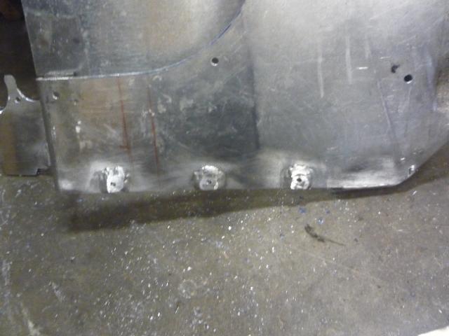

some of the finishing touches that will be hidden, thanks james for the welding.:beer: little tabs and or reinforcement so i can tap the aluminium for 1/4-20 fasteners and have enough metal to actually hold something.:redneck:

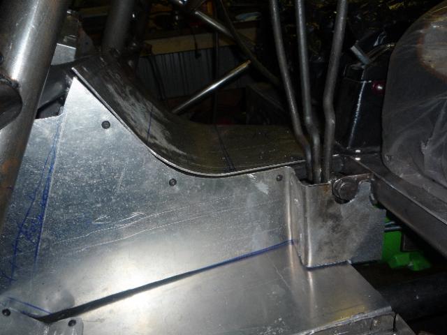

im sick of the sound of my aluminium saw cutting metal, makes my teeth grind. :redneck:
almost done with that phase. i thought i was all done but when i put it all together last night i realized i needed two more tabs welded for tapping.:looser:
one more long day and the interior sheetmetal will be done. then another week on the cowl area.....:eeek:

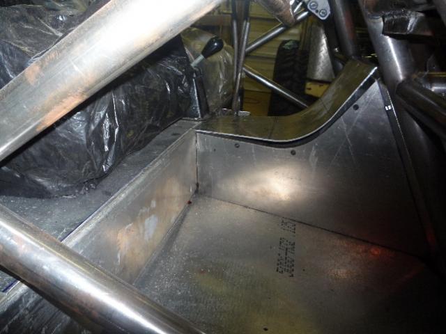

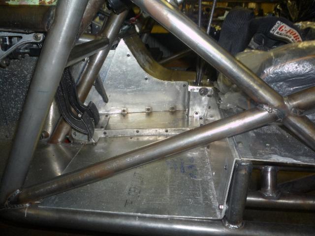

finished floor pans.

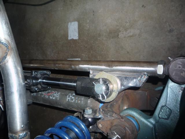

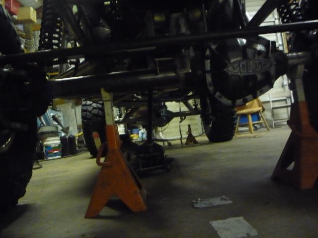

moved on to the steering mount
behind the scene first. then with the ram in place.

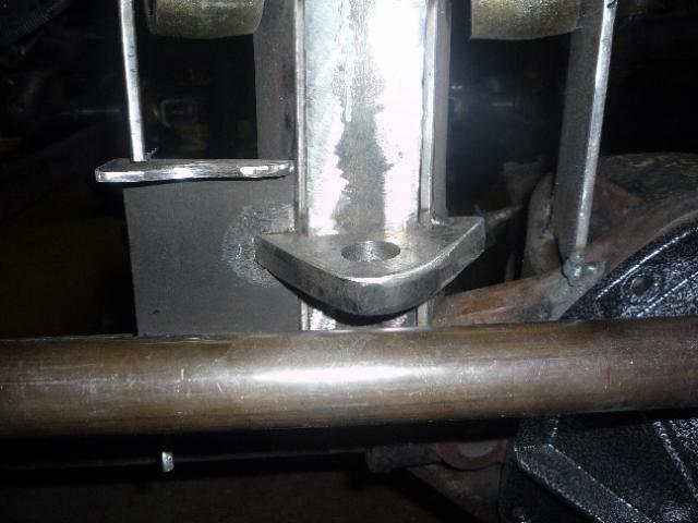

bump stop for mock-up?
anyone have any bump stops i could use for mock up?
one of the last things i need to set up and dont have the parts or cash to buy right now. if i could borrow one that would be great then i can finnish off fabrication and dissassemble for finish weld and chassis paint.

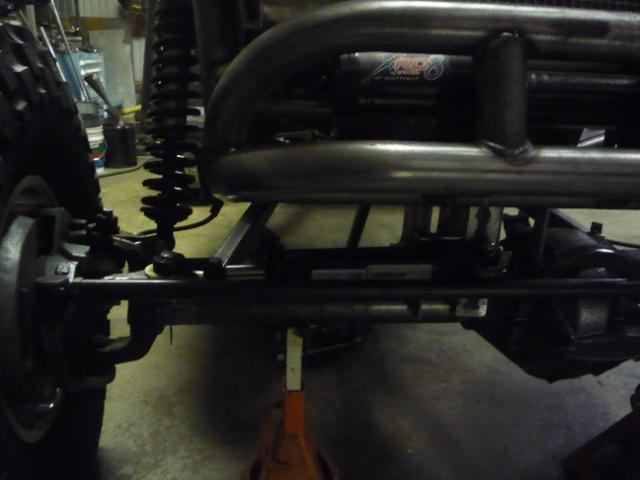

redid the fuel cell mounts , added the sway bar.
need to adjust the steering ram mount some as it touches the drag link at full turn.
