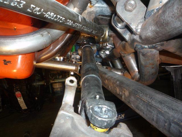

So i bought a 51 Whilly

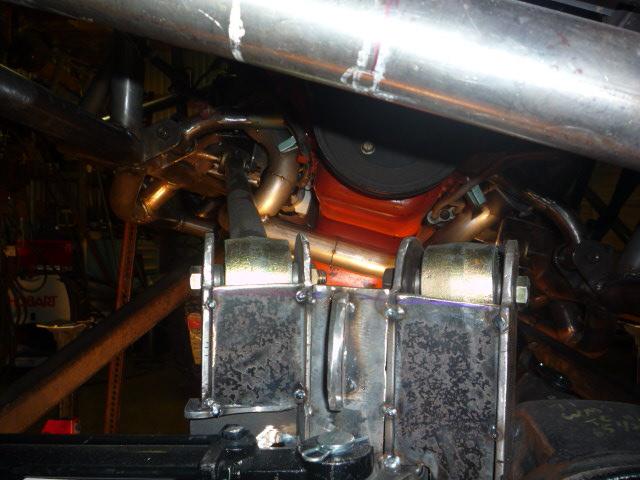

did the best i could to droop out the tight side and looks like everything will clear nicely. driveshaft seems to be ok also. if i could just find the right yoke for the front.:redneck:

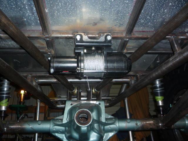

was gonna mount the little rear winch on the diff housing but it would not convieniently (sp?) fit between the top links. So its now in its happy home. will need a pully for the rear suck down attachment.

how much room is there between the upper link and the exhaust at full twist/drop on the pass side? **** looks tight!!!
it has a lot more than what it looks like in the picture, actually has over an inch.:awesomework:

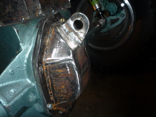

worked on the rear diff cover, i need a suckdown point as well as some place to clamp it while it gets milled for a gasket surface. probably tack another one on the other end then grind it off after machine.

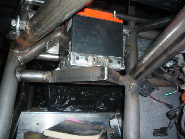

New battery box. its kinda cool as it has a built in hold down by sliding under the angle bar. then when the three bolts are added at is completely harnessed, sucker dont move.

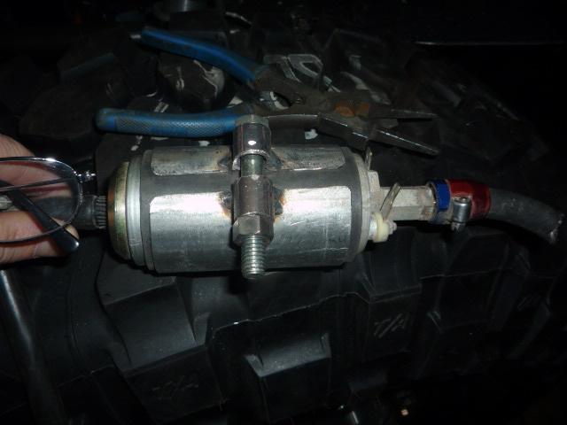

made another can to hold the fuel pump, from muffler pipe and a piece of 1/2" tube. with a piece of rubber around the pump it fits perfect.

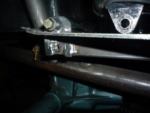

also redid the rear seat mounts as im tired of fighting with it. it seams every time i do something new it makes the back seat not fit again.:haha:
just made some tabs that stick up through the floor instead of the seat tabs droping through the floor. the existing threaded tube can now be the seat belt mount.:awesomework:
