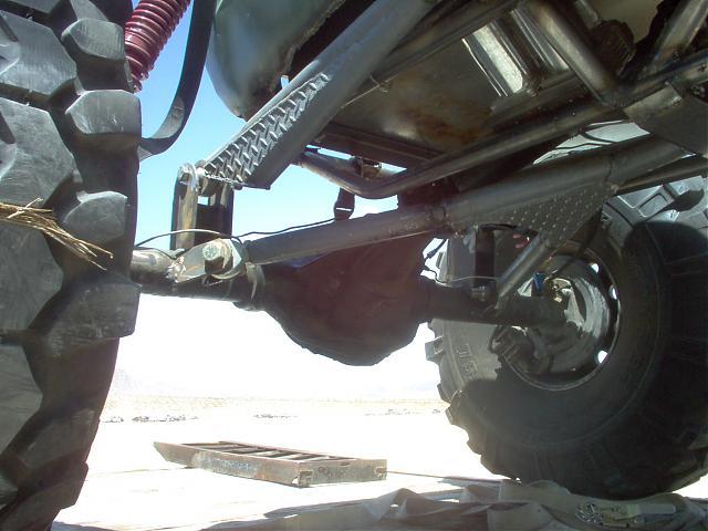

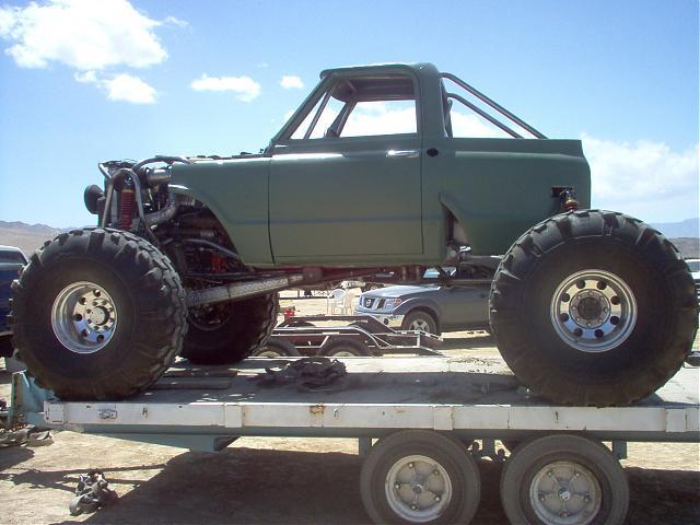

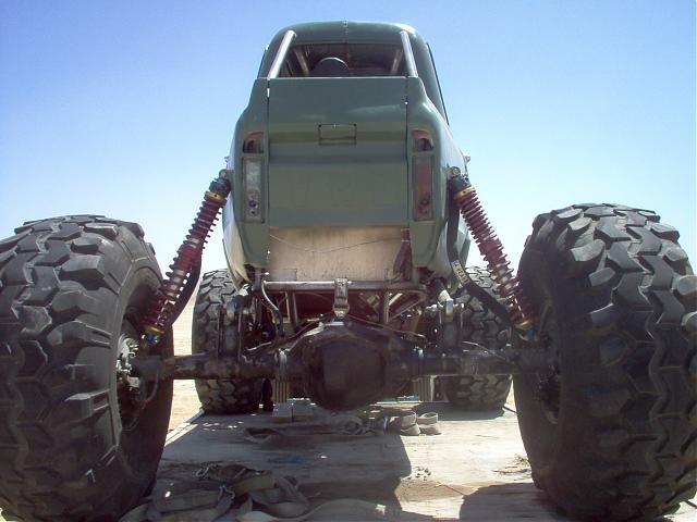

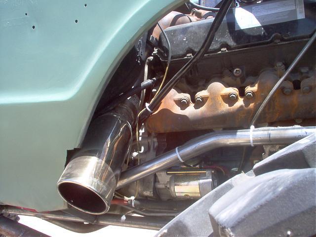

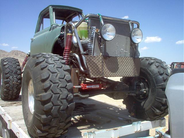

seen this at the hammers. thought it was kinda kool. sadly it never left the trailer.:booo:

dang that chevy is cool looking! why didnt it ever leave the trailer?
it was kinda cool. but made my truck look very well built:redneck: . it was kind of a roach when you start to look at it.:awesomework:

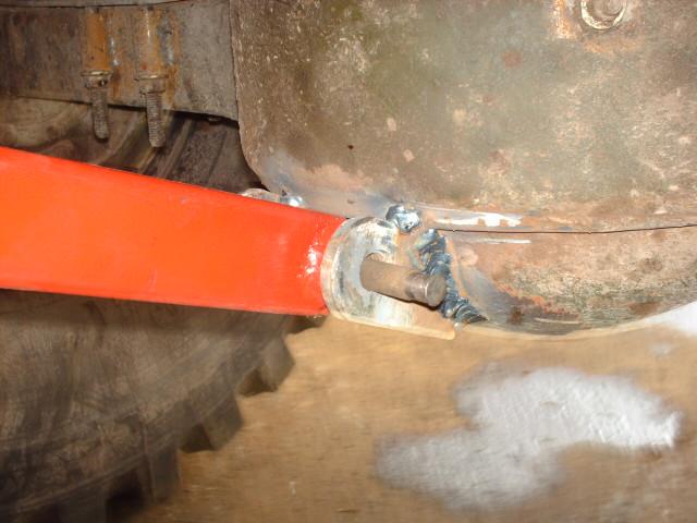

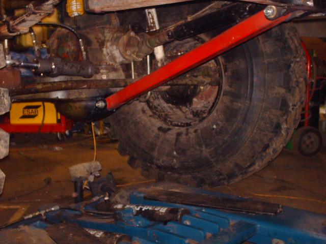

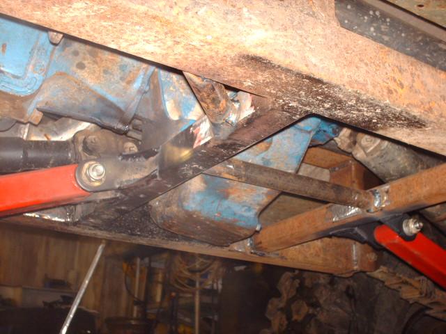

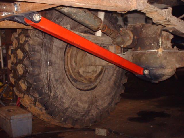

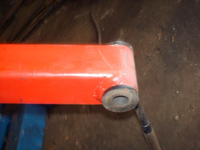

I got my traction bars finnished today aswell as the headlights too.
I used a pair of old toyota lift shackles for mounting tabs and bolts. I cut the shackles in half and welded them to the rear and front housings just under the diffs. then welded the other two halves to the the tranny crossmembers. this helped me avoid drilling big holes and helped use up some shop junk. the traction bars are made from 2x2 3/8 wall with toyota (used) spring bushings. every part was made from old junk.
