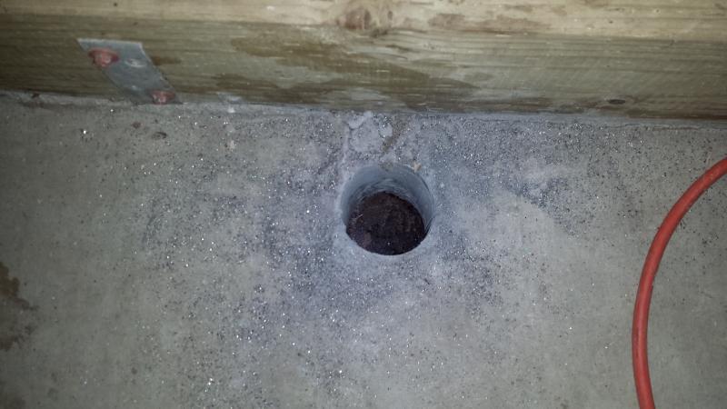

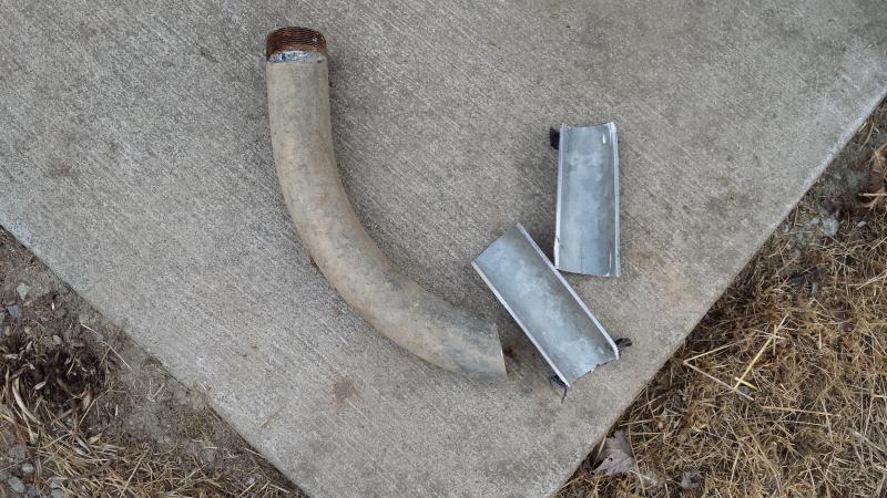

So when they poured the slab they also set a 2" steel elbo in it for power. Well I didn't like going from pvc to steel and I would have to use reducers to go from 1.5" pvc to the steel so I decided to cut it out. Felt good to kill some steel with the sawzall--all its seen for a while is wood :redneck:.

Going from PVC to Steel is pretty common, we do it all the day, but for what your doing PVC from start to finish will be just fine.

Ya talking with a few folks that seems to be pretty common. But it was turned wrong and I would have needed another 90 degree elbo in the dirt.

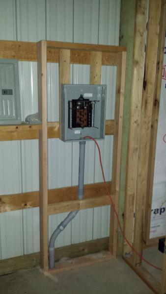

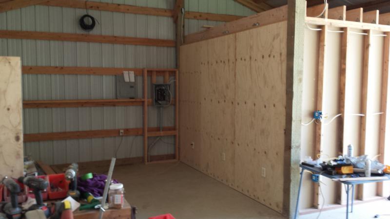

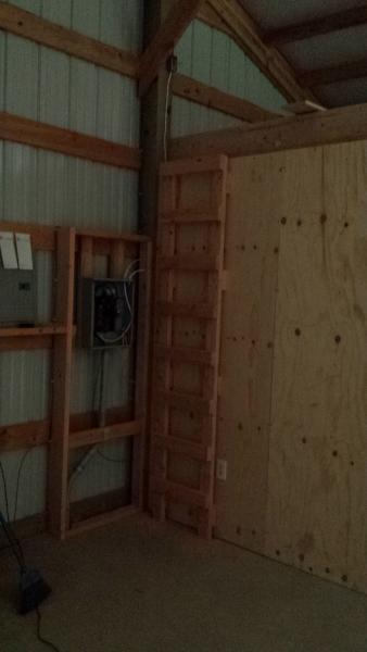

I got the panel mounted tonight and conduit ran outside.. Starting to take some form...
I am going with #3 copper for the conductors and I am thinking #8 alum for the ground since IMO its not going to matter what material is used. I also have a ground bar sitting there so thats all good....
Again thanks for the info :awesomework:
I am thinking you know what is right and what is cheaper. There are wire specs out there for what you are doing. It is your life at stake here and you family and friends. Electrical shocks and fires suck.
You are worrying about all of this over a $100.
Do what is best, then you can push the limits and not worry.
Linky http://www.necconnect.org/
They should all be the same material. If you use Copper for the phase conductors, it should be Copper for the ground as well. Can't remember if that is code or convention, but its what we always do. The price difference on the small wire is nominal compared to the bigger wire.

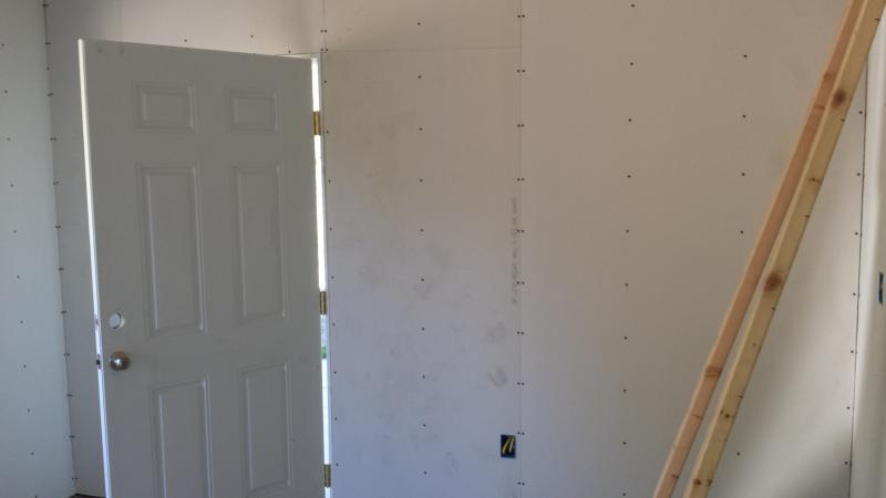

Got me some more goodies.. When I did the barn I found 3 rolls of insulation(they were 23" wide).

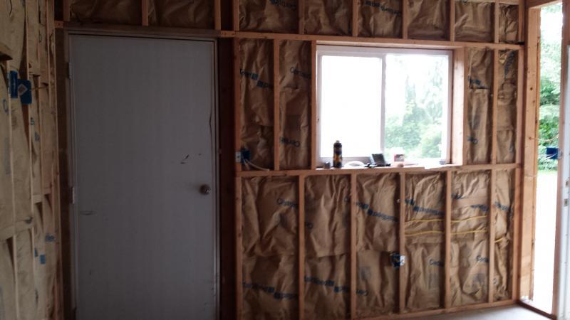

And I got 2 of the 4 walls insulated. The other 2 walls will get done once the sheetrock is on.
