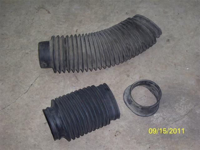

Spent time at the wrecking yard yesterday and didn't find any suitable snorkel material. This pic is from Joops YJ, and if anyone knows the year/make/model of a similar factory settup, or, a cheap aftermarket alternative, please post up a link or idea. My rig is V8 chevy 350 with TBI.

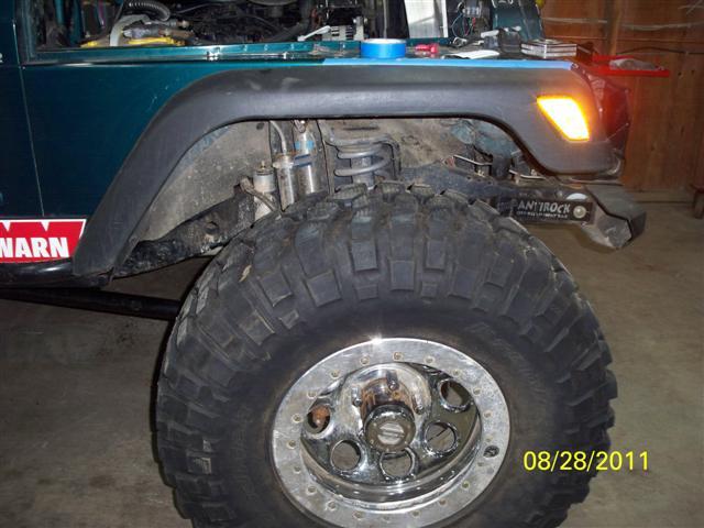

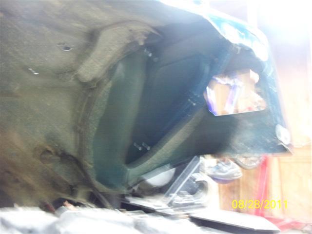

For now, I thought long and hard about going to a "high hood" front fender design, and I may still have to do that. But for now, I'm going to see if I can stuff big tires under my existing front fenders. Measured height to the fender flairs is about 6 inches. But if I remove the flairs, I get almost 9 inches of space. Now I'll lose 2.5 of those available inches by going from a 37 to a 42 inch tire. So, by pictures, I'll have about 6.5 inches of uptravel before hitting fender. Since both the shocks and bumpstops are both set at 4 inches of uptravel (nitrogen bumps), that gives me an additional 2.5 inches for twisting of the axle due to articulation. Really don't know if that's enough, kinda doubt it, but I'll really need to get the tires and then twist up the suspension to find out.
In the mean time, I tried to see how much room I could gain, by some minor interior fender trimming.
In case I messed up, I thankfully have a spare set of matching fenders (even painted correct)
Before pic:
Trimming the fender pic:

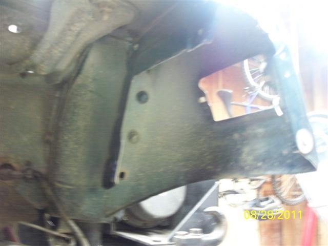

I also cut out the inner fender brace, with before and after pics, along with one with the original flair back on it, although it is just resting there.

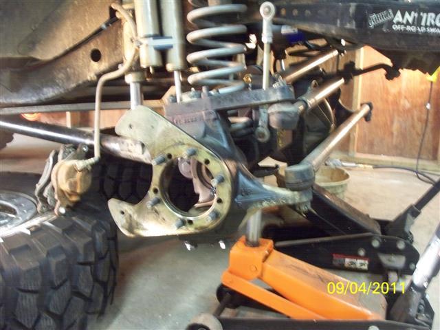

Got some BLING'n great parts from Bob Long, his 300M U-joints for the dana 60.
If all goes well, this cures my only weak link in the front end (Well, the weakest link), which is the Spicer U-joints. I'm hopeful that the chromoly 35 spline, 1.5" shafts will hold up to 42s.
Anyhow, since most readers like pics, here's some for you.
And a HUGE, very THANK YOU to Bob, for his generosity and help, and also for some really strong joints.

Okay. So I've been working towards a snorkel, knowing that the entire hood will probably be submerged at some time. My first thoughts were to take the factory (OEM) air cleaner, with it's oval intake, and adapt it to a round intake and use hose which would be routed thru a hole cut in the hood. So I wrecking yard shopped a few hoses to see what that would let me fabricate. Then, I used some flexible aluminum to see where that would take me. Needless to say, they didn't work.

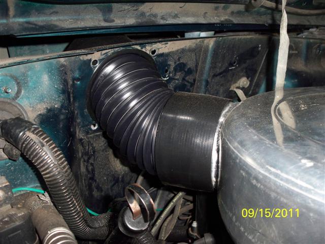

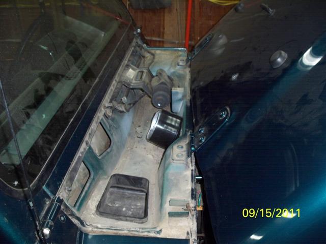

Then I figured out a way to use Spectre Performance airbox and adapt it to a cowl induction. By cutting a 4 inch hole thru the cowl, and mounting a race-inspired air cleaner, I could run flex hose easily thru the firewall, and into the 'dead' zone by the wiper motor on a TJ.
The air box is 16 inches around, with a 14 inch reuseable filter inside. To seal the filter inside the air box, and to keep water out, I used self adhesive door edge molding.

Unfortunately, the new air box is a low profile unit, which neccessitated moving the coil, and all the misc. doodads for the fuel injection. Some new brackets were fab'd up, and voila, it fit. Almost. Damn. Turns out, it was still hitting the distributor/plug wires.
So off to get cut and welded. Thanks again Pat!
After all was welded, everything fit. Almost. Damn.
With the low profile, the angle was too sharp for the hose bends, and the flex hose wouldn't attach properly. So I bought a spacer, and raised the air box up 1 inch, and now everything fits as designed.
But with the spacer, I wouldn't have needed to cut and weld the box to begin with. Oh well. Live and learn.

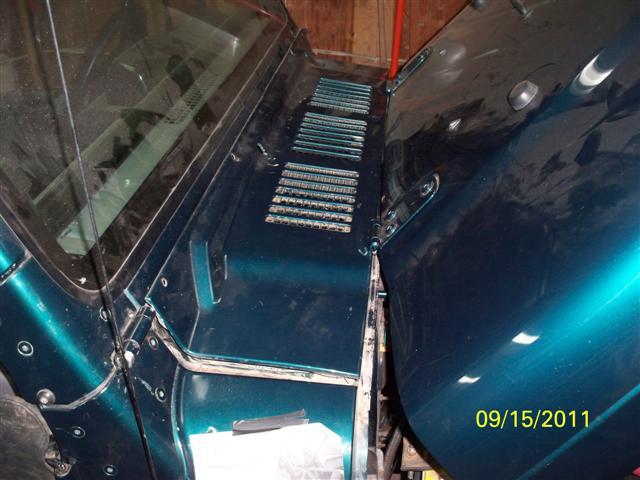

Also, with the air box sucking from behind the cowl, I though it prudent to increase air flow to the cowl, so I drilled out a section of the vents (which are not open) of the TJ cowl.
The first pic shows the cut and weld section, albiet with a lot of glare which makes it hard to see.
The second pic shows how the air cleaner is sealed from underside. \
Pics 3 and 4 are of the holes drilled. The 'blank' area is where the air duct enters underneath, so that debris and water won't directly enter the intake.
