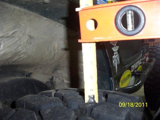

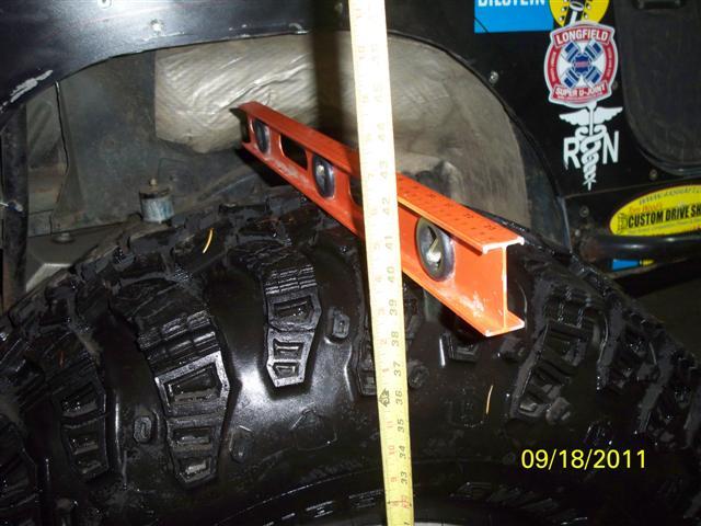

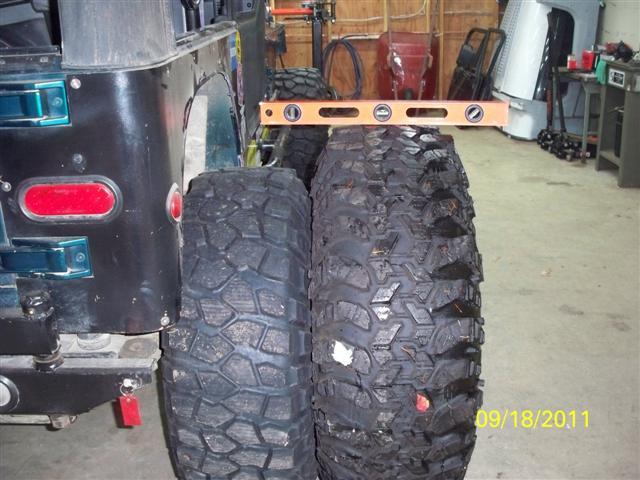

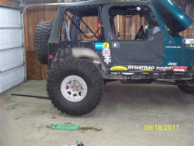

So I'm waiting for the rest of the snorkel elbow & tubing to arrive via UPS, and a few other misc doodads. I borrowed another 42 inch tire. This is a 14-42-17 Irok Bias. Mounted on a 17 inch 5 on 5.5 wheel. Should be a direct bolt on. Woohoo.
As you can see by the pics, it's larger.
The BFG Krawler KMs are 37s. New, they measure exactly 37 inch tall. When mounted on wheels, and with the weight of the vehicle on them, they sit about 36.5 tall. With wear, these are 36.0 tall
The IROKs are 41.5 tall, per Interco's website. These have a very small amount of wear, and measure out at about 40.25 or so tall.
They're about 4 inches taller than the current tires.

So I installed them on the front first. DAMN!.... The center hole of the aluminum wheels measure juuuuussst under 4.25 inches.
My wheel hubs are dana 60s, and the wheels juuuuusst won't fit.
Tried to sand down any imperfections on the wheel hubs, and did a very gentle sand to the aluminum wheels (remember, they aren't mine) just to make sure it wasn't something stoopid. Nope they still won't fit.
So mounted them on the rear next.

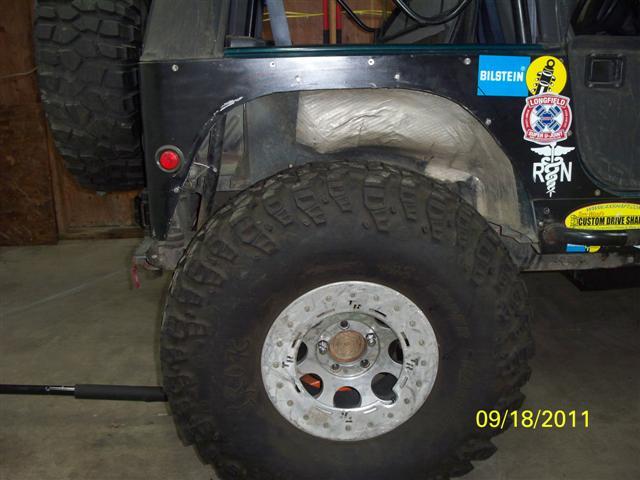

The tires look fine. But they do hit drastically on the springs. These are about 4.875 backspacing. My current wheels are 3.5 backspacing. Both wheels are 9 inch wheels, converted to beadlocks. So about 9.5 wide now. With the 12.5 wide Krawlers, everything clears. But with the 14.0 wide Iroks, with the additional 1.5 (approx) backspacing, then it all rubs.
But it still LOOKS like, the tires themself will work. I'll probably still have to do some very minor rear fender trimming.

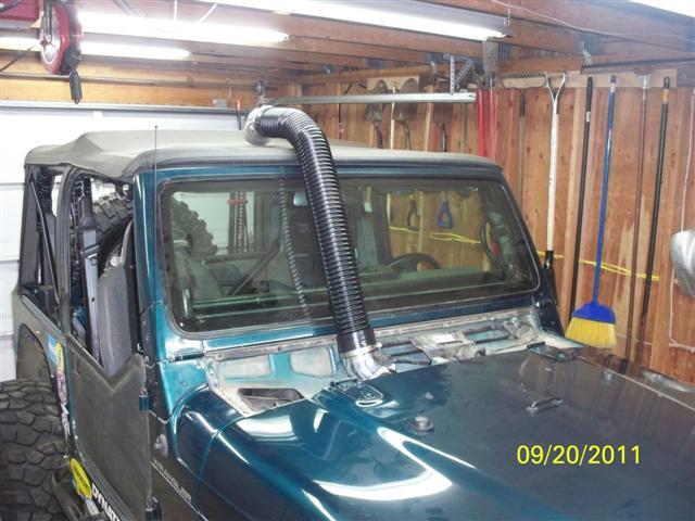

Here's what the snorkel will look like when finished, obviously, I won't have the top or windshield on while at TTC, so the snorkel will be secured thru the windshield's location, to the upper roll bars (probably with 100mph tape)

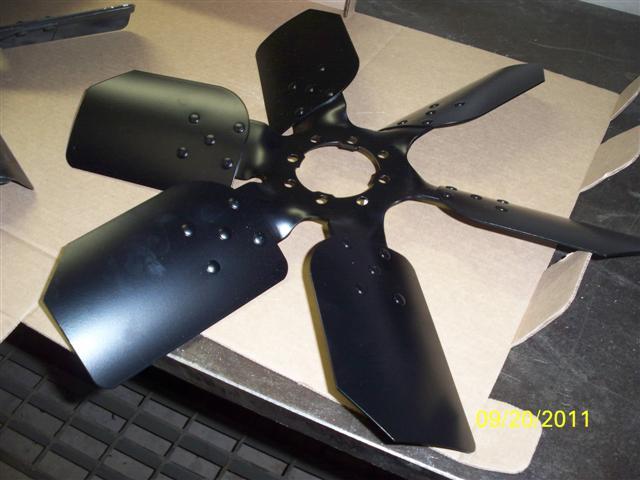

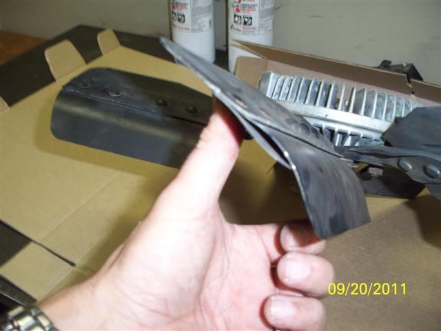

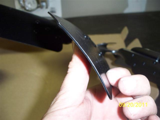

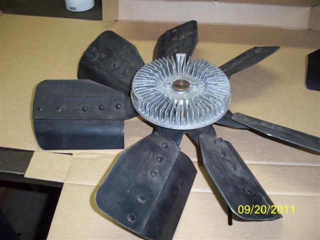

So I swapped fans tonight. The original build, had an OEM HD cooling fan, about 19.5 inch diameter, 7 blades, with a modified flex/solid blade. Kinda odd, if you ask me. The shroud is built to fit a 20 inch blade'd fan, but I chose to replace it with a 19 inch fan, in order to have a little extra room, when it submerges. My fear, is that the 'flex' of the OEM fan could bend, and tear up the radiator. Yes, it's a clutched fan. And the clutch should be able to take a great deal of the 'shock' of water. But I remember a couple of rigs of TTC (in 94) that destroyed radiators, so I'm not taking any chances
