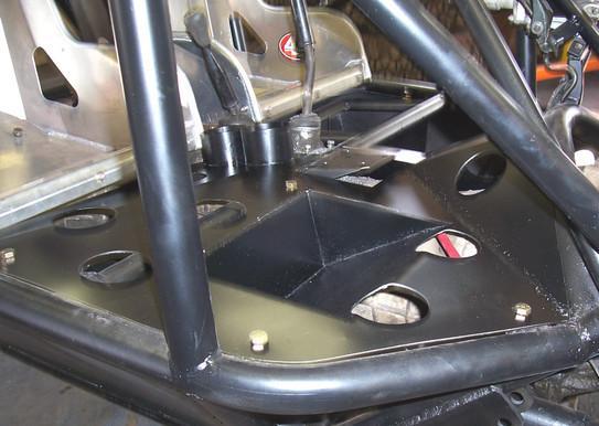

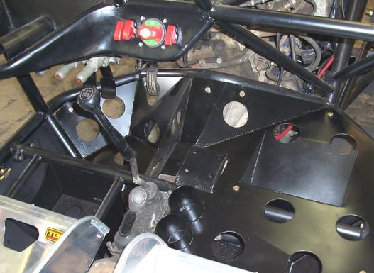

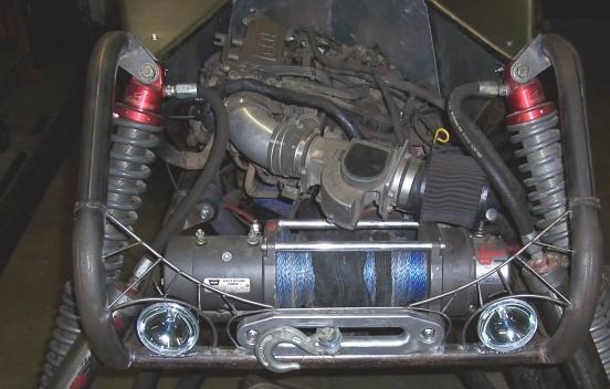

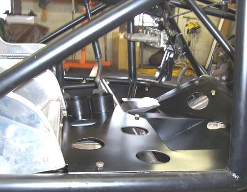

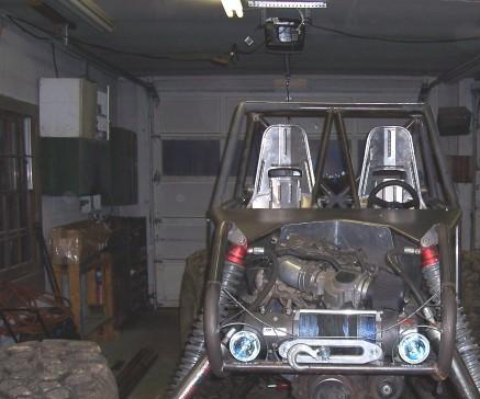

Interior and front end pics from the original build-up thread.

Few more intimate details about the build:
Toyota drivelines front and rear. D60’s will have a mounting flange out of the pinion.
The front and rear winches connected to the axles will be double lined for more compression force and to slow down the “sensitivity†of the pull.
Full body panels with Zeus fasteners. Panels will be Lexan and either clear and/or “smoked†grey. As well as a covering for the engine bay area, probably a flexible plastic of some sort.
I’m hoping to get 40 degrees of turning out of the Bobby Long CV joints, 45 degrees is possible. The limiting factor is the links and the backspacing of the wheels is pretty deep at 5â€.
The rear steer joy-stick will be mounted between my legs where the battery used to be. And I’d like to mount up some kind of cable to the rear axle and a gauge in-cab of some sort to help me designate how far the tires are turned, also to easily find center.
We’re on month 3 for the build and looks like things should start picking up here soon. Just in time for the snow. I’ll be making my own decision if the red label Krawlers SUCK in the snow or not. :;
