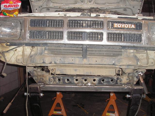

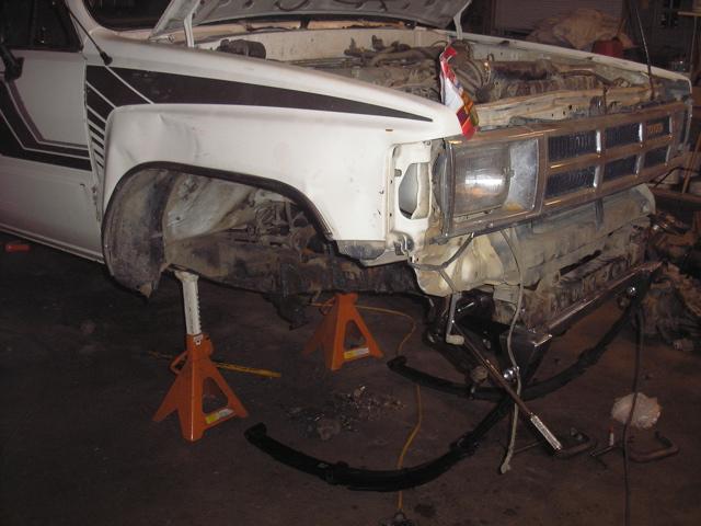

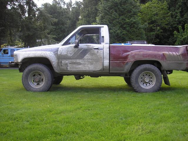

some pics of my very slowwww progress... after the last wheeling trip i took it out on... then after the ifs was stripped. wooooohoo

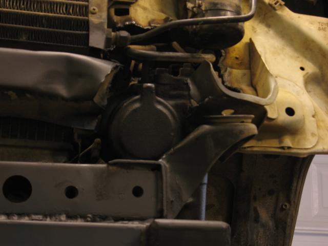

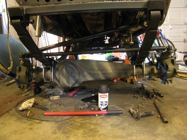

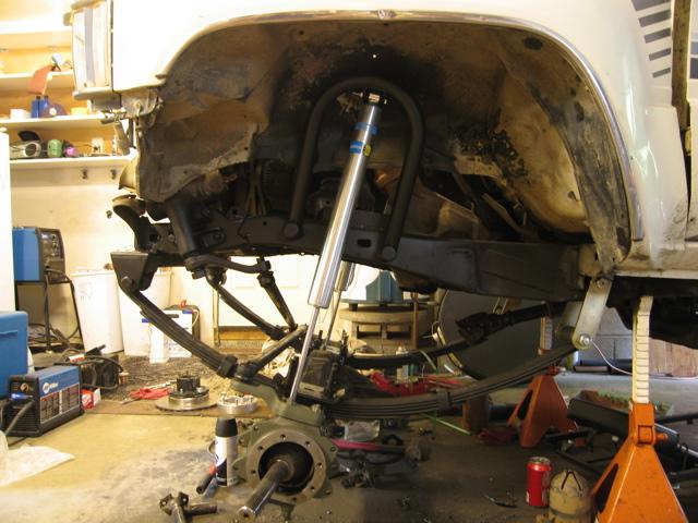

I had to cut the **** out of the front core support and body mount to get the box far enough forward. the front hanger is 1/2", the springs are 1.5" from stock, and I redrilled the perches 1.375" back, which is a combined total of +3.375" from stock. it would have been easier if I had a flat pitman arm, then i wouldn't have had to rotate the box forward so much. also, this cab was in a head on collision apparently. the driver side of the core support is all fawked. it's been that way since I purchased this cab at the yard. so having the front end smashed back a bit, and the box far forward really didn't make this a fun job.

took it for a spin today once i wrapped up the front end. drove like ****. the rig started right up without even charging or jumping the battery after 10 months of sitting. so much for optima red tops being ****ty.:eeek: now it's time to install the cases and do the rear. i gotta lotta cutting to do today. lotta work!! woo.
