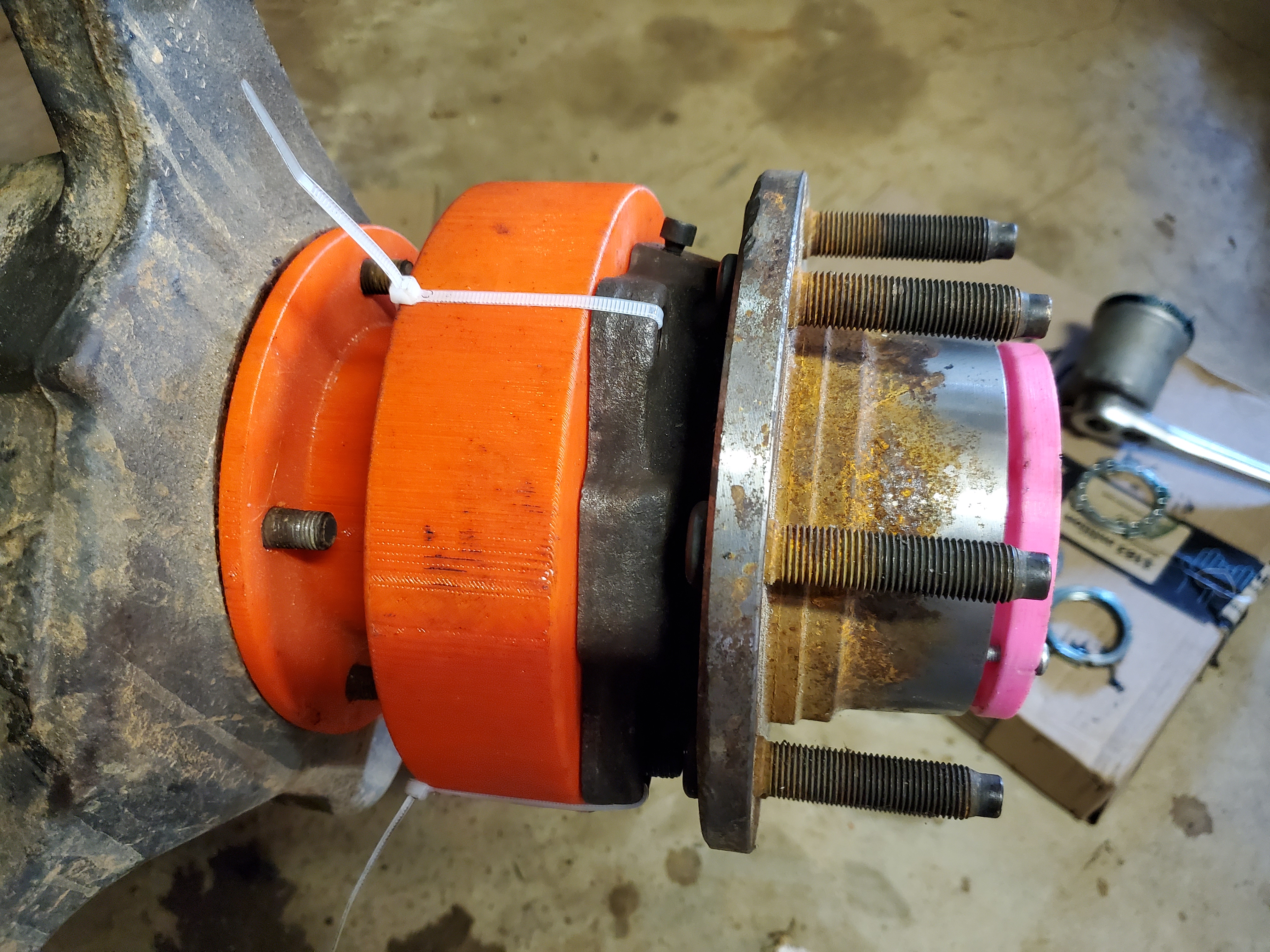

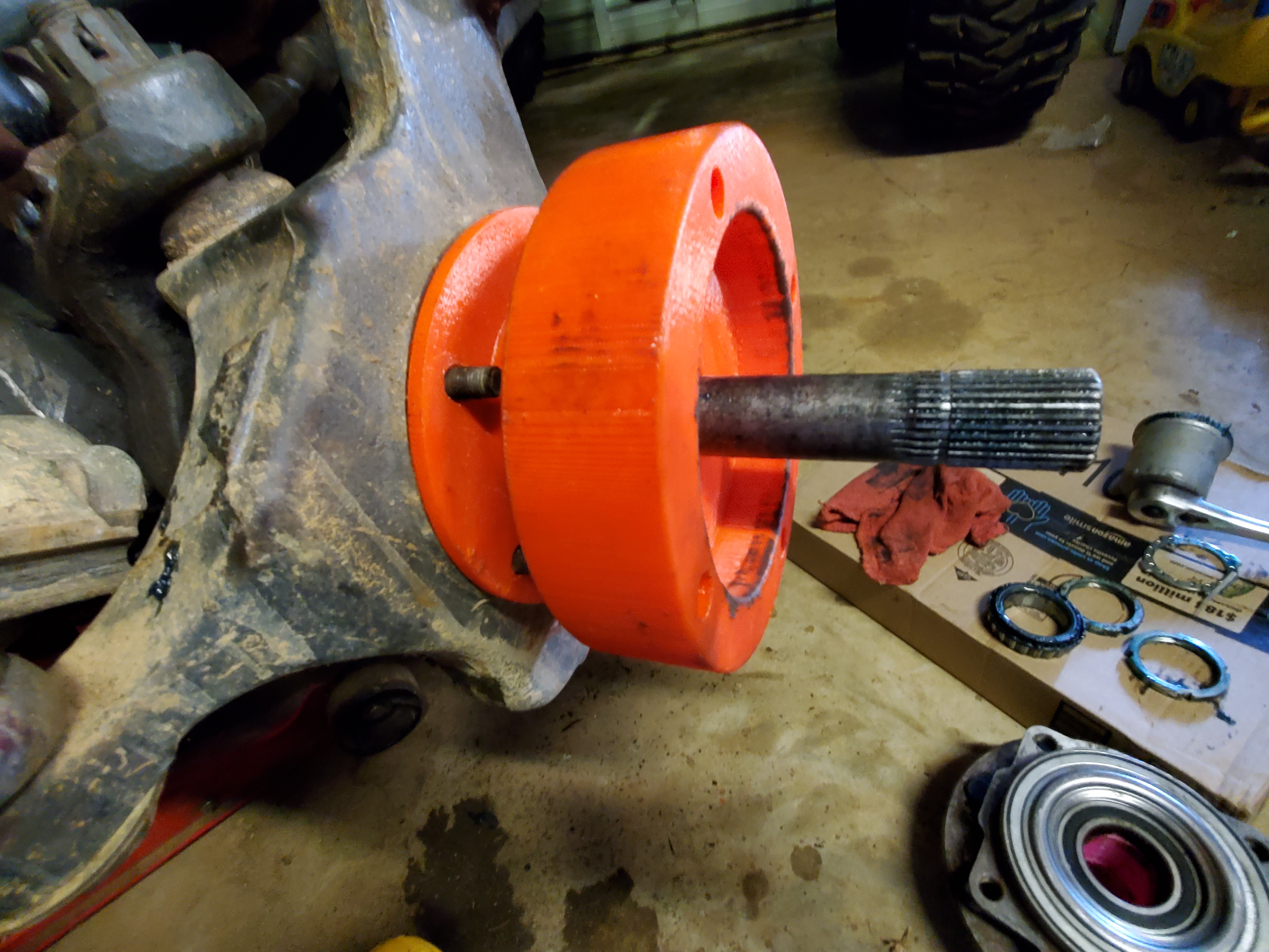

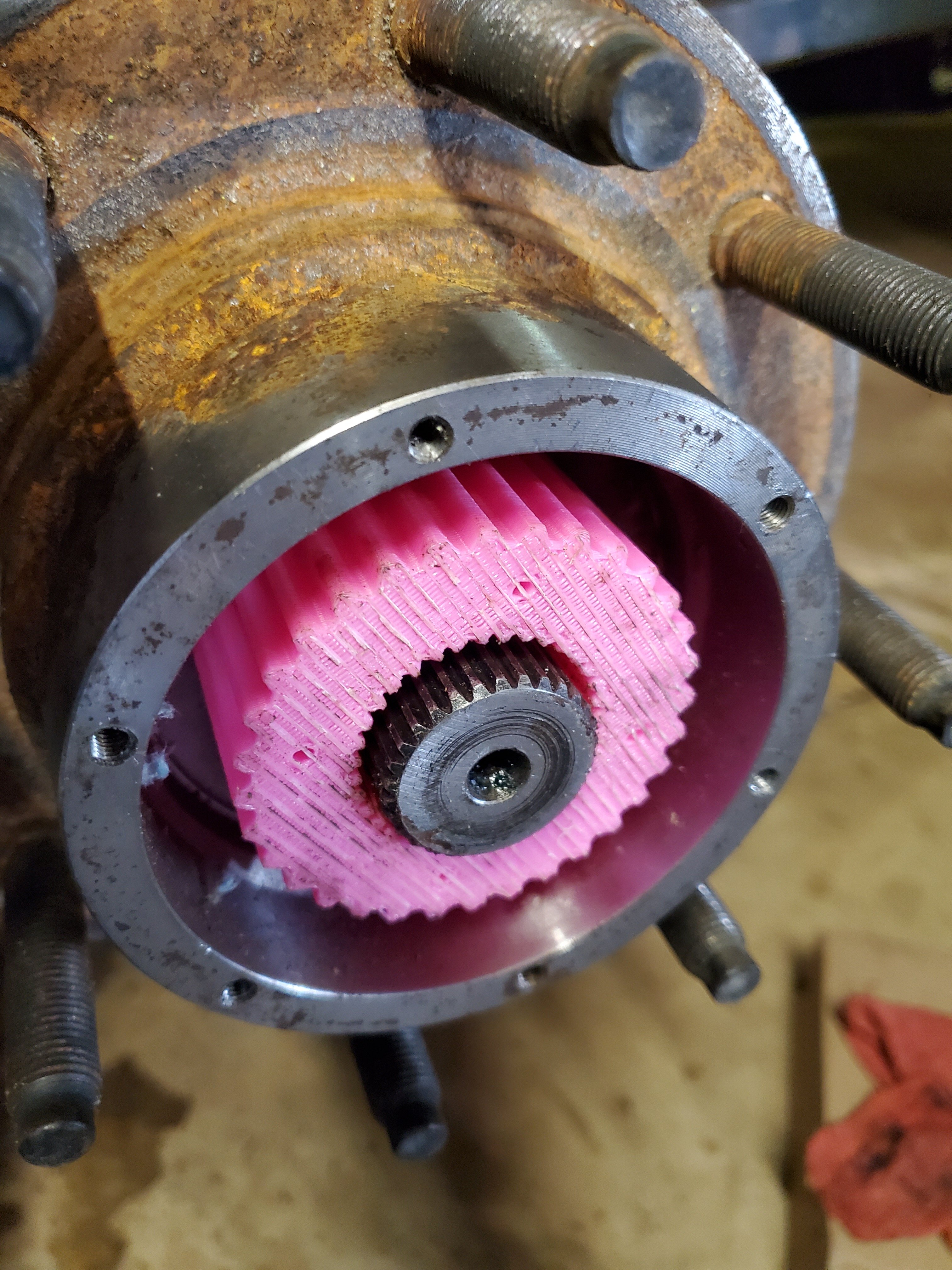

Was doing some maintenance to the rig and decided to test fit the pieces, since I had it apart.
I didnt have the correct bolts/studs so ignore that part, but the dimensions seem to match up well. The slug and cap still need work to finish them out, but honestly that is the part most places would already know.
Would still need to figure out the brakes, but there should be plenty of room to adapt a bracket to work.

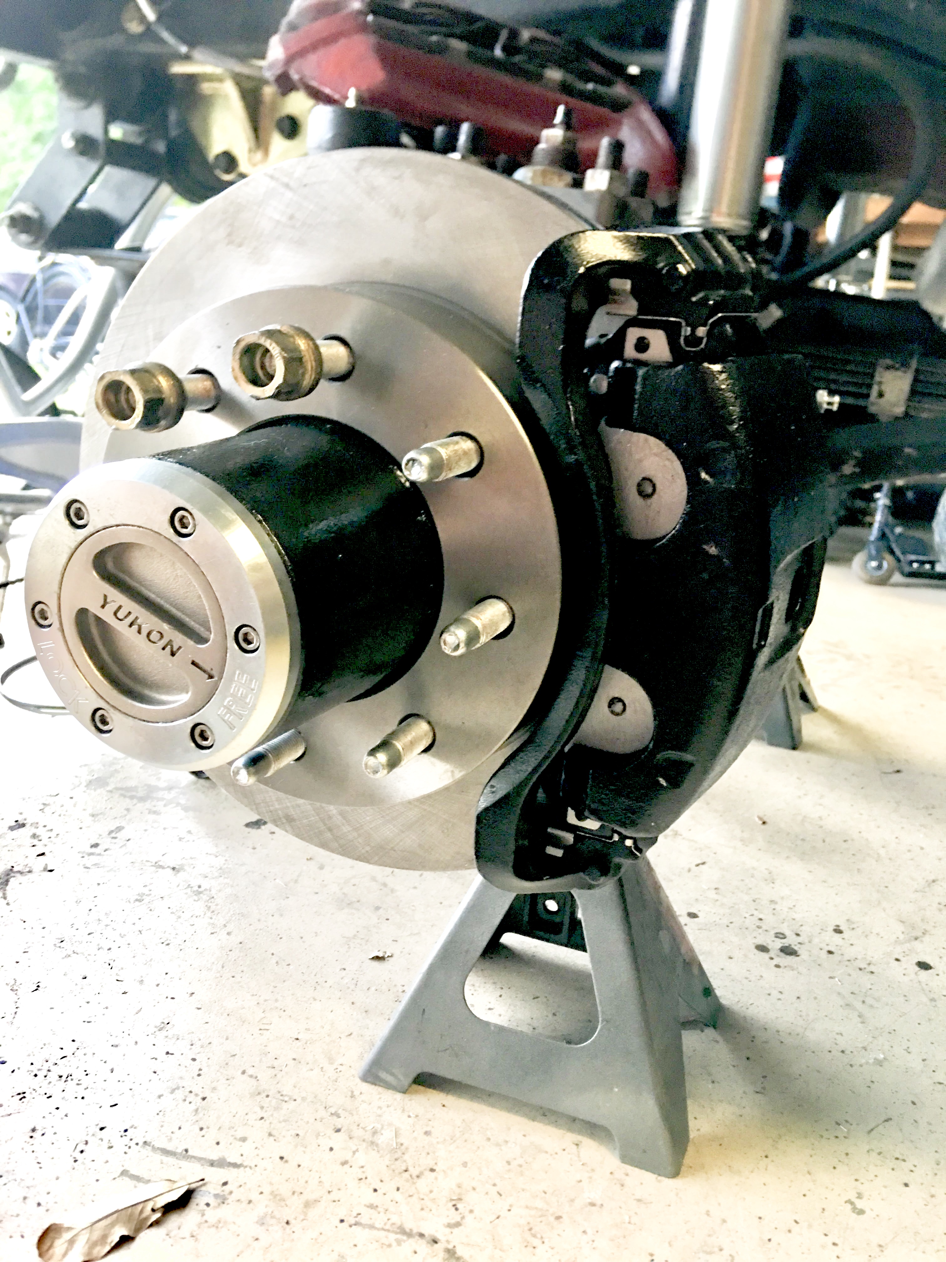

Can you make the stand off 1/2" less so you can put a caliper bracket behind the adapter like this? This is the one I made for 2500HD rotors and calipers.

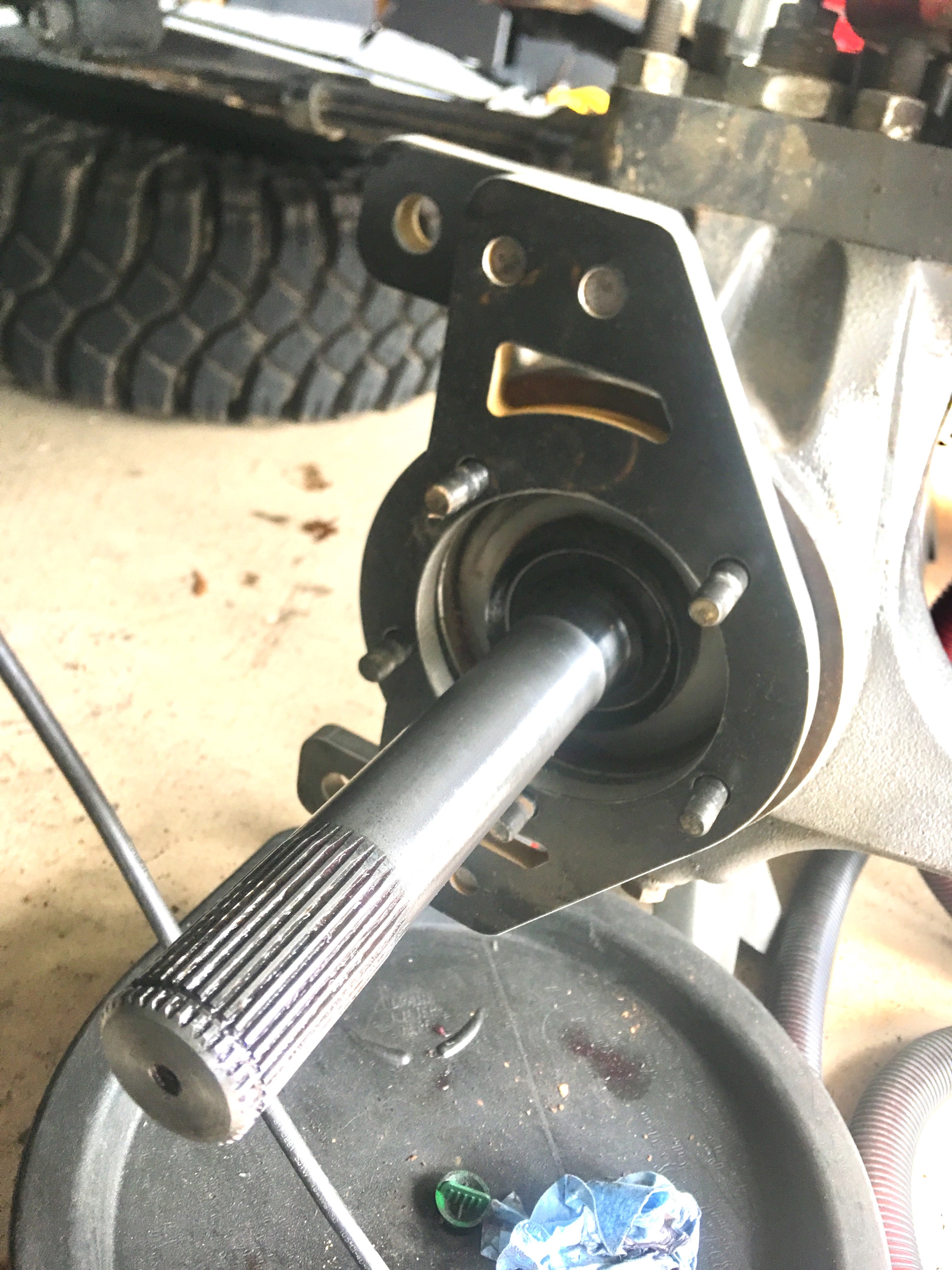

One thing I should note. My axle is a balljoint 60, which has the integrated caliper mount. The face on the knuckle is compensated for this extra thickness. If you used it on a kingpin axle, the Ford caliper mount should still go behind the "spindle" like in the stock configuration, or atleast a spacer would. The chevy caliper mount goes in front of the standard spindle, IIRC, so it wouldnt be needed, or would need to be modified to be used.
The WMS on this setup is farther out though, so not sure if any of the normal caliper mounts will work, without a deep rotor.
I just assumed if a person were going this route, which I would imagine would be to run 40 spline stub shafts.....then I would also assume you'd build caliper brackets off of the unit bearing adapter to fit whatever rotor you chose (probably a light weight "racing" style hat+rotor)

The adapter I built was manly so you could reuse a standard length stub. The 05+ UB wont bolt to the knuckle, and it has a much larger bore and pattern on the back. It might be possible to machine the knuckle to accept the larger UB, but not sure what that would change, as far as strength. The 05+ UB is also very shallow. If you bolted it directly, you would likely have to run some very custom brake setup. The SD knuckles are cast with the deeper mounting area, to offset the UB and create space for the brakes.
