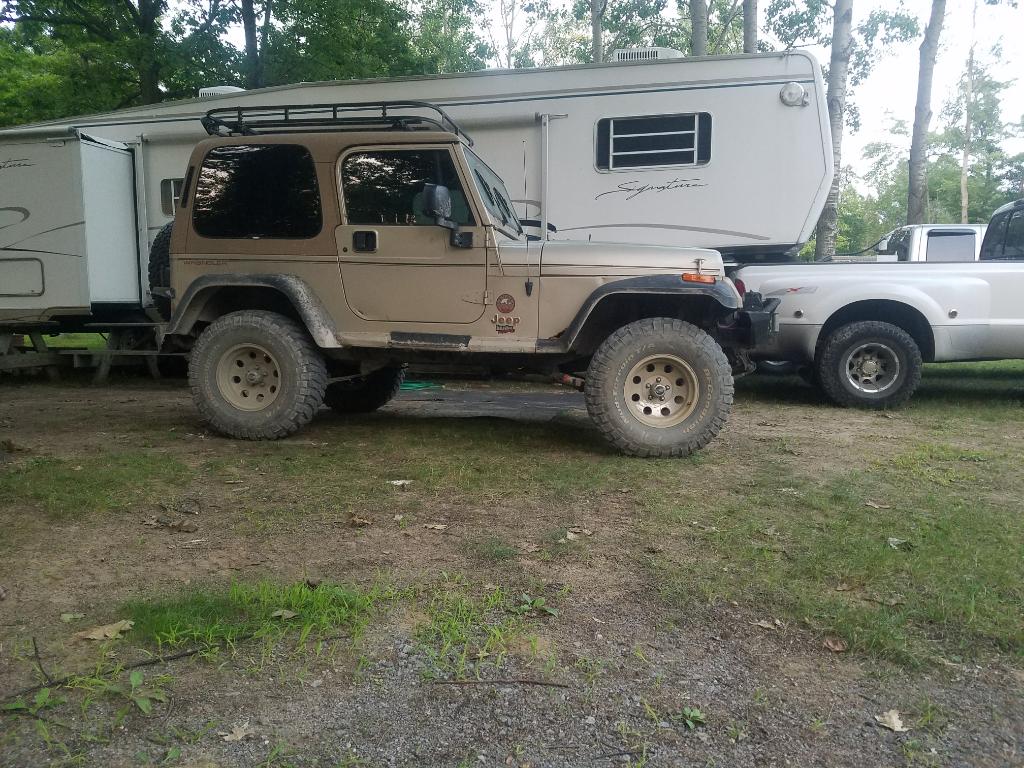

Btw here's my 95 w 33 10.50's 4.10's and 4.5" rubicon express extreme duty springs.
