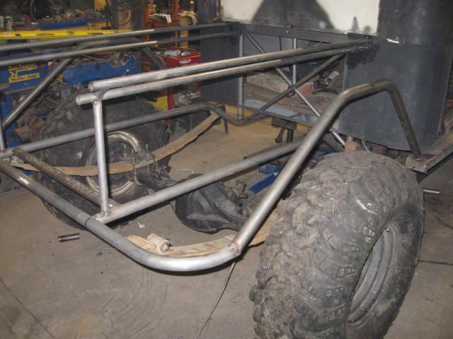

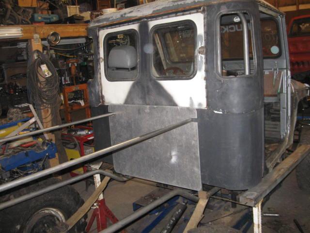

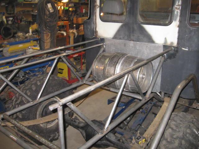

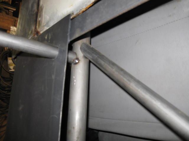

Got a couple bed tubes in place. I used a holesaw in the back wall of the cab so I could push the tube through it and reach the cage tubing.

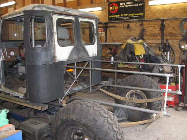

Made a panel for the back of the cab out of recycled aluminum sheet. Shizzy is historical.

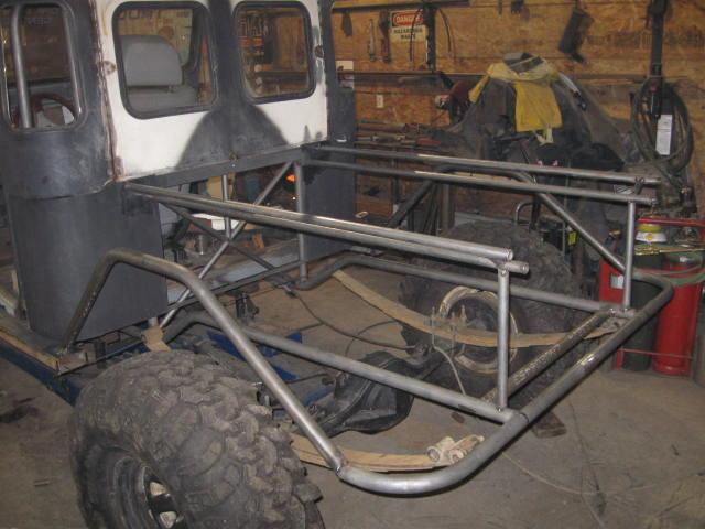

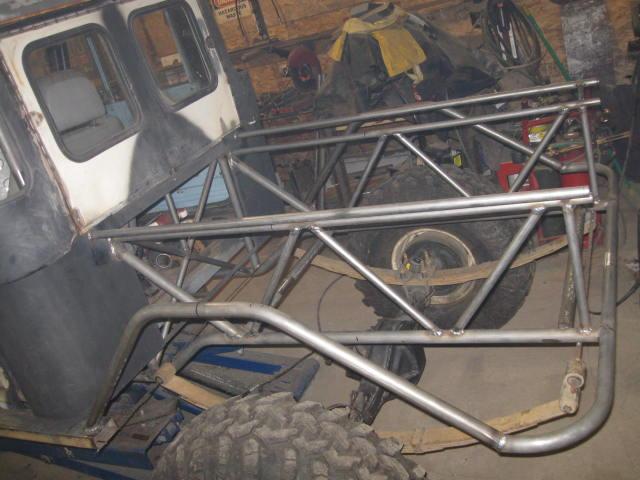

Got some more done on the bed today. Hope to get it all filled in with bracing tomorrow. Would also like to start getting alum panels on and springs hung too.
This thing's turnin' out pretty sweet---definitely one of a kind....:awesomework:
Not too sure about the flow of the fender hoops to the rear hoop, but hey, I'm sure you gots a plan...:D
Got a few more tubes in for some bracing. Still need to brace the fender bars and start on paneling and getting the keg ready for fuel. Ill be adding a sump and pickup/fittings on it for fuel.

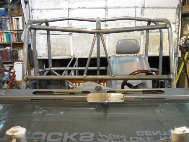

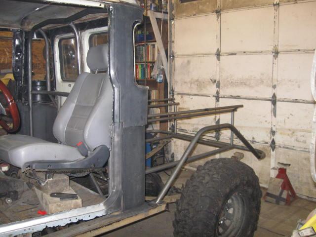

Got the front half of the cage done tonight.
