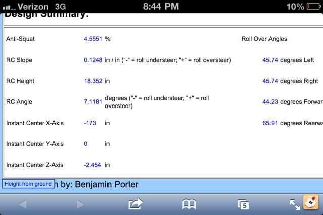

This is my first link build also. I've researched this made my tabs and left some adjustment for the rear uppers on the frame. One set of numbers is max up other is mad down. I split the difference and put it in the middle.
I have forgotten most of info but if anyone sees anything out of whack let me know thanks.

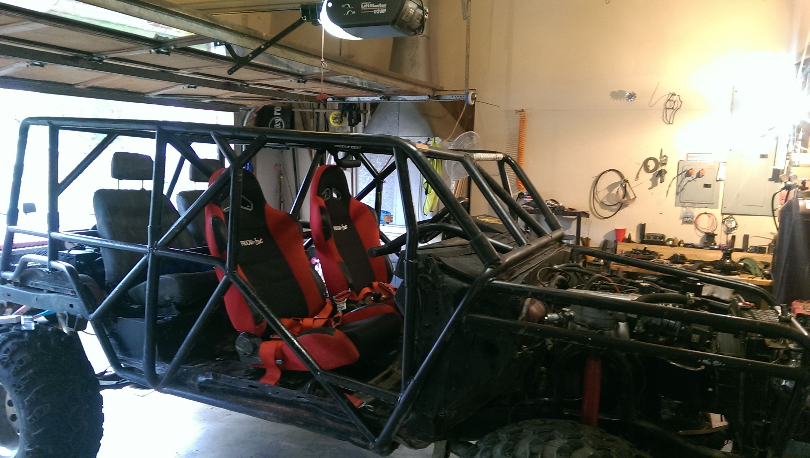

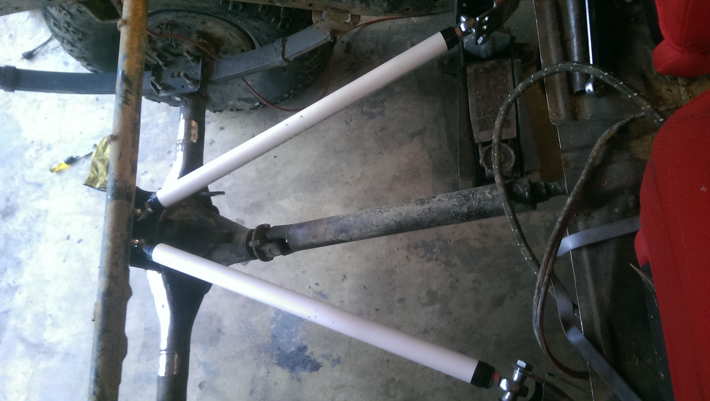

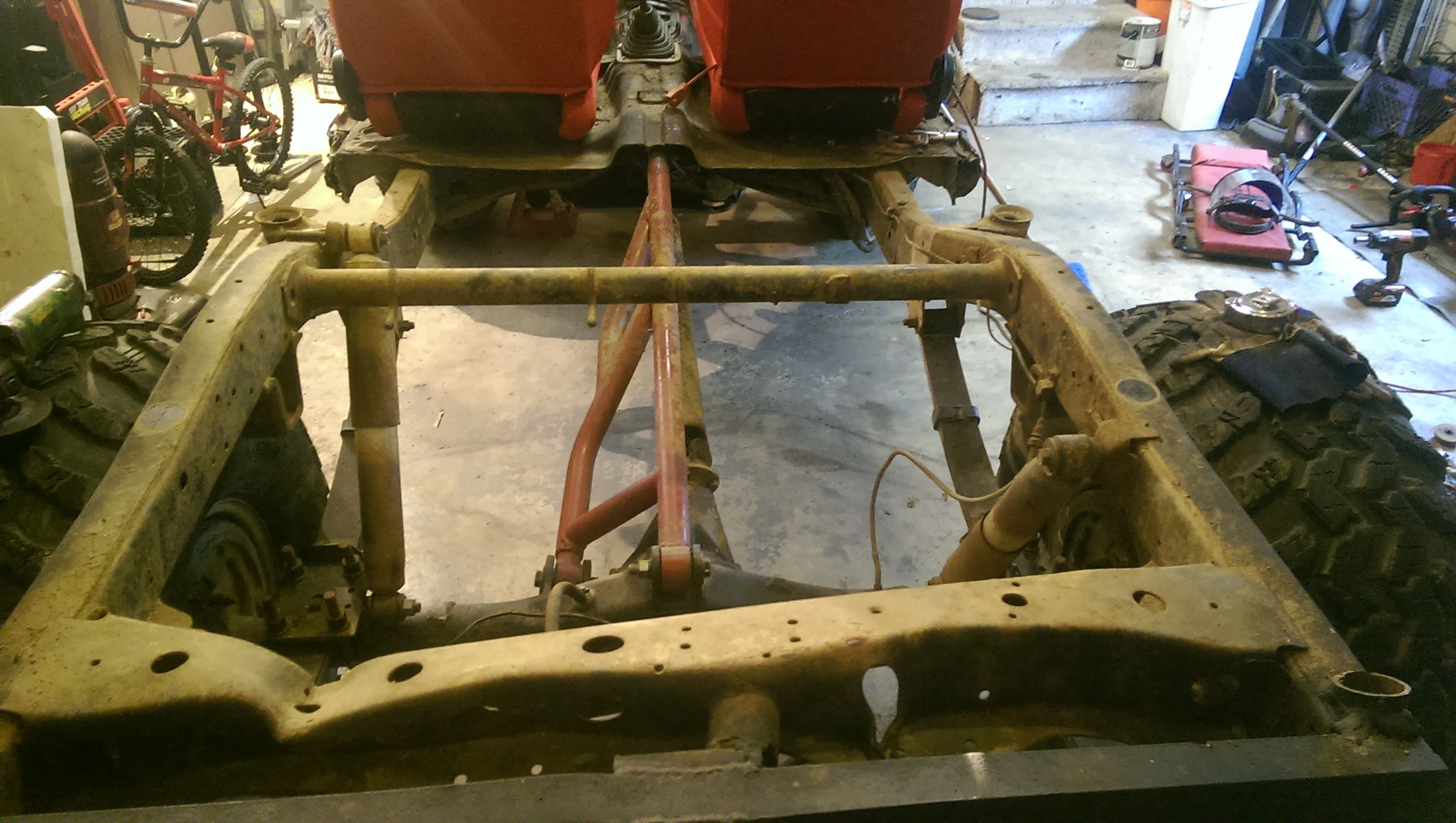

Here ye go I'm gonna do some moc up tomorrow and take pics and measure for calc also redoing cage at the same time just doing links first I'll post parts I got for links tomorrow I'm fixing to go to bed

That's easy straight lowers triangulated uppers I would take the time to notch the frame and put link mount smooth with a bottom of the frame
I bet Trail Gear has a good kit for that
36 to 40 lower
27 to 30 upper
before you tear it apart get measurements so it will go back together straight and square with the front as your setting 4 link need 2 look a setting the pinion height with the drive shaft you plan on running it will point up move than u think
PM me if u need help there's a lot of people with good information willing to help

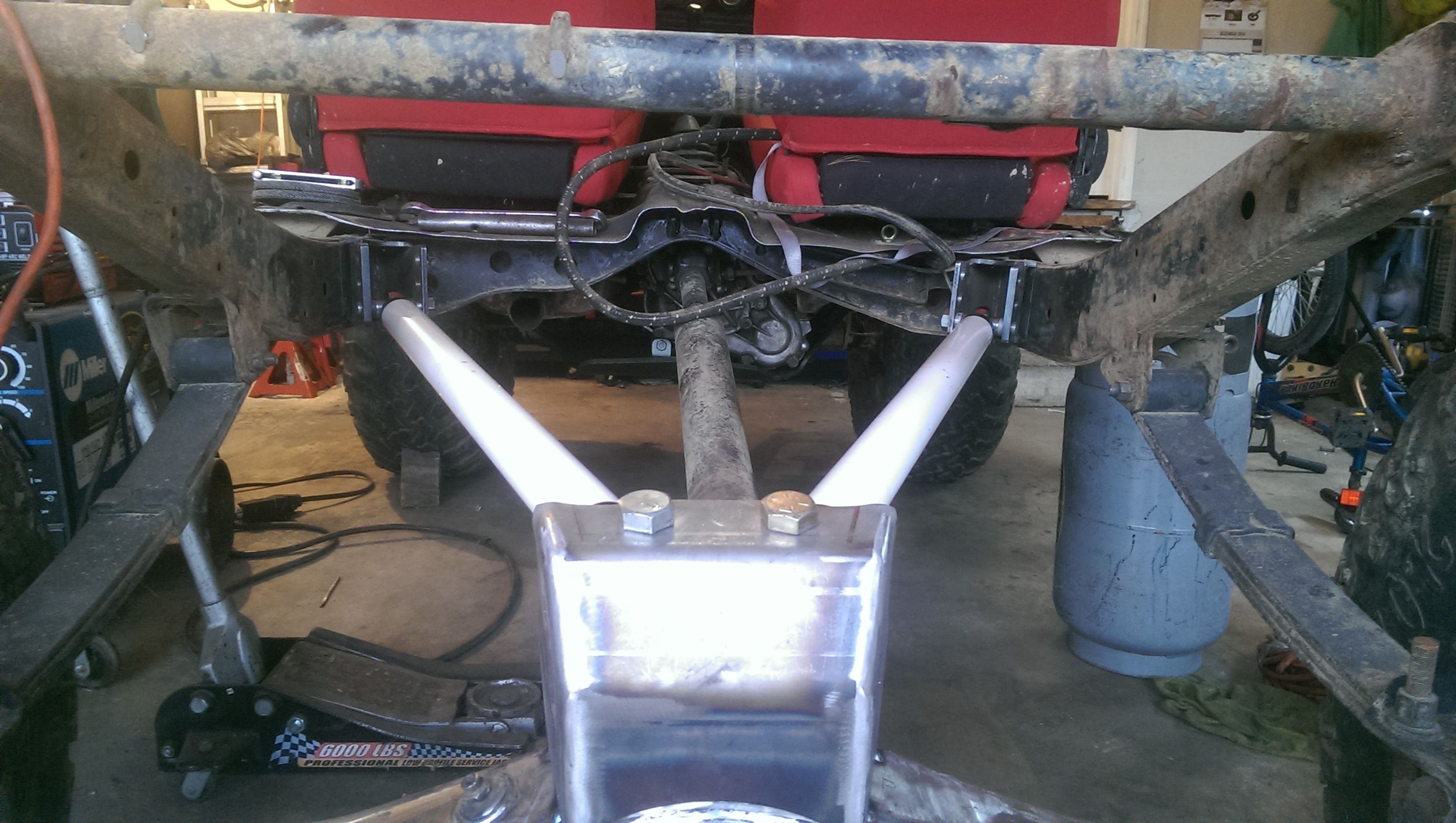

Pic below is one side of a crossmember I made building my buddy's rig. By bringing the lowers in from the frame where I had planned, it made a significant improvement in geometry. Had to go with this ladder design for driveshaft clearance. I just wanted to post a pic because you're not always limited on placement with a little work. Do it once and do it right. Worth a little extra material weight and work for me.
Fyi, if the material around the bolt holes look thin it's 3/8 plate.

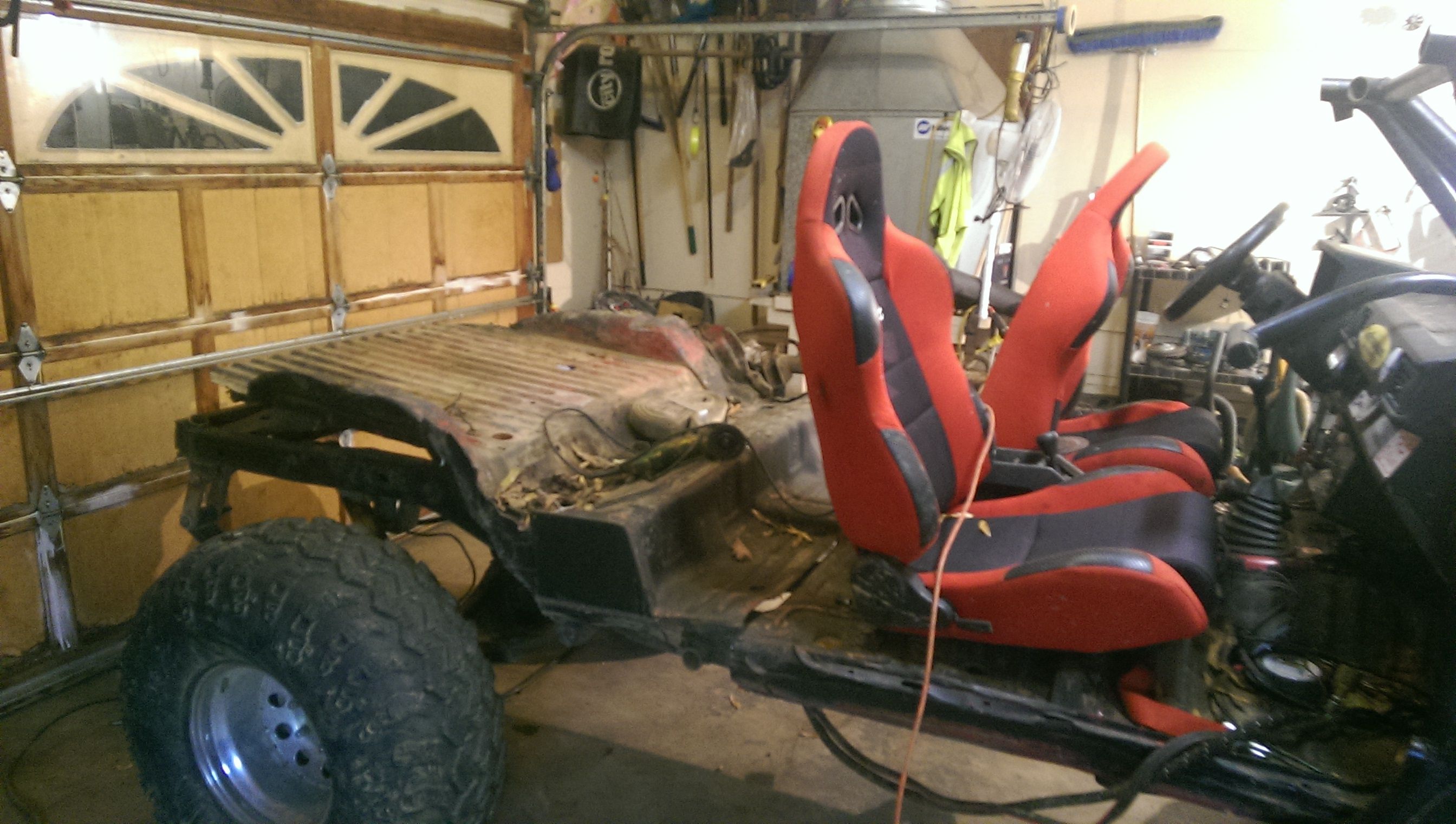

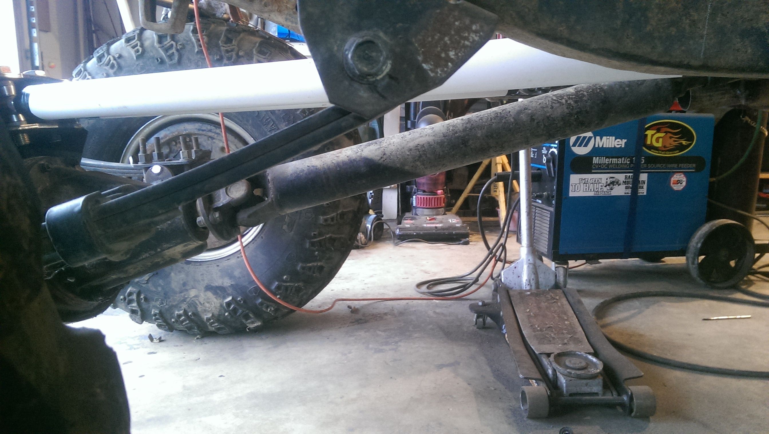

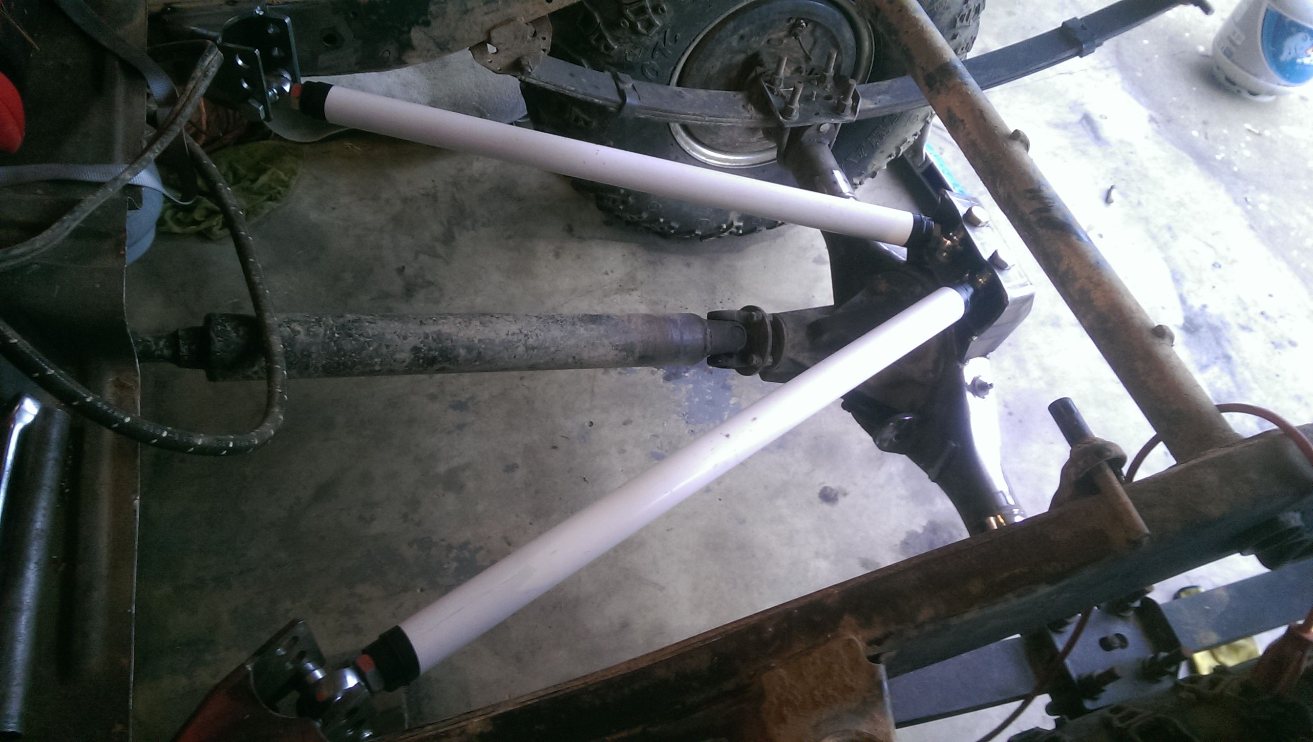

Well I started to day just tacking my uppers in doing lowers tomorrow then entry it in the calculator to see what it says but here is some pics of my progress today sttill planing to do double triangulated

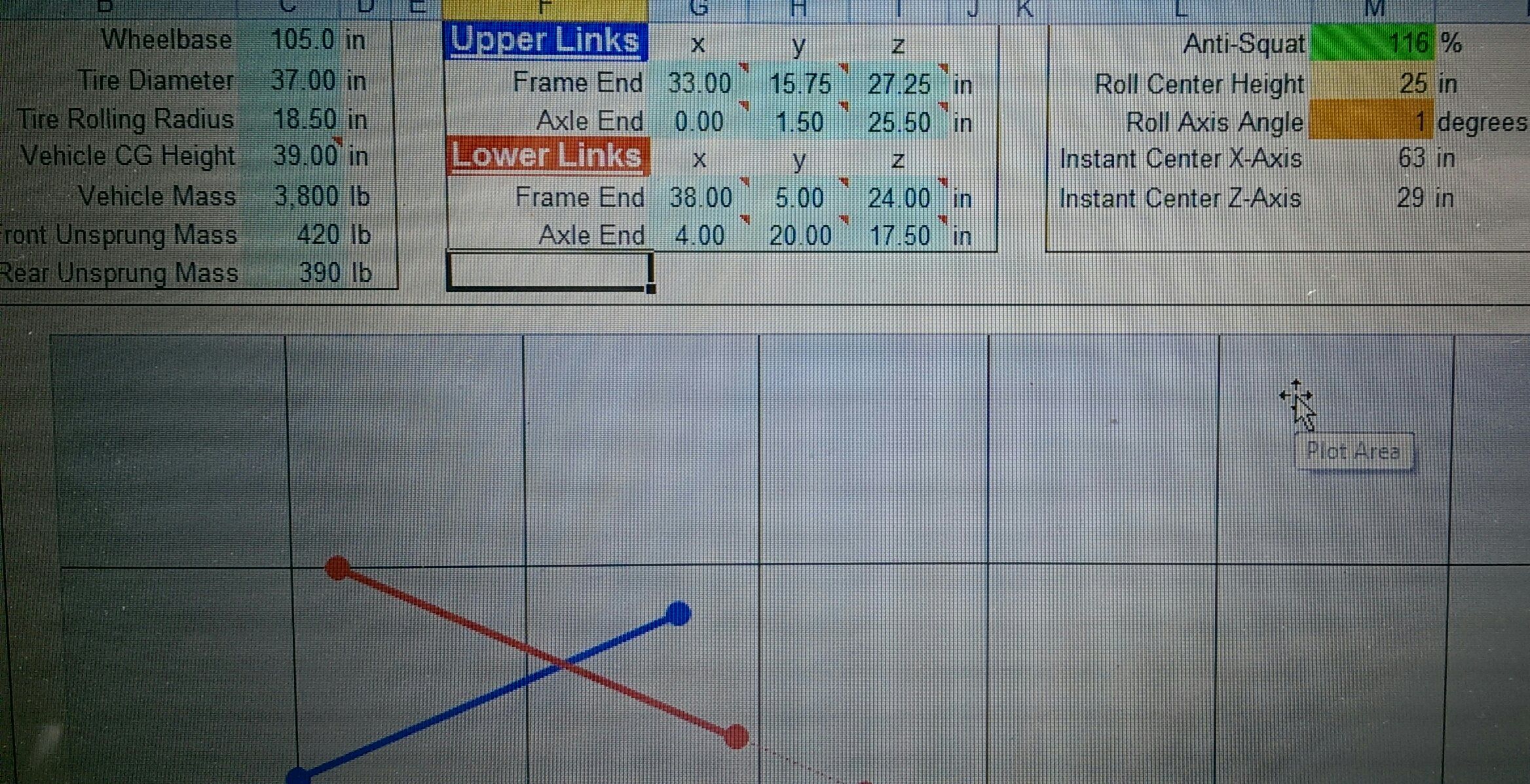

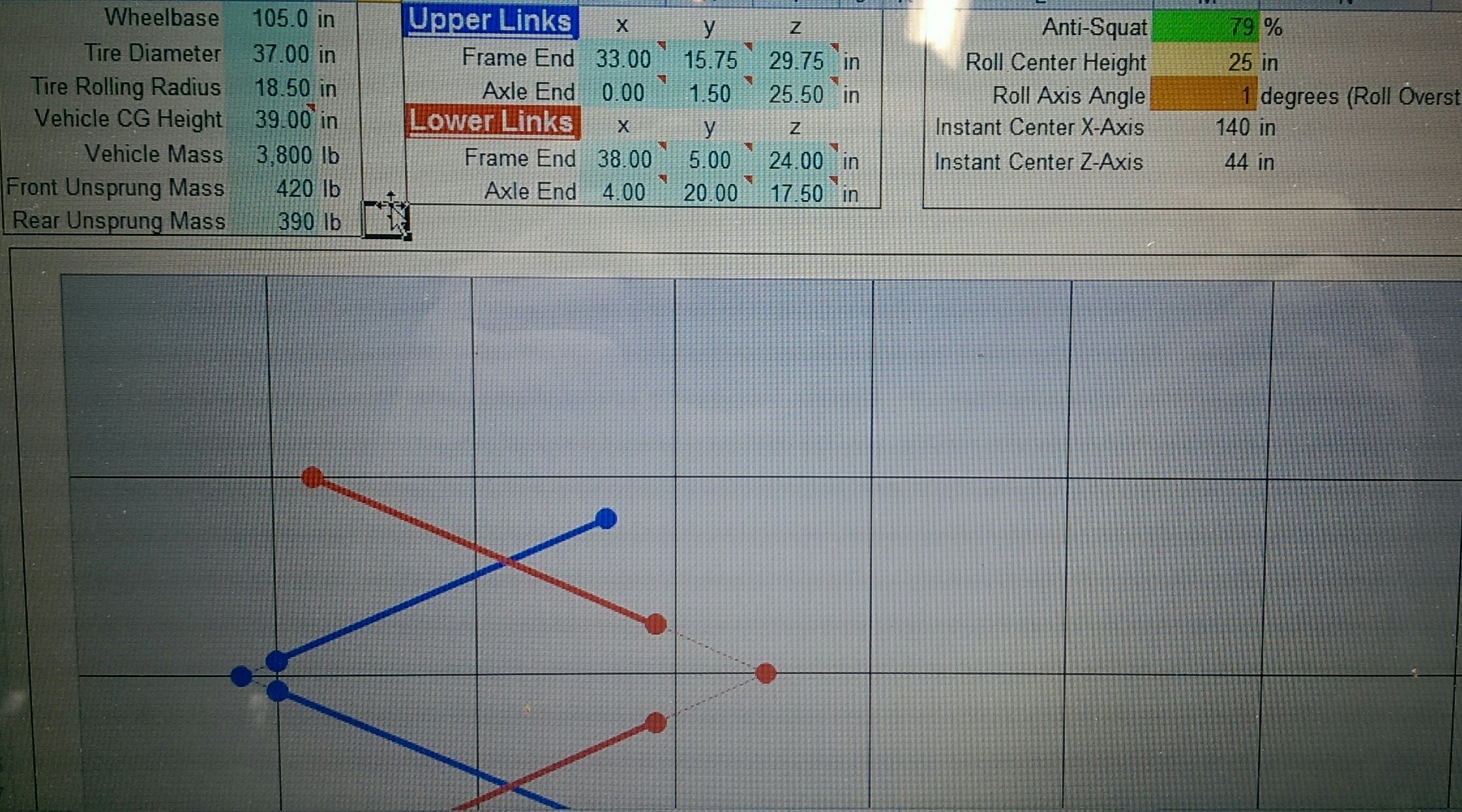

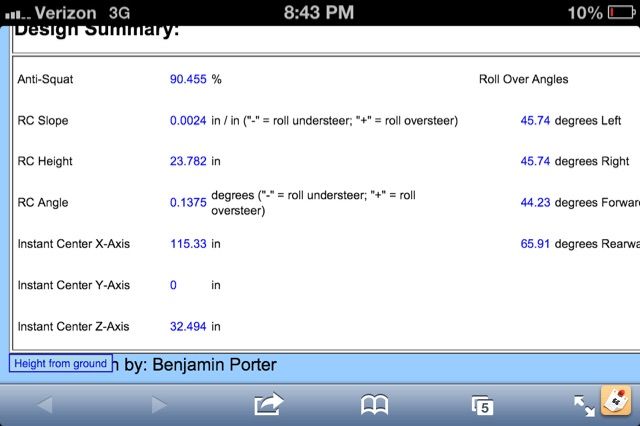

First time using the calculator first pic is uppers all the way down second is uppers all the way up. Don't know if this is good bad ok. What does anybody that understand s this think because it's just numbers to me right now till I learn what they mean . And thanks for input or advice as I greatly appreciate anybody's help thanks in advance fellas
I just went through all this with my 4Link on my truck. Went from not having a clue, A RuffStuff kit (like yours) and a tape measure. You need to get your upper axle mount higher. I used a Sky Manufacturing truss. Also I'd try and get the anti squat numbers in the center hole around 70%, that will give you some play higher and lower. Just watch you roll steer.
