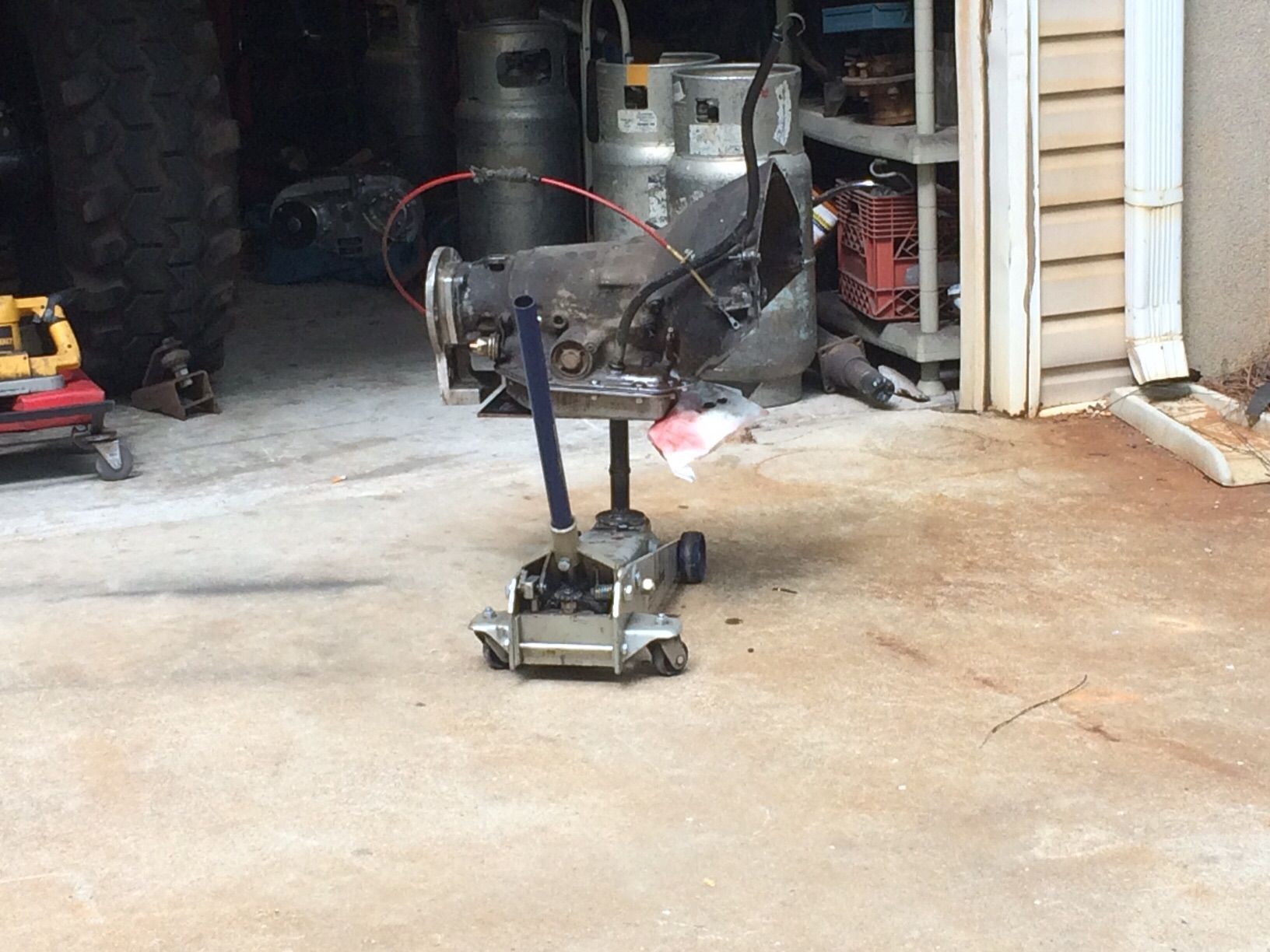

No Kel. But the way u Toss around axles, I sure could use Ya to throw this trans in my truck. I'll be at louis bound in no time!! **** TRANSMISSIONS!! My God what a nightmare. This sucks balls. Big ones. Black ones. (Piper told me about those). Man I don't even know how anyone could do this all the time. Im Thinkin I'm missing some tools to make this easier. Wata cluster fuk!!
Ive pulled quite a few solo, easiest way I found to do it, is drop the tcase(which is a job in its self since its an atlas) find a piece of 3/4 ply wood about the size of the trans pan. Jack up to the bottom of the trans, ratchet strap the **** outta it to the jack with the piece of plywood between the jack and trans pan. You might have to get creative on getting the straps/trans/jack to work together going in and out, i had to tighten the straps as I let it down and let them come loose a click at a time going up.

Hey mark thanks man! I got It with my home made trans jack. Aka "holy **** its wobbling" ha. In truck now. Will be at builders house in mornin. :dblthumb:

Here's that guy. Found another crack where it bolts to the motor also. Kinda around one of the bolt holes. Goin in the mornin. Should be ready by weekend. Tj tripod these nuts.. :JRich:
Mark, 36 and no Fukin way I'm bench pressin that ****. Hell nawww! Haha I can see me loosing teeth cause it slipped. Ha. It's not that heavy it's FAWKIN awkward as hell. My stand works. Just a lil wobble.
