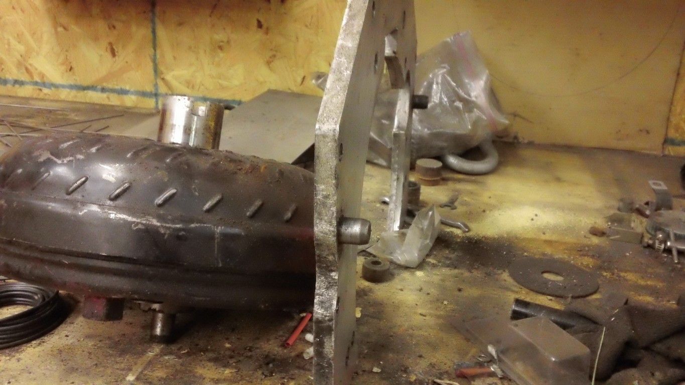

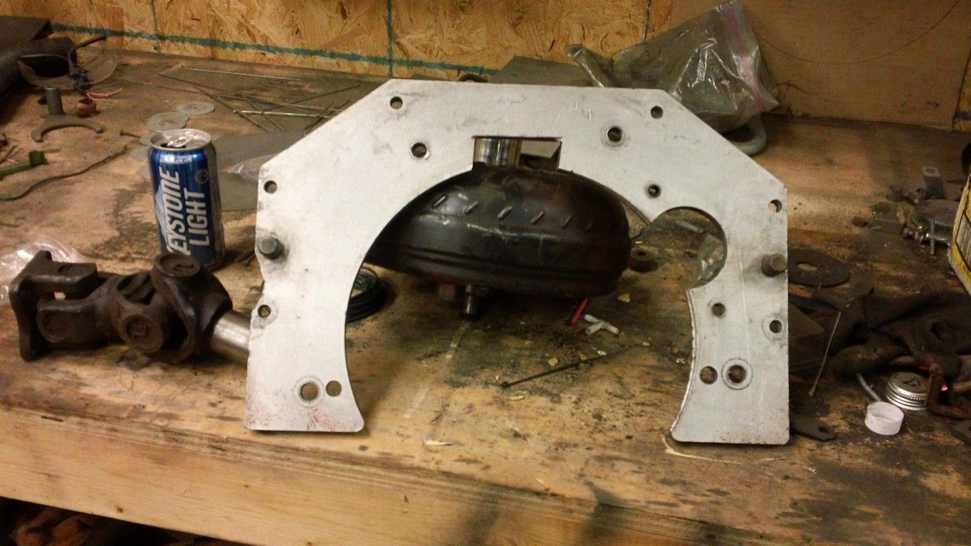

sum dude on pirate i think made them, it heavy built, i had it on 1.6, i go get pic so you guys see it

you just need 1.6 adapter then, i believe. this kit puts powerglide behind 1.6 then small intermediate shaft to zuk t-case, is how i ran it, but many other options to running this
