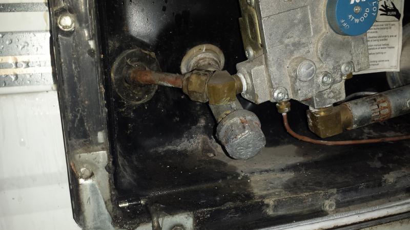

So I assume that plug is the one I wanna pull to drain the hot water tank?

Yeah that is the plug. You can use a water and vinegar mixture to clean out the hotwater tank, it will remove a lot of the scale that builds up inside.
