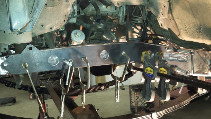

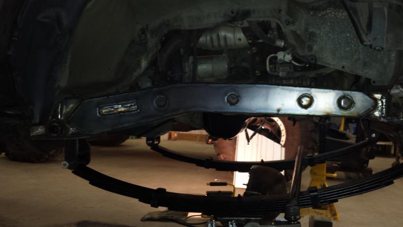

Passenger side burned in.

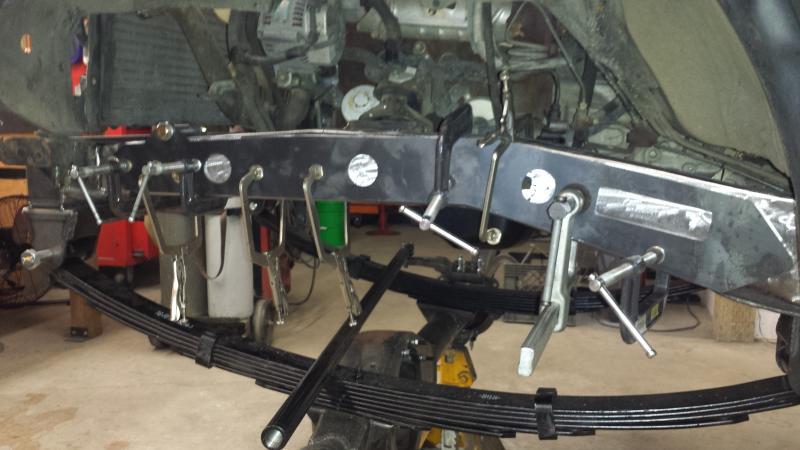

Getting driver side positioned and looks like going to have to cut deep into the body. Have had to do the same on the mini trucks.

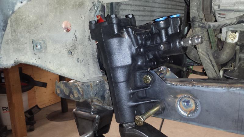

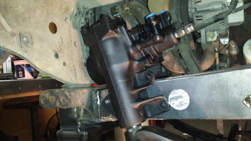

Frame is drilled for the steering box and frame plate ready for some heat.

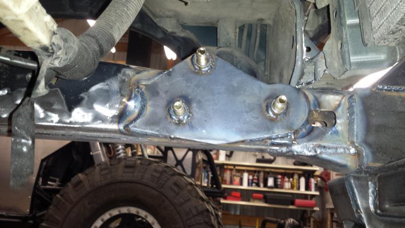

Inner brace for the steering box all burned in.

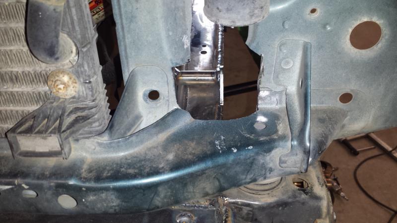

Now to give the steering box some room. Chop chop goes the sheet metal

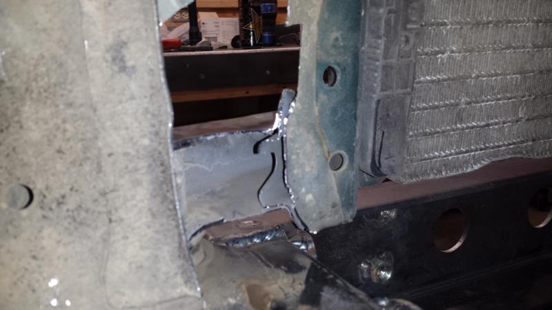

It was chop and install the box then rinse and repeat until i got the fitment i wanted.

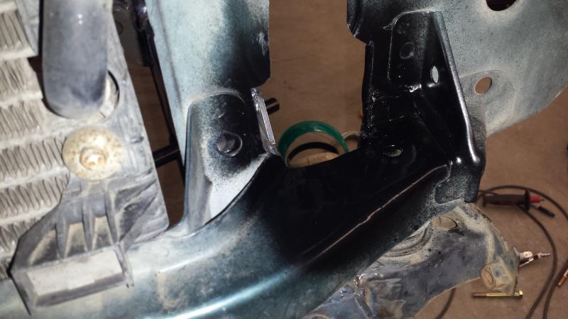

After I got the fitment I made an insert. I welded the seams that were separating and then made an insert and welded it into place to regain rigidity in the core support.
