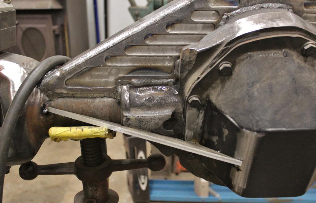

Alright yall Pete's at it again!,,,This time it's his own personal rig "NASTY TIME"is startin to come together!!!
He's already off to a good start,heres some of the Dana 70 front axle goodness......
Chassis beginning pics comin up ;D
Pete works FAST and time I got up there this past Saturday he had done bendered and weldered up this much on the chassis.....
More pics on the way ;D
The specs I know are Dana 70's front and rear,43"Stickies and some kinda "Pete level" built small block with an F.A.S.T. fuel injection setup.
Heres a few more pics......

how do you plan on removing diff cover
chassis looks bad ass
Pete done a lot more after I took that series of pics :dblthumb:,,,I,ll get some pics of what he done to make that cover slip out :dblthumb:
once the front truss was finished it was cut beside diff cover at angle 3/8 plate welded in behind the 1/4 plate drilled and tapped then held in place by countersink bolts I plan on putting uhmw on bottom of front truss for the slide over rocks

You can sorta see the front cover remover thingy down in this pic.....
