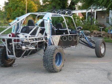

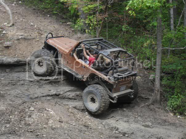

Here is the jeep I bought and wheeled it like this for about 7 months
It has a 4.0,ax-15, stak and built 60 front and 9" rear with 106" wheelbase and RE long arm up front and flipped XJ leafs in rear on 42" rockers.
I decided I wanted something more like a buggy, that I could beat around, have lots of power and soak up the bumps. The only reason I didnt go full tube chassis is because my wife and son come with me on every wheeling trip and they like the top for when it rains and the heater when its cold. The jeep is also street legal and is a blast to drive around town

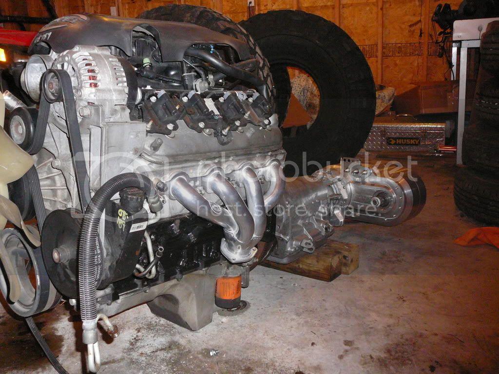

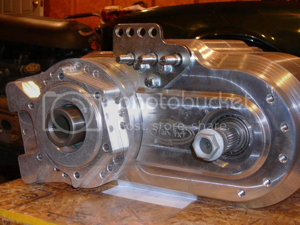

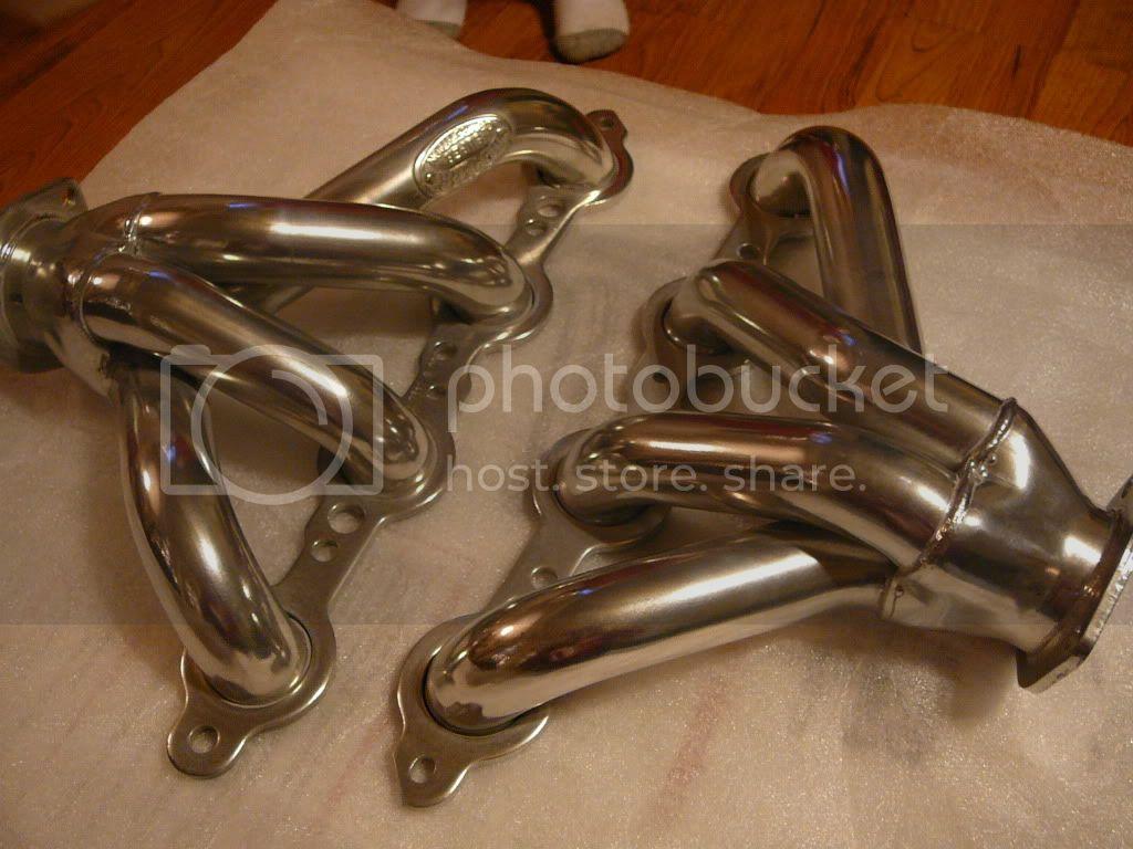

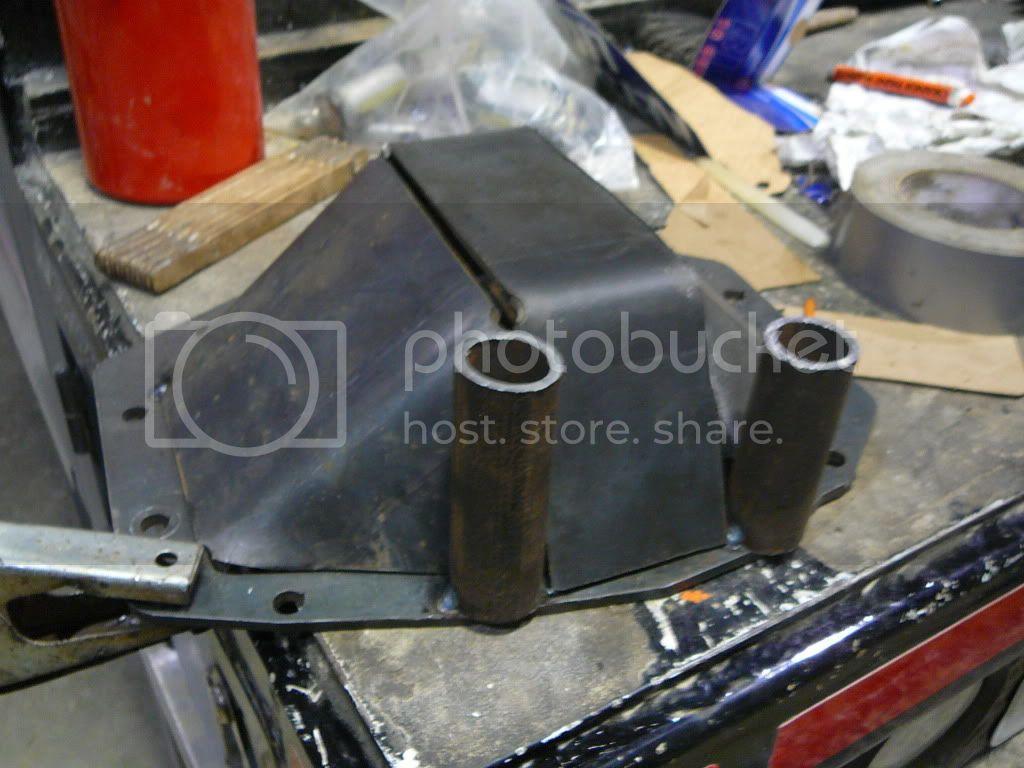

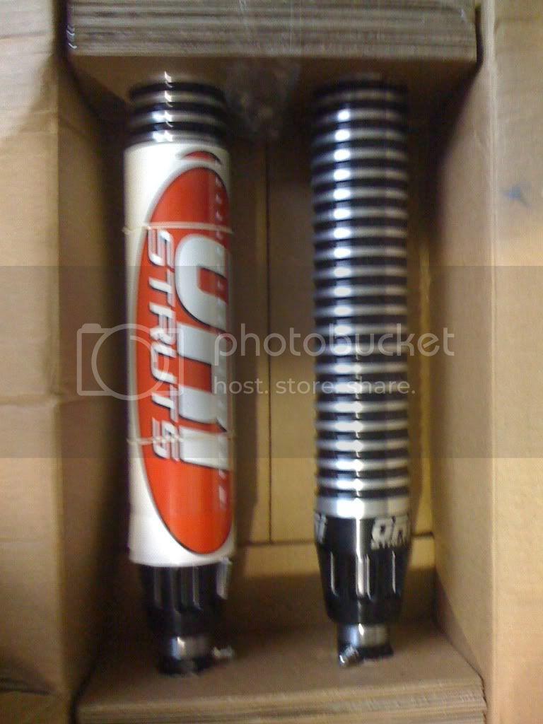

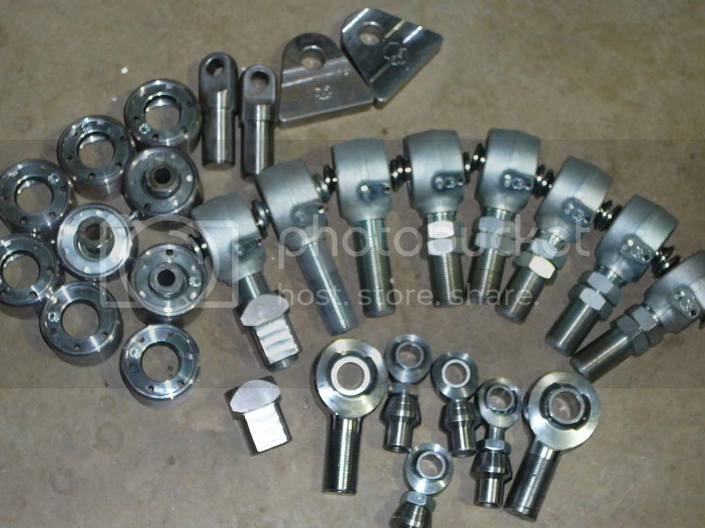

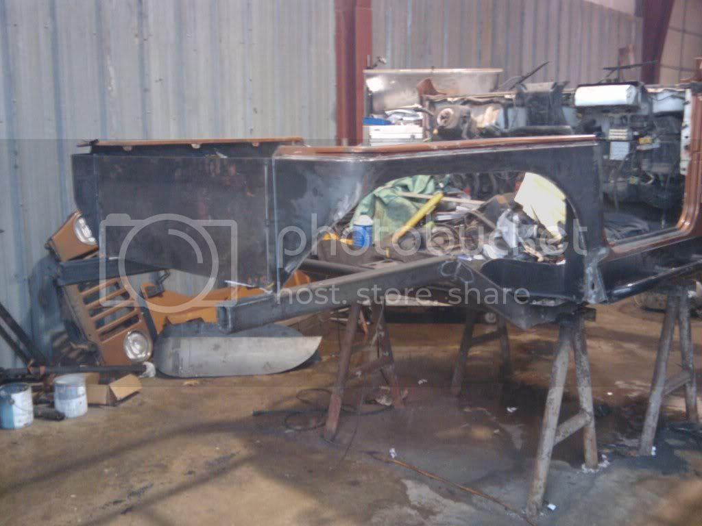

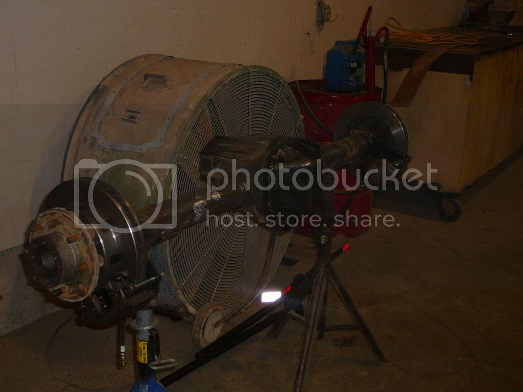

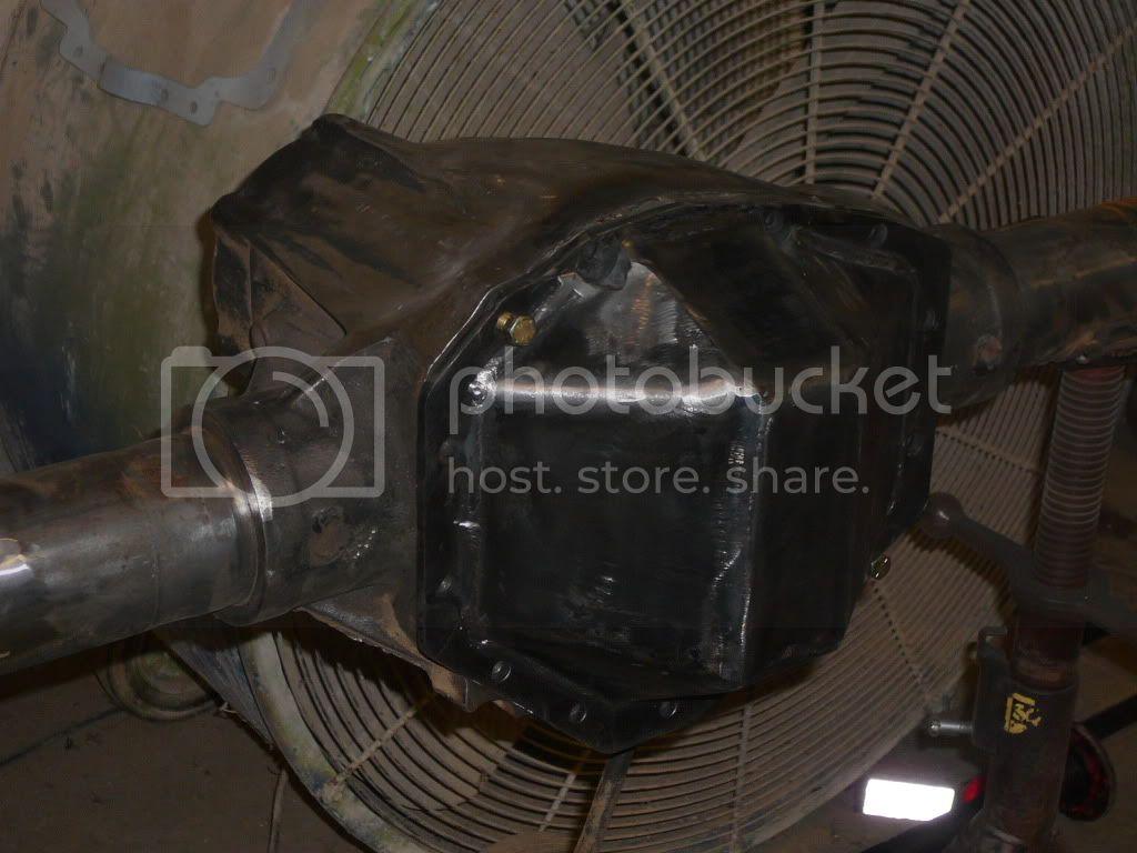

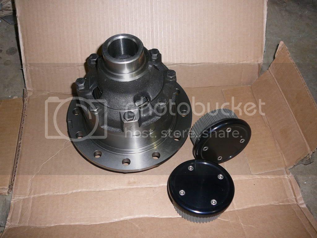

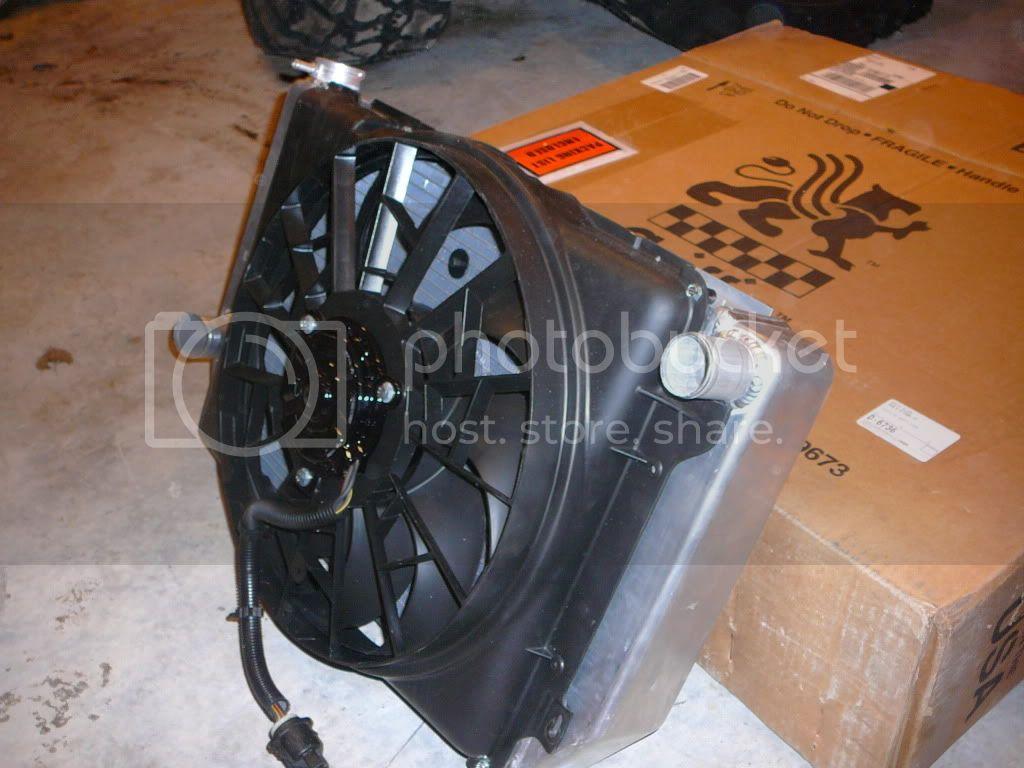

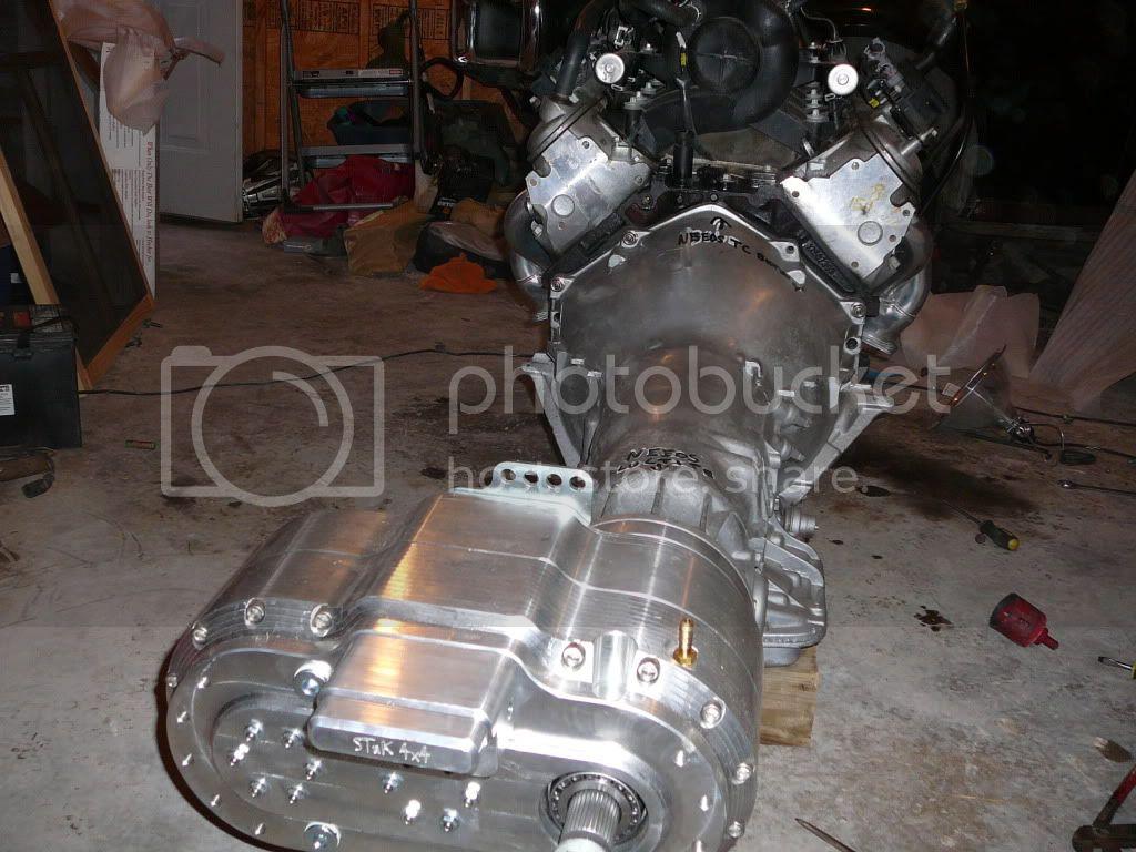

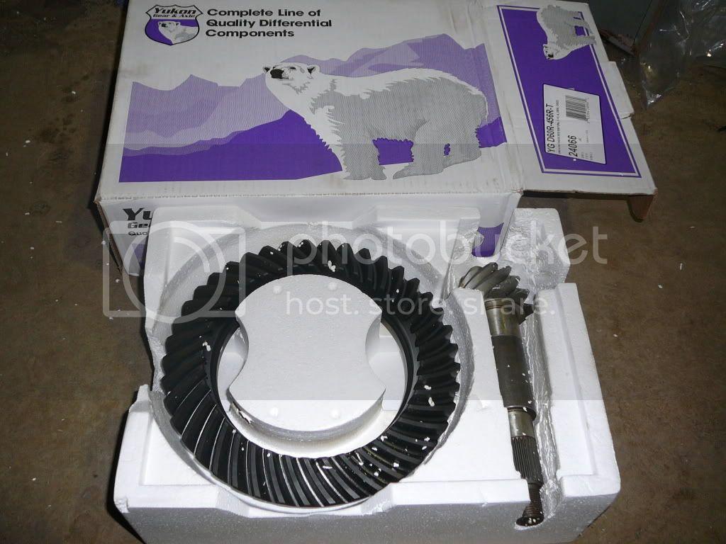

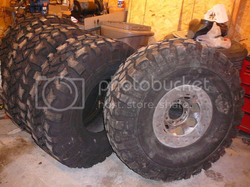

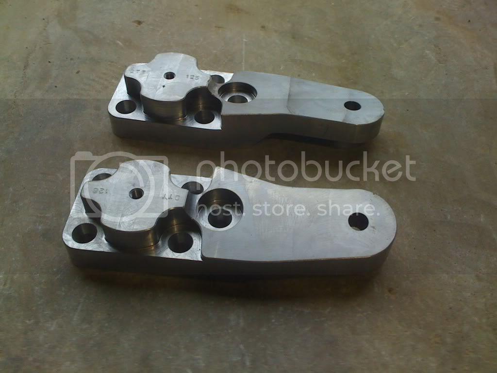

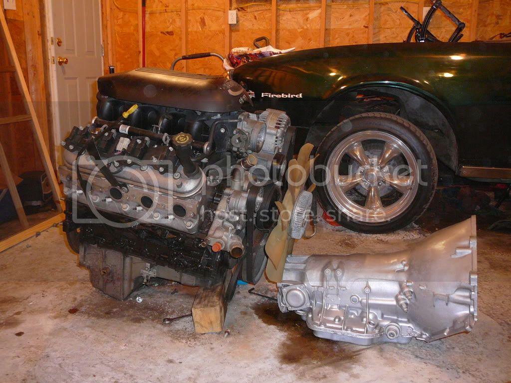

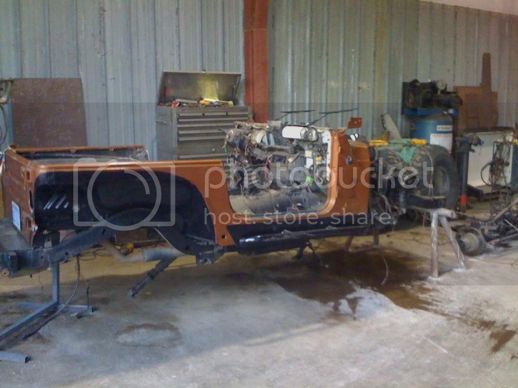

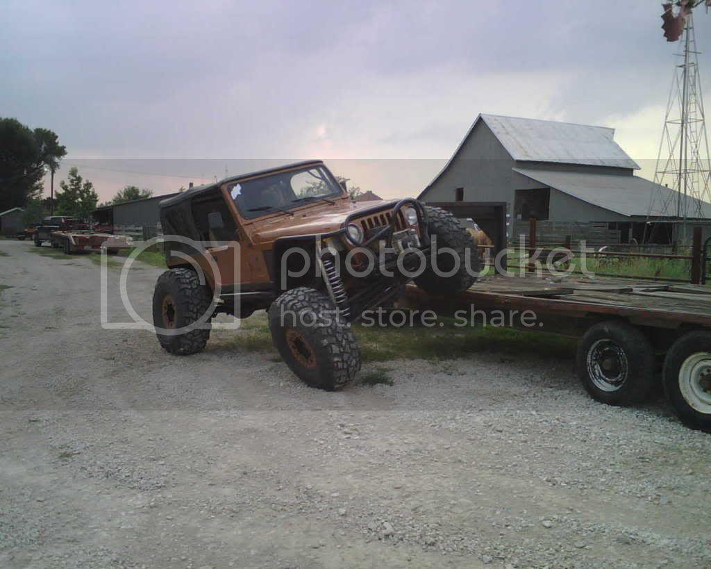

The plans for the Jeep are 5.3, turbo 400, stak 3 speed, Built HP 60 front and 14B rear with Ori's up front and air shocks with bumps in back. Going to be around 112" wheel base and be on 42 rockers. Im wanting 8" of up travel front and rear at no more then 24" belly. Here are some of the parts I already have got
