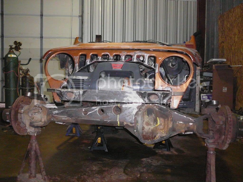

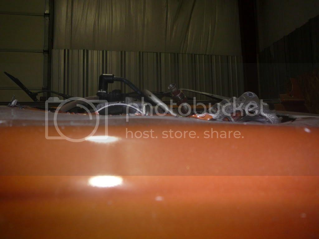

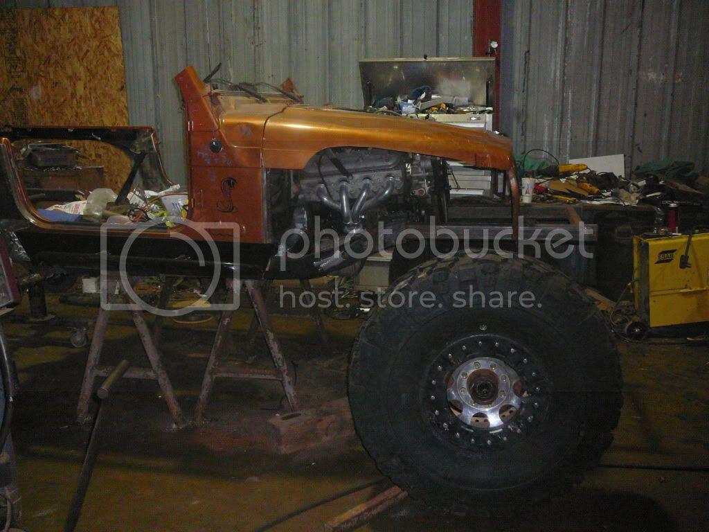

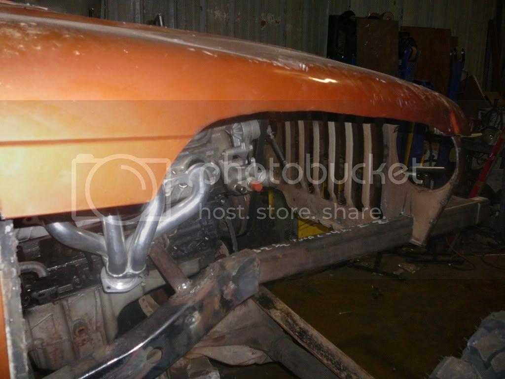

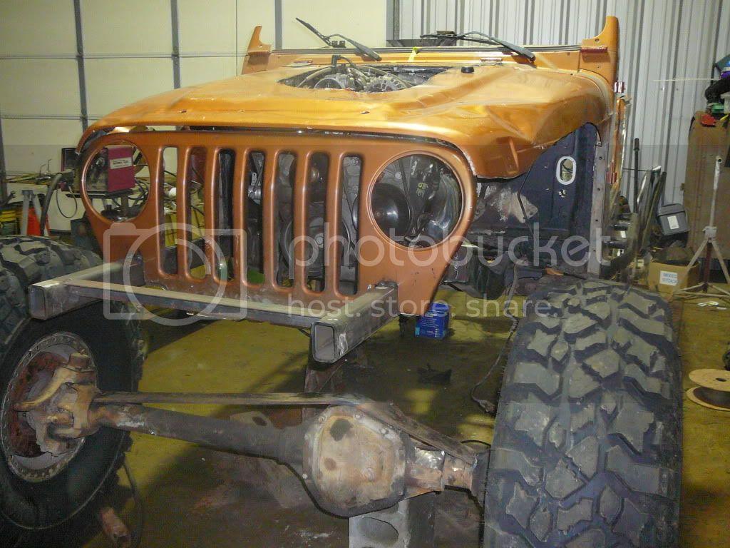

The grill will be sunk down about 3".

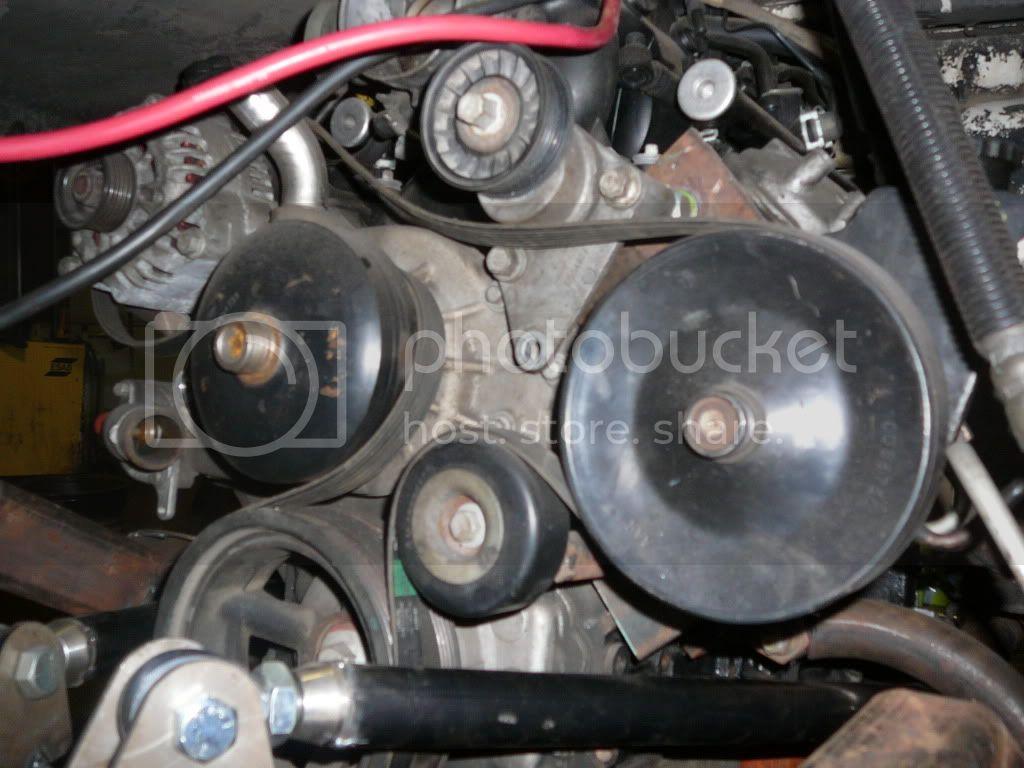

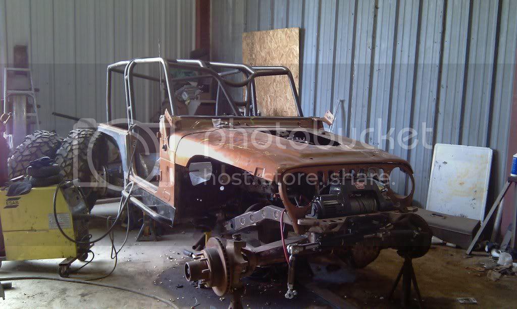

Which required alot of hood work. This is not the hood I will be running, I have a brand new one but I dont want to cut on it just yet. Im not to sure what im going to do about the alt and intake yet. I can either put some kind of scoop on it, but the reason I dropped the grill was to lower the hood for better visability. I do have a LS intake I may put on and relocate the alt

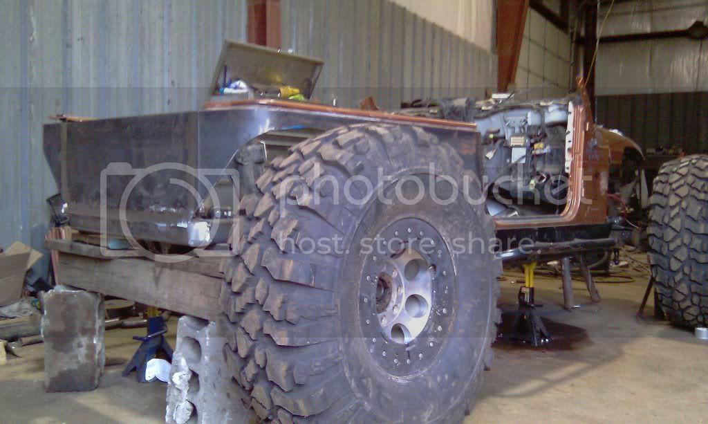

Got the front end under it with the wheel and tires on and started on the front truss

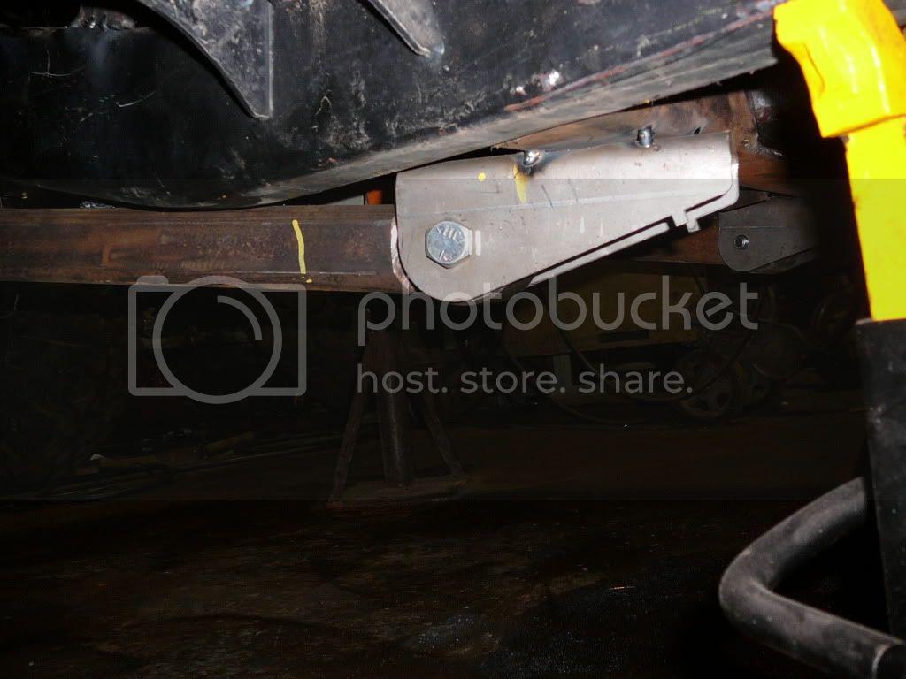

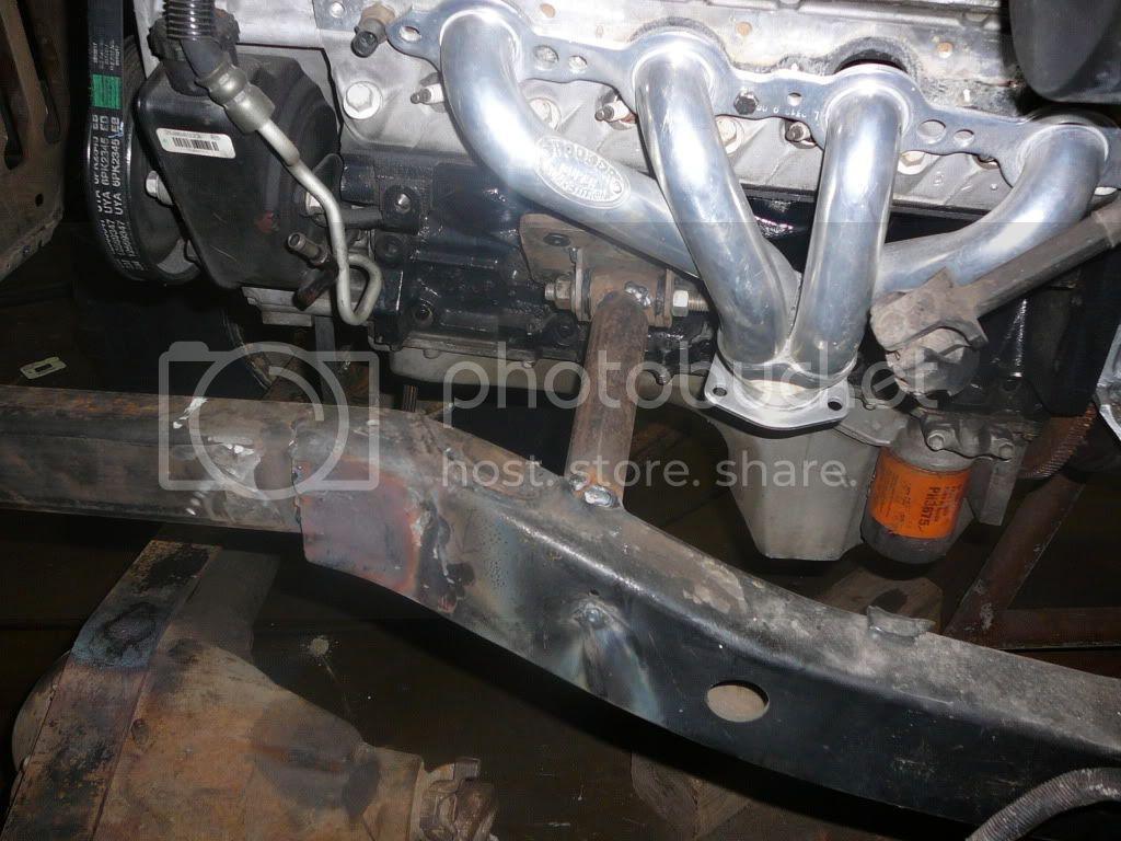

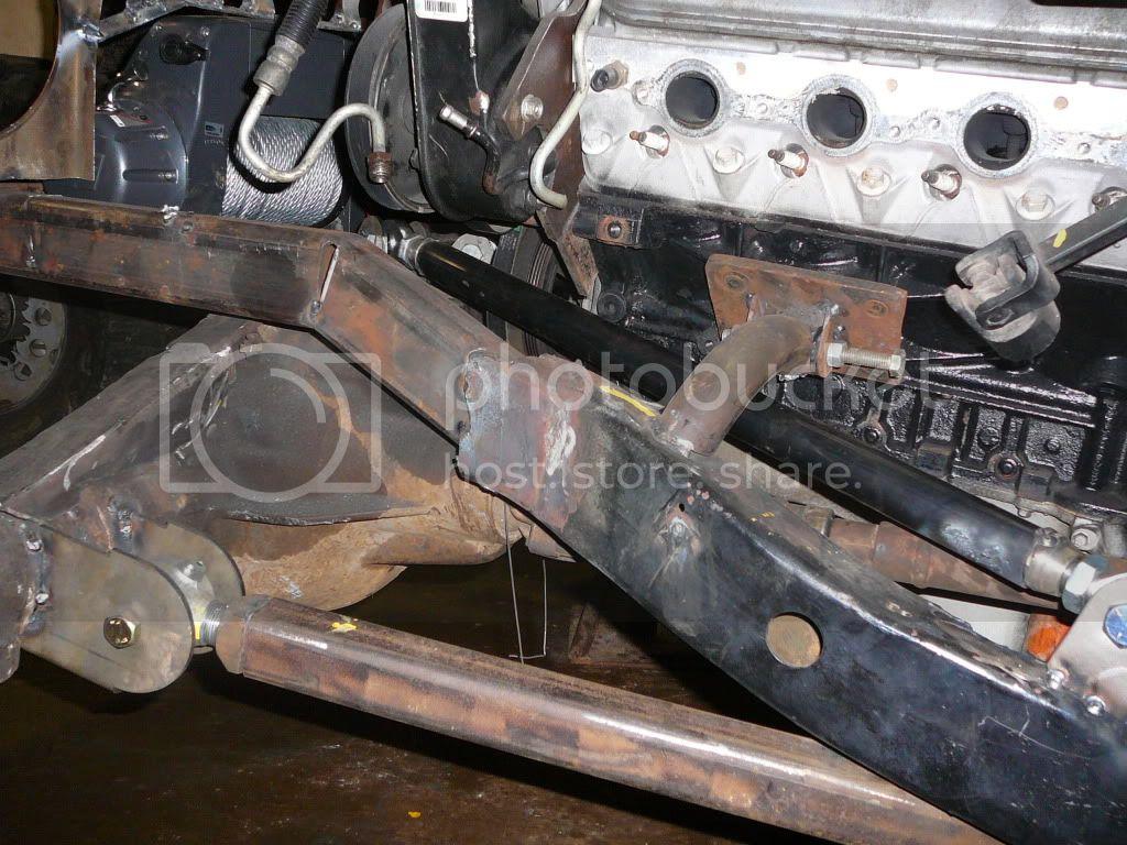

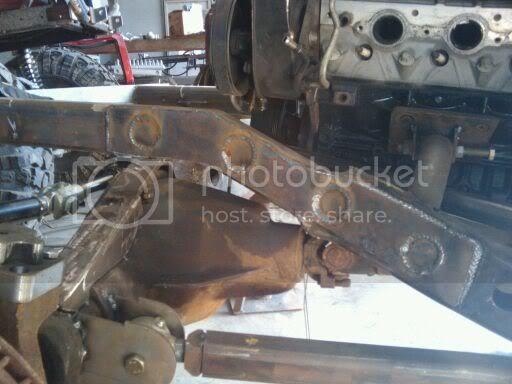

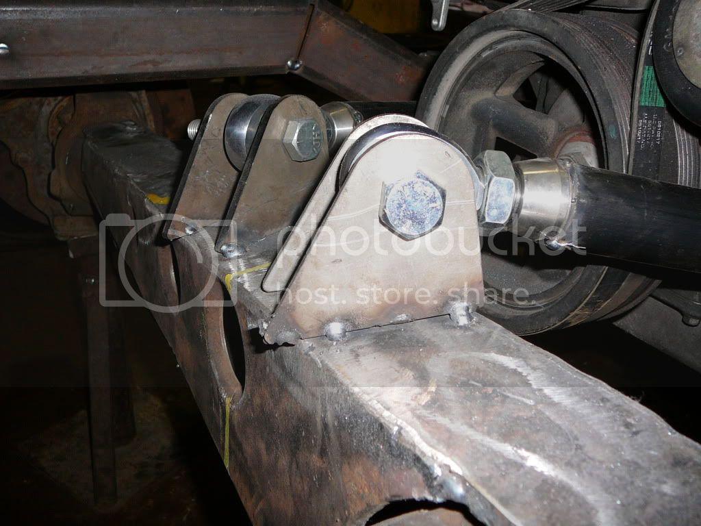

I changed the motor mounts also, the way they were before my upper links would have hit way before full stuff, they will have gusset put on them also\

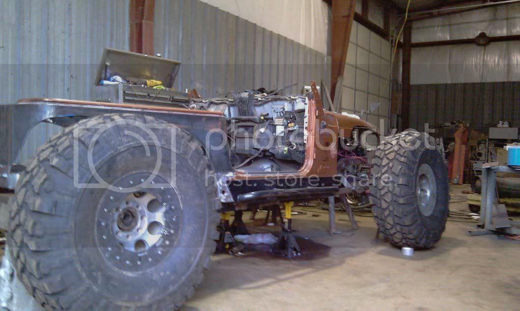

Here are some updates. All of these pictures are at full stuff:

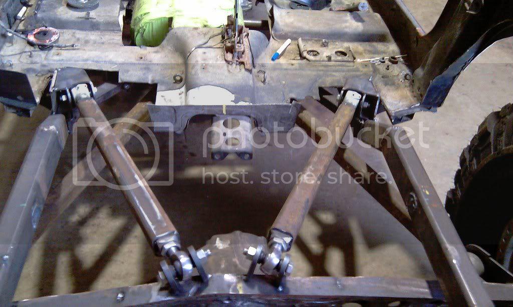

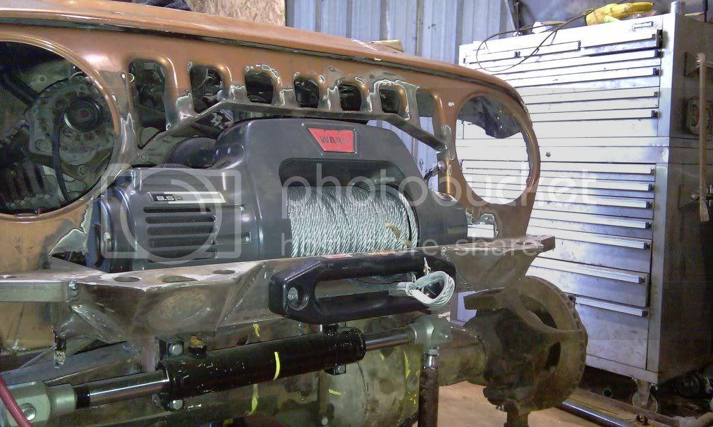

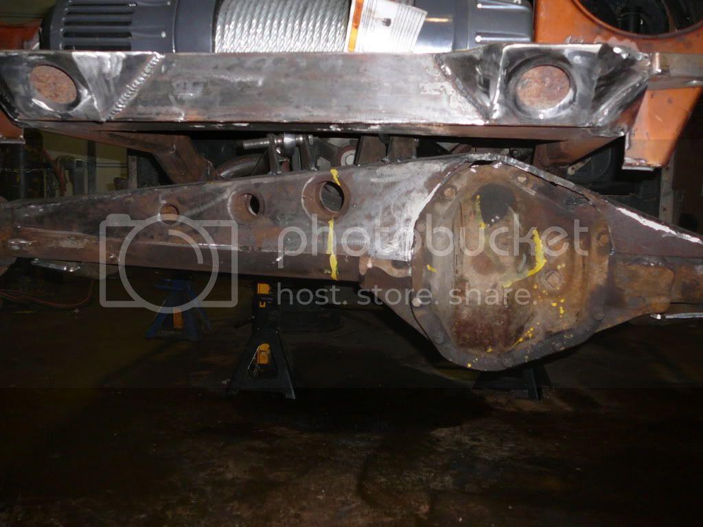

I had to redo the front frame and motor mounts. Got the front 4 link done, front truss, and front bumper done. Most everything is still tacked, I will weld everything when Im done.
Upper links will be 1.5 .250 wall and lower are 2x2 .250 wall
I also had to relocate the alt and power steering pump

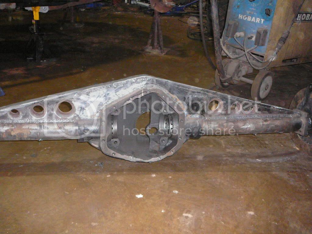

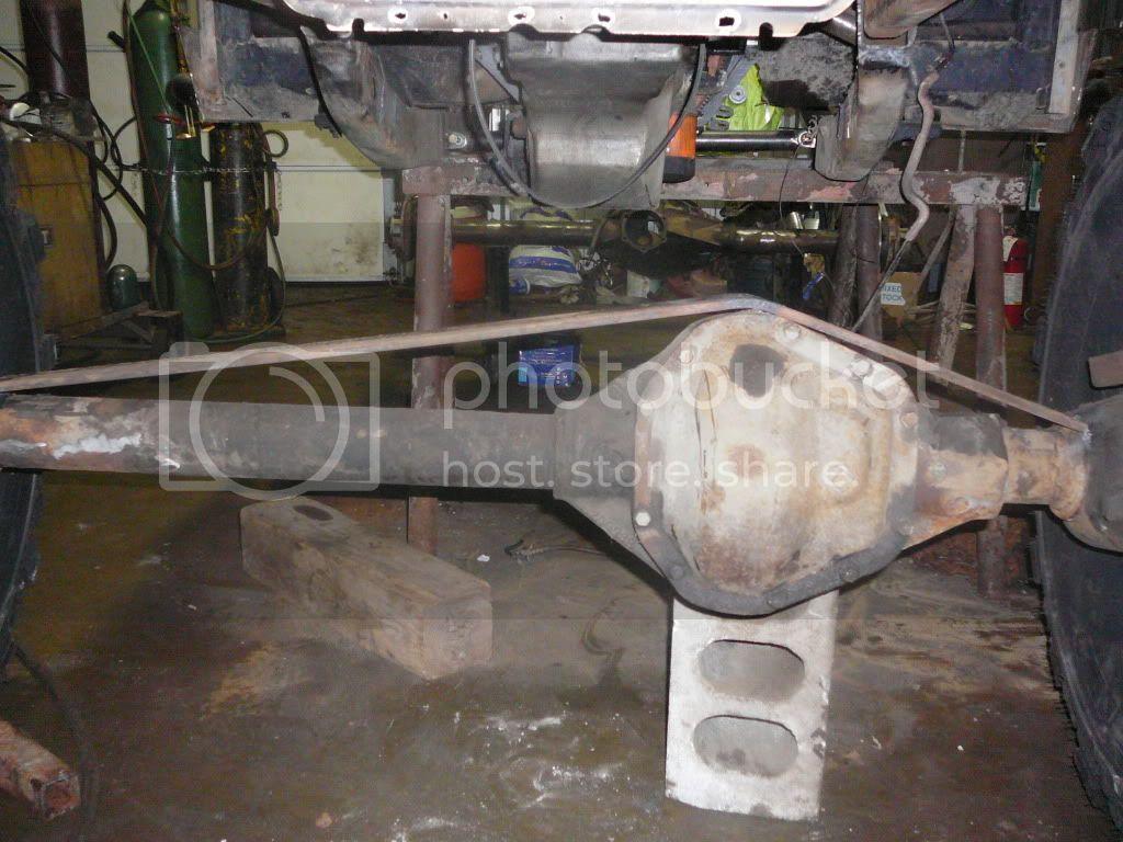

Here is the 14 Bolt truss. Hoping to get the rear linked tommarow.

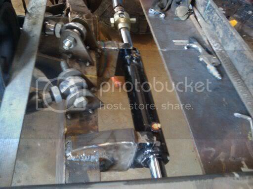

Steering mounted
Fishplates on

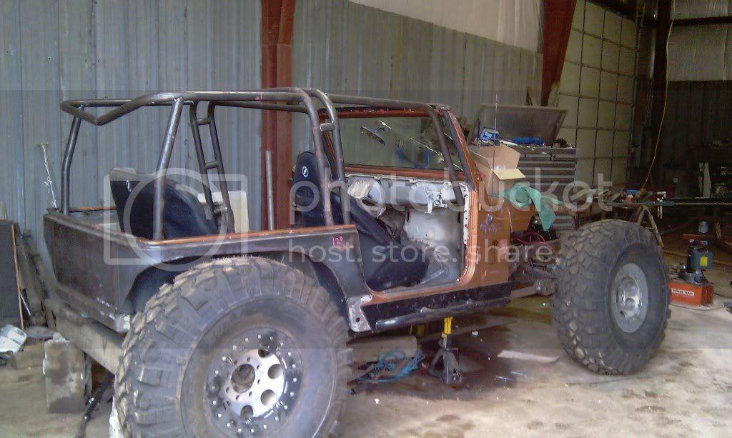

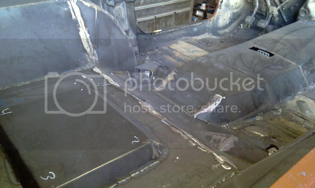

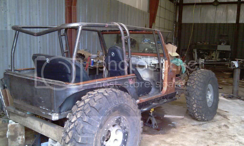

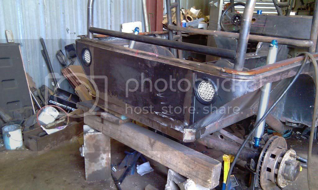

Got a little bit more done. Rear 4 link is done, rear bumper and also got the stak braced. Jeep came outto 112" wheelbase and in the pictures is about 2" to 3" from full bump.

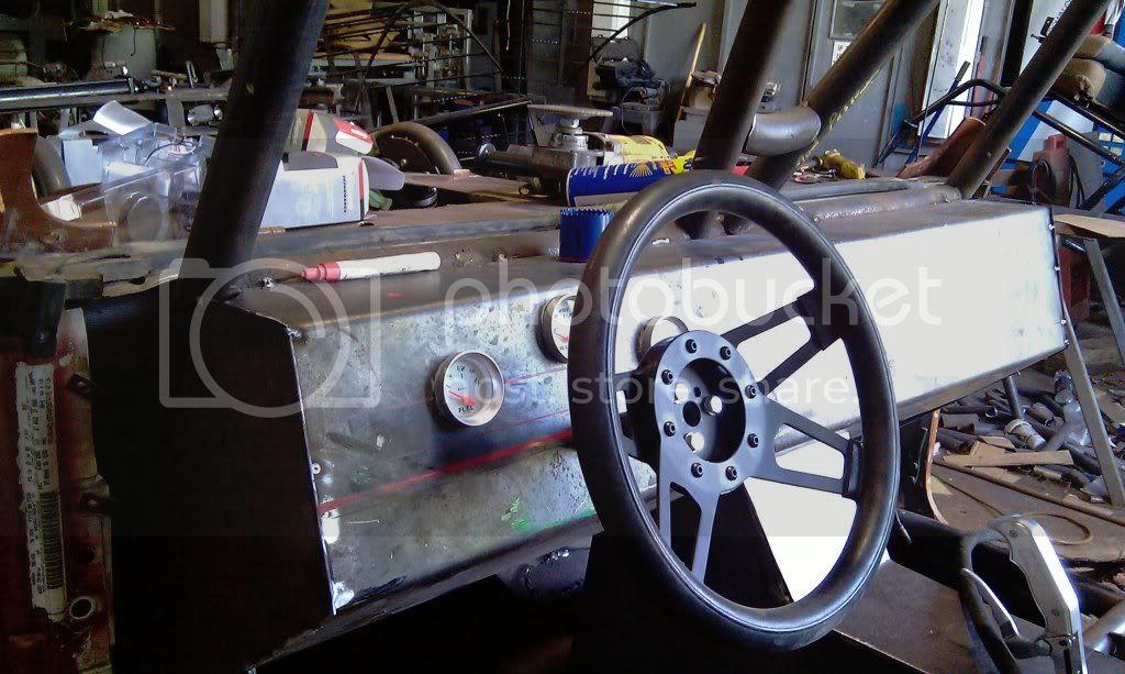

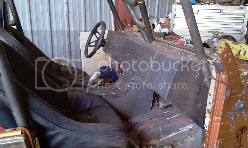

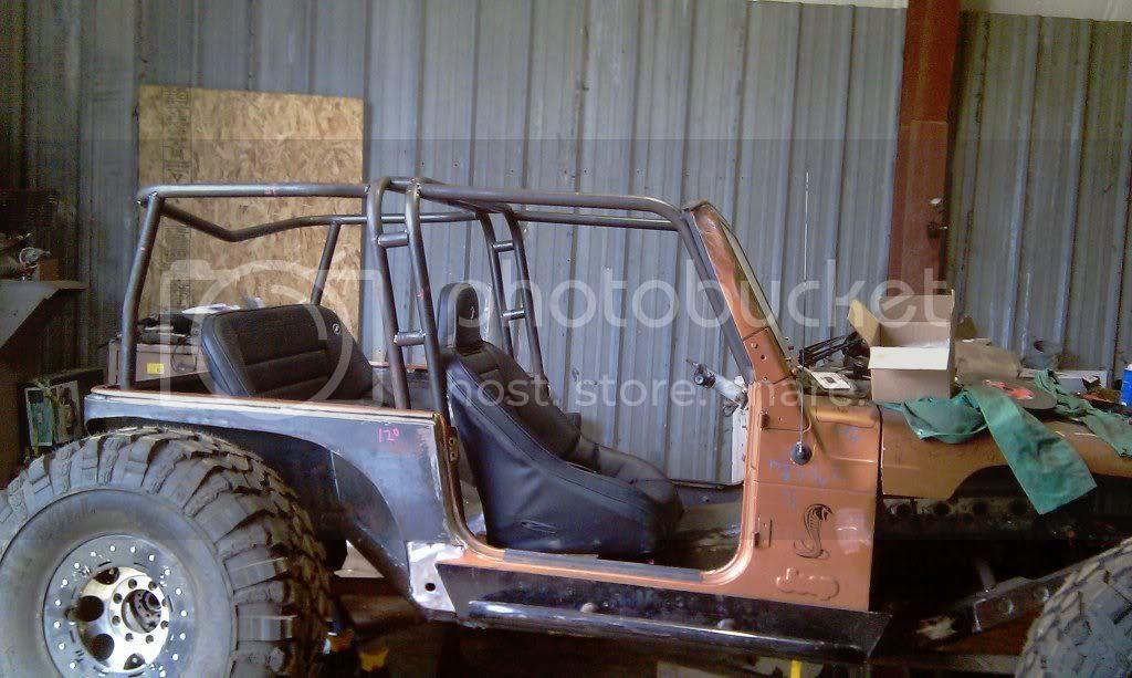

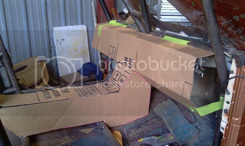

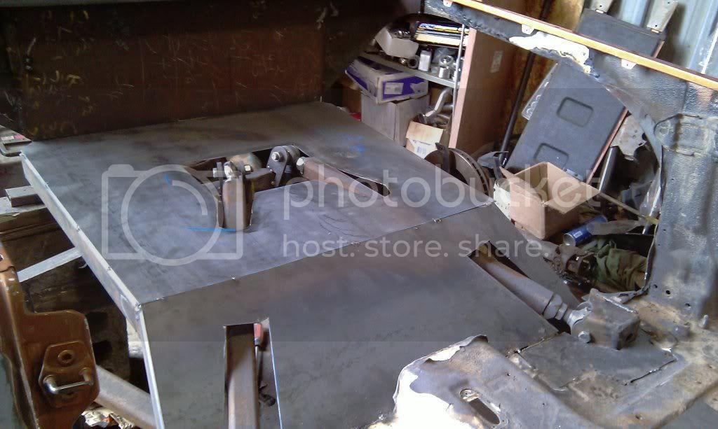

I got the dash mocked up with cardboard

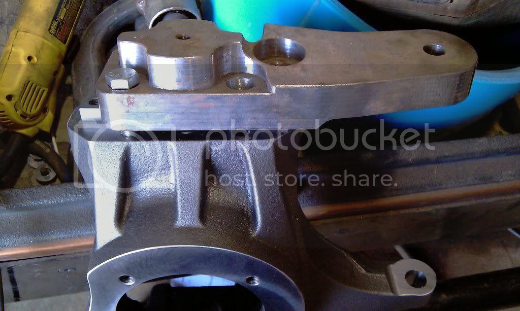

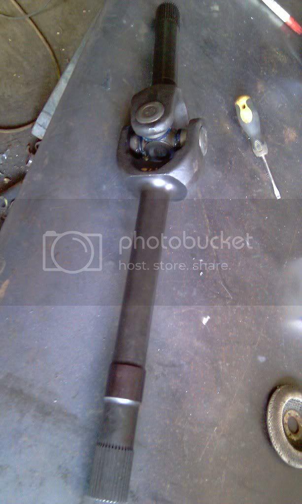

Also got my front axle shafts put together, i got to take them back apart to drill for grease zerts. the u joints are 806's that have been heat treated and cryo'd and the needle bearings replaced with bronze bushings .
Worked on the dash a little bit more. Got the sides on and center console done and cut out for the shifter.
Whats the details of working those 806's... Did you come out any money ahead rather than just buying longfields or ctm's... I'd be interested in going that route...\
Lookin good :drinkers:
ya i have about 150 bucks in the pair. but i got the machining done for free and the heat treating and cryo done very cheap.
