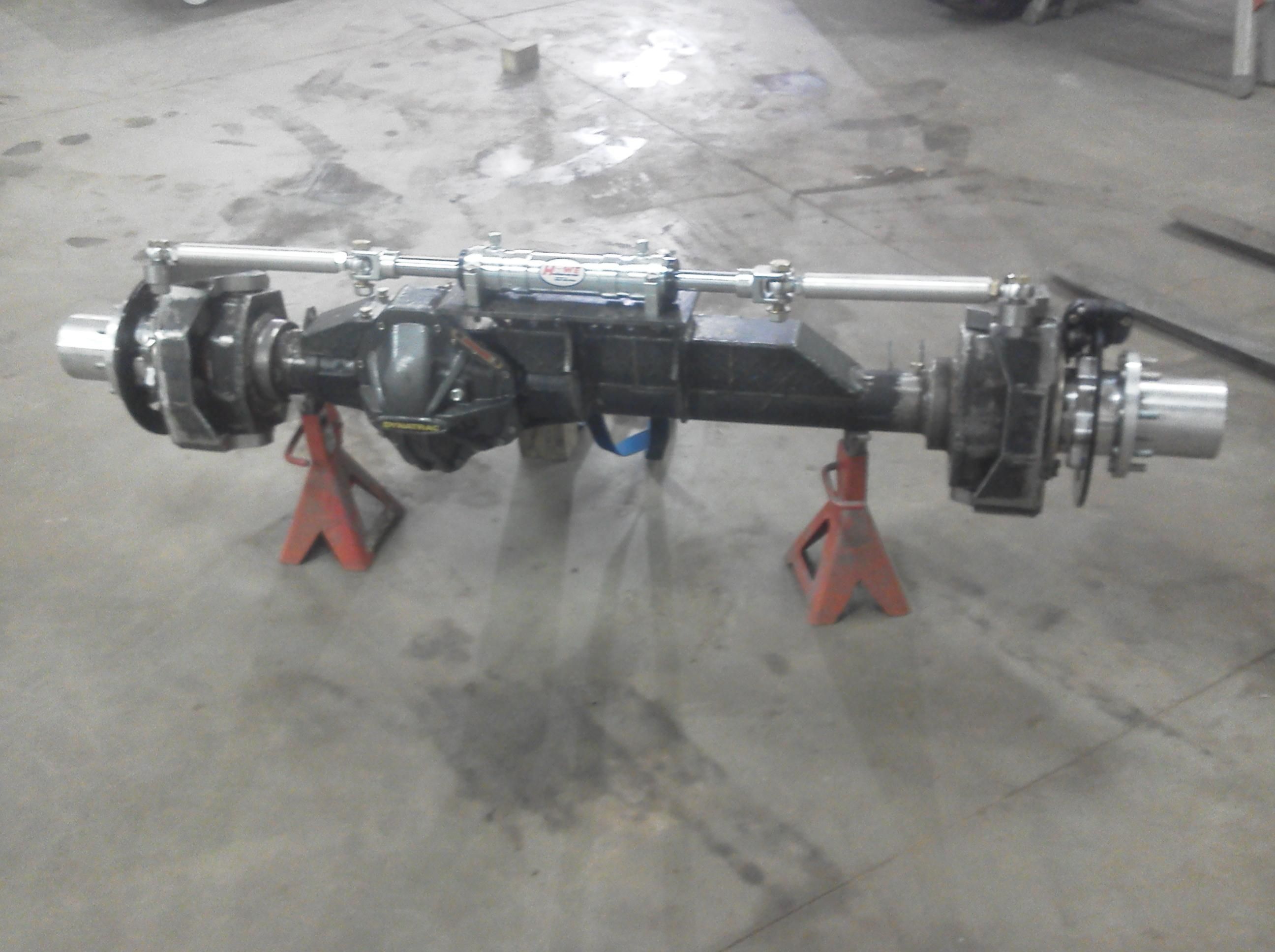

not saying this is the way to go but this is what i did. pro rock 80 ,alum hubs, billet spindles ,billet spool (rock solid) rcv 47 shafts 619 lbs . I am running low max 205 with billet covers. i am hopping that my driveshafts are the weak link,spares in the truck.
Badass. Those knuckles are huge. the aluminum hubs and lightweight brakes are a big weight saver for sure.
What kind of bearings/bushings/etc were used for pivots for the knuckle?
I'd like to do something similar but low-buck with an 80 center and 05+ Ford Super Duty 60 outers. (probably wouldn't hold up to crazy airborne assaults, but it wouldn't break shafts or ring gears)
thanks, the knuckles use brass bushingsand 2'' king pins . i used a 05 /newer 80 for the rear. I think what u are going to build would be super strong ,plus light using the unit bearing
