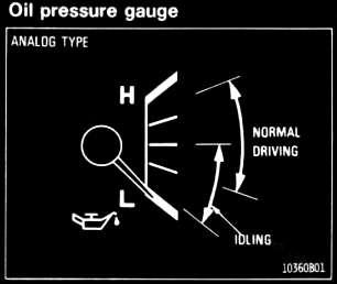

Whats normal oil pressure for a 20R with 175K miles on it?
Mine is PRETTY low when warm.
Should I through in new rod and main bearings?
Factory numbers for both the 4 & 6 cylinder engines
Oil Pressure @ Idle - 4.3 psi Minimum
@ 3000 rpm - 36 - 71 psi
they don't take a lot of pressure to keep alive, probably one of the reasons they last so long. i'd like to say mine with 300,000 miles on it idled at around 5-10 depending on the temp, and went between 60-80 under load.
OK then, I ain't going to mess with it. Thanks for the info. On to the next fix :cheer: :cheer: :wtf:
