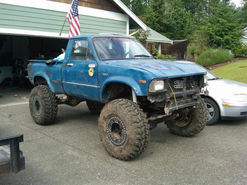

come on charlie........ leave the truck alone till it blows up and just wheel it. :mad:
oh and go with a TH350. It's already trailered so you don't need an overdrive. Jason has some in his shop too. As far as flashing the ECU there is a guy over in eastern wa, that will do it for a 150. He will also thin out you harness for another 100 or so, if you don't want to do it. Maverick26 posted a link on here a while back when Jason was looking for someone to flash his ECU.
I never said I was gonna pull the 4 banger yet did I?:fawkdancesmiley:
It's going to take me a while to save up enough to get all the adapters and the tranny I need. I have the 4.3 already so I don't need to worry about that. Just need to start collecting parts for the next stage!
lets just tune that 22r up a bit. I think it was running on 3 cylinders. If you need a hand just shoot me a call or bring it down. Then you can run it for another year or so while ya gather up parts. I think the stauns inner beadlocks would be the easiest fix to those wheels. :beer:
edit: and I have a trans for ya if you want it (for the cause)
I broke one of the "worse" tires down last night and the Iroks seem to have held up pretty well!
I wish these tires were as hard to pop a bead as they are to dimount from the wheel! Still can't get the tire all the way off. Hopefully this weekend will bring some better luck breaking them down.
Edit: I think plans are for me to weld some kind of safety bead on the rims. I can't afford Stauns or any other inner locks right now, so I need to try and salvage the rims I have. FAWK I hate reverse center rims...:puke:
