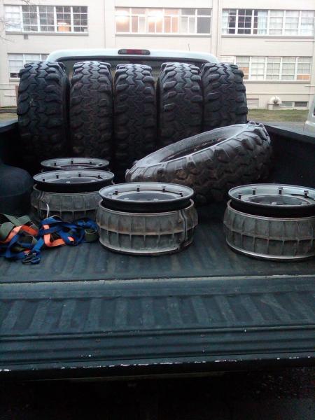

Well, after a light day of snow wheeling New Years day, I am etremely dissapointed in my rig and was damn near ready to just give up on it....
On the way back down the mountain Saturday I blew all 4 inner beads and had some serious issues with my engine. Unloaded the truck last night with 3 beads off and the engine running badly.. Needless to say the truck is up on jackstands getting ready to be torn down...
REBUILD TIME!
I've had a 4.3 sitting in my garage taking up space for a few years now so I figure I'll get that in there for some more reliable power.. As far as the blown beads I'm not sure what route to go. Weld in my own safety bead on the rim? Or get different non-reverse center rims and re-do the beadlocks...

I broke one of the "worse" tires down last night and the Iroks seem to have held up pretty well!
I wish these tires were as hard to pop a bead as they are to dimount from the wheel! Still can't get the tire all the way off. Hopefully this weekend will bring some better luck breaking them down.
Edit: I think plans are for me to weld some kind of safety bead on the rims. I can't afford Stauns or any other inner locks right now, so I need to try and salvage the rims I have. FAWK I hate reverse center rims...:puke:
Ahhhh you have reverse center wheels... **** beadlocking those wheels. The inner bead on them is what used to be the outer and it is smaller than the standard inner. I'd dump those wheels and do some DIY beadlocks and IFS hubs on standard wheels.
Reversed center wheels are a headache from hell as you've found out.
Are you trying to pull the tire off from the beadlock lip? Or from the inside lip? Reason I ask is on a reverse-center rim, the tire comes off much easier from what used to be the original outside lip...
Good luck with reversed center beadlocks... You still have to get one bead over the large side of the wheel one way or another. :eeek:
Yup....They're a *****....I agree completely that reverse-centered wheels should not be beadlocked...
Yeah I'm kicking myself in the ass for going with them. They were a fawk load of cash too... Won't be able to get new wheels for a while(have to save up for them).... Hopefully I can figure something out on these fawkers soon. Once I get new rims I can go ahead and just order a new inner ring for my beadlocks..:mad:
Looks like my best option to fixing my bead problem is to get new rims..:mad: Wish I wouldn't have gone the "easy" route for the stance I wanted.
