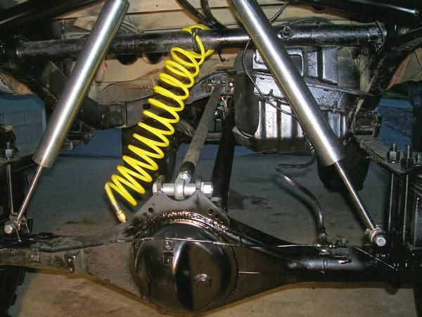

I did one single center one the other day on a friends truck and used two hiems. We will be adding two more on the bottom ends of the the axle because the one sigle one did not stop all the wraping, the bottom of the axle till can rotate up because his springs are so soft. this truck has worn out stock toyota springs and 4in blocks. I do not think the a single one on top will work very good with your buggle leafs because when the buggy leaf drops down the single trac bar joint on top of axle will still allow the bottom of axle to rotate forward and cause axle wrap. Thats just my experiance with single top center trac bars.

Is it just me or wouldn't that cause some housing rotation during droop do to it being a different (looking for the right word) radius? than the leaf springs since there is no shackle at the crossmember? Like it would try to point the pinion up during droop as the axle moves forward?

hey that was an experiment in how light it could be built. It lasted a year :flipoff:

thats a good point too. I try and make the traction bar frame end line up close to were the front half of the leafs bolt in.

Your's is with a shackle though...so then it wouldn't matter as much the length of the anti-wrap bar

i RAN THAT setup--it won;t stop axle wrap but will slow it down--the front half of the leafs will bend causing the pinion to move upward..
