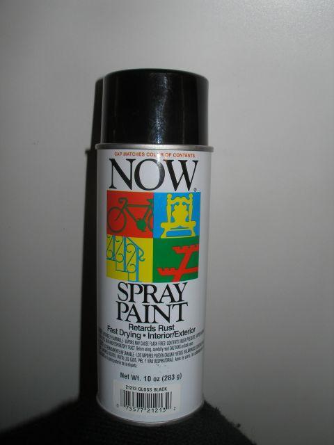

Cheaper the better
I figure that most stuff you could use will not be scratch resistant and will not hold its shine, so.... the stuff I use I get at my local hardware store or walmart. Both places it is &1.29 a can. looks just as good as any other high dollar black gloss. Here is how I would do it: Put a few coats on to start with, go out wheelin and get it dirty, then spray it off, then take 30 seconds to put a new coat on to cover scratches and shine it up again and make it brand new again. Repeat that and you will always have a brand new shinny loking housing.
