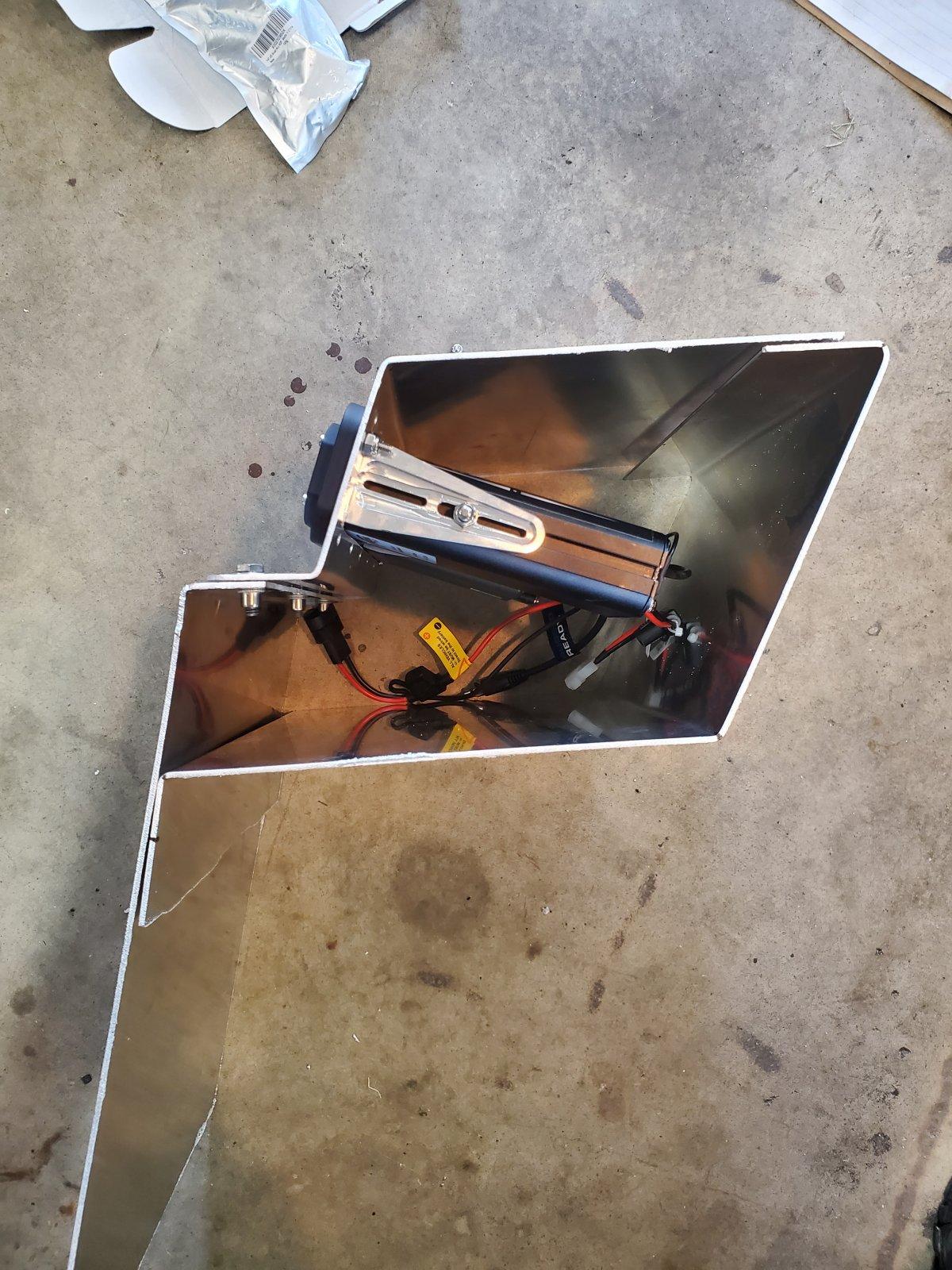

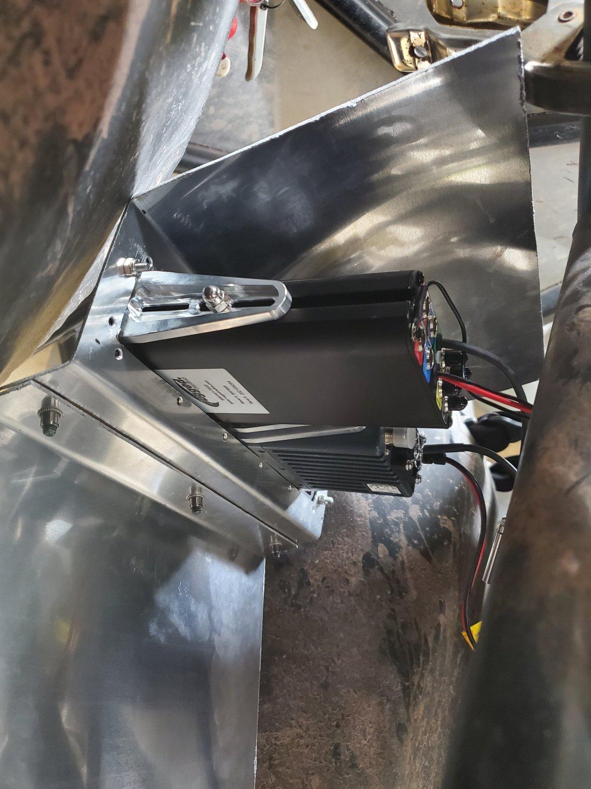

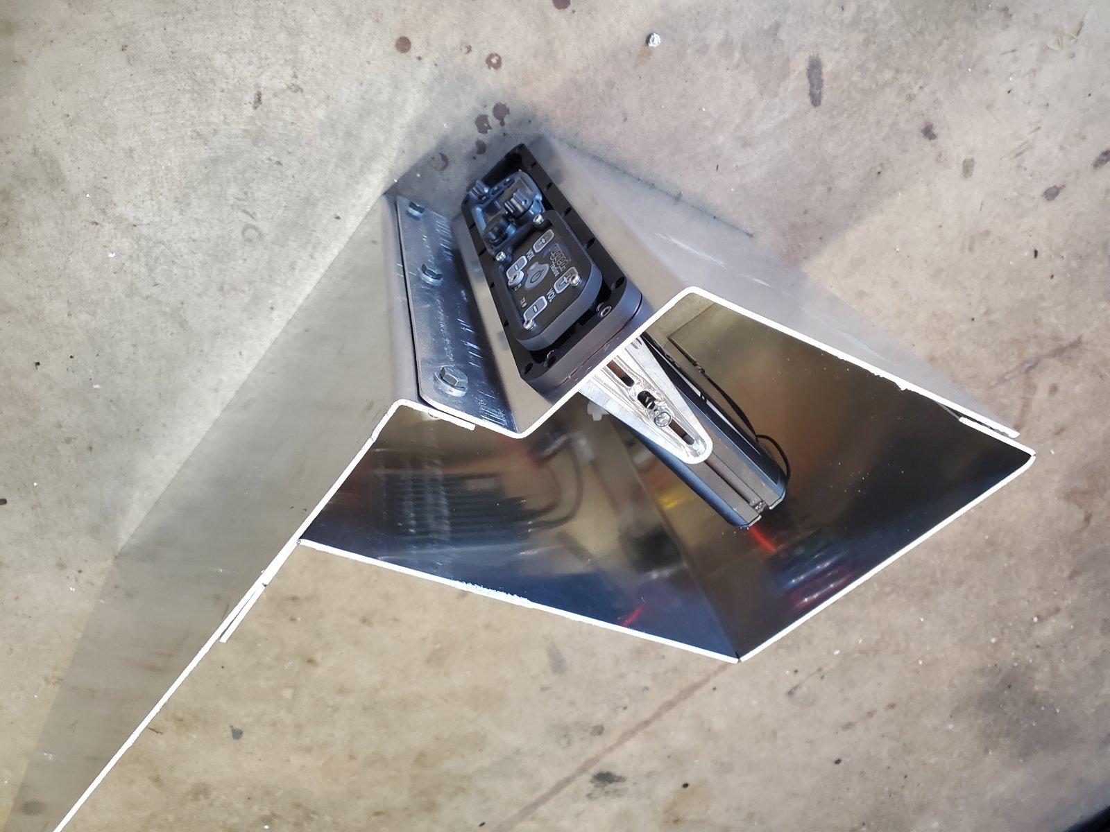

Figured I should update this and continue documenting my struggles. Started a thread about comms (https://www.hardlinecrawlers.com/threads/trail-comms.62852/page-2) and ended up basically going through my installation process. Gonna pick up where I left off over here. So my great new idea to solve the clearance for the plugs isn't really anything special or revolutionary but it works and will also allow for easier service/access in the future, something I'm not really known to take into consideration. All I did was cut the console panel, overlap 1" and screw them back together with some stainless rivnuts. Now this obviously pulled the rear portion away from the cage where it was going to mount but I'll just build the bottom and rear panel as one, overlap (or underlap rather) the back of the top panel and tab that to the cage as well. This way, I'll be able to remove the top panel which is what the units actually mount to and pull everything out the top, eliminating any need to wiggle up between the links and all that. Obviously, this probably won't be any help to others tackling a similar project, but this is my solution to my own created problem. It'll be great (enough for me).

This is what I meant. You get the idea. Will get side panels as well. So the panel behind the radios will bolt to the tubing, and the 2 vertical pieces below the radios will bolt to the back side of the existing console. Maybe I should do less talking and more building.
at least it will look clean even if it's not the most ideal location
Honestly, I think I'd prefer this over having them face me. I just feel like it would be an annoying kind of bright when riding at night. Or maybe I'm justifying it to stay happy. Either one is fine for me.

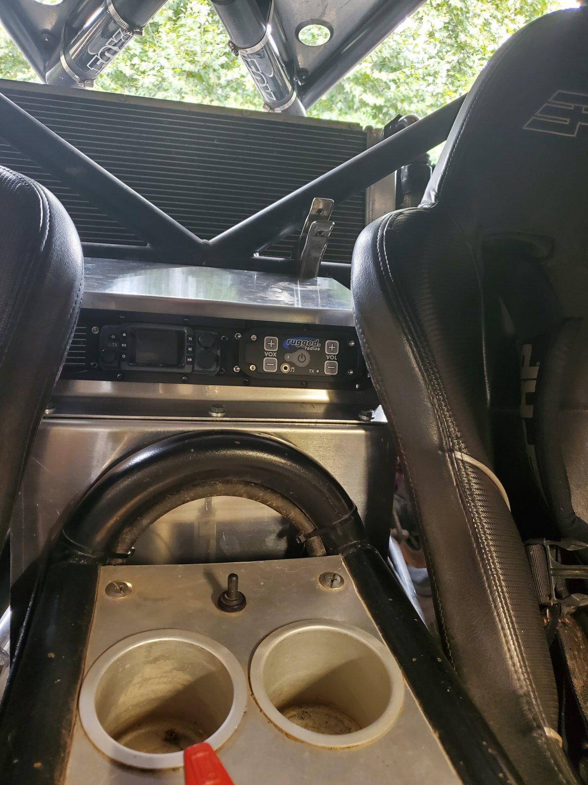

Looks good and curious to see how the radios work for you with the buggy exhaust.
I'm hoping for the best. My biggest concern is that I can get the VOX adjusted so it picks up voices, and not the exhaust. That said, it isn't nearly as loud inside as out.

I remember you saying that at Harlan last year.
Most of the intercoms I've used have a lot of electrical noise, which is a bigger issue than exhaust.
