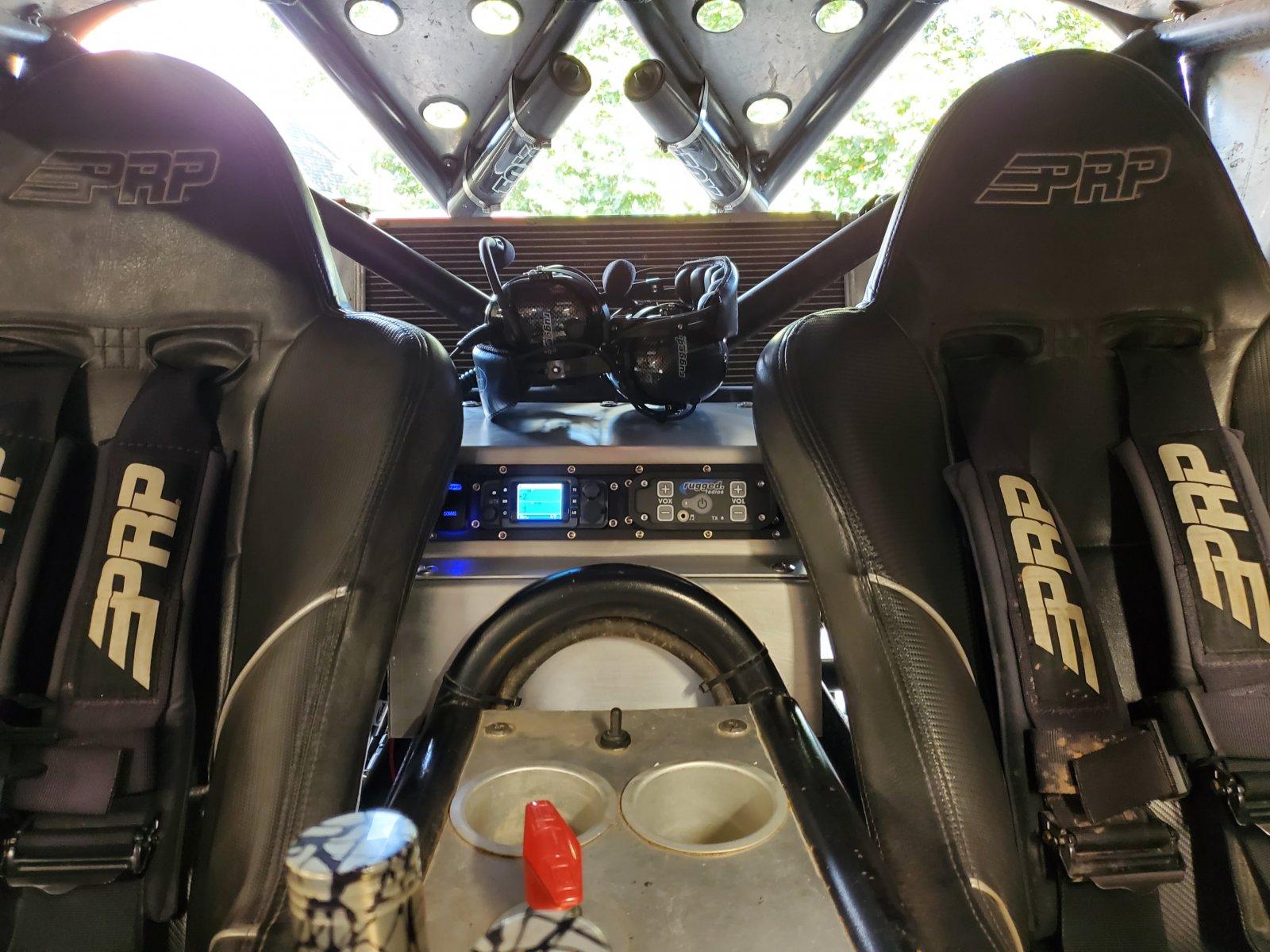

Aside from mounting the antenna, mounting the ptt buttons and tying up some dangling wires, I'm calling it done. For now. Also need to make some headset hangers. Haven't had a chance to mess with the radio but the intercom is a game changer. Had the buggy idling in the garage and my daughter and I could talk back and forth perfectly fine. Music sounds great in the headsets as well. The only thing I may address is all the excess headset cable coiled up in the console. There's a patch cable that basically acts as an adapter. Mine are 12' long, really only need about 12". Would also like flush mount ends so I can just plug the headsets into the console. Rugged said I can swap these cables and they'll cover shipping so I may do that. Also had to swap some plugs around on the wiring harness. The radio and audio filter use waterproof plugs, but the switch harness isn't waterproof. Totally different connectors. Wasn't a big job to change, just expected a little better for the coin. Also had to oval out some holes and file the switch hole bigger on the mounting bezel. Again, nbd but still annoying. Should be able to test everything out at Rausch on sunday. Also, big thanks to Bebop for pointing me right with the wiring.

I'm hoping for the best. My biggest concern is that I can get the VOX adjusted so it picks up voices, and not the exhaust. That said, it isn't nearly as loud inside as out.
The capacitor filters definitely help with electrical noise. And to get the vox working without picking up engine noise and what not you basically have to put the foam of the mic touching your lips and then pull it away enough it doesn't annoy you. Make sure your talking directly into the flat side of the "lollipop". And speak firmly...like you're kids aren't paying attention but you aren't able to yell at them.
This is exactly how it went down. The only thing I'll add is eventually, I found myself drawing out the beginning of the first word to give it a chance to "turn on", if that makes sense. But as long as you're keeping up normal conversation, it stays on until you stop. I must say though, it's pretty awesome. I even (unintentionally) mounted the ptt at a great spot. Basically sits right under my forearm when I have my hand on the shifter so talking over the radio is as simple as just lowering my arm a touch. But it's still far enough to avoid hitting it accidentally.

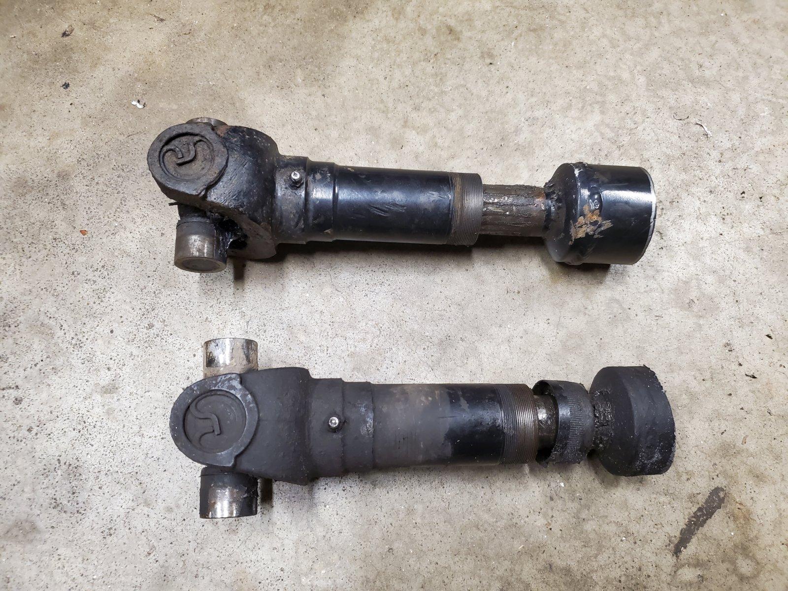

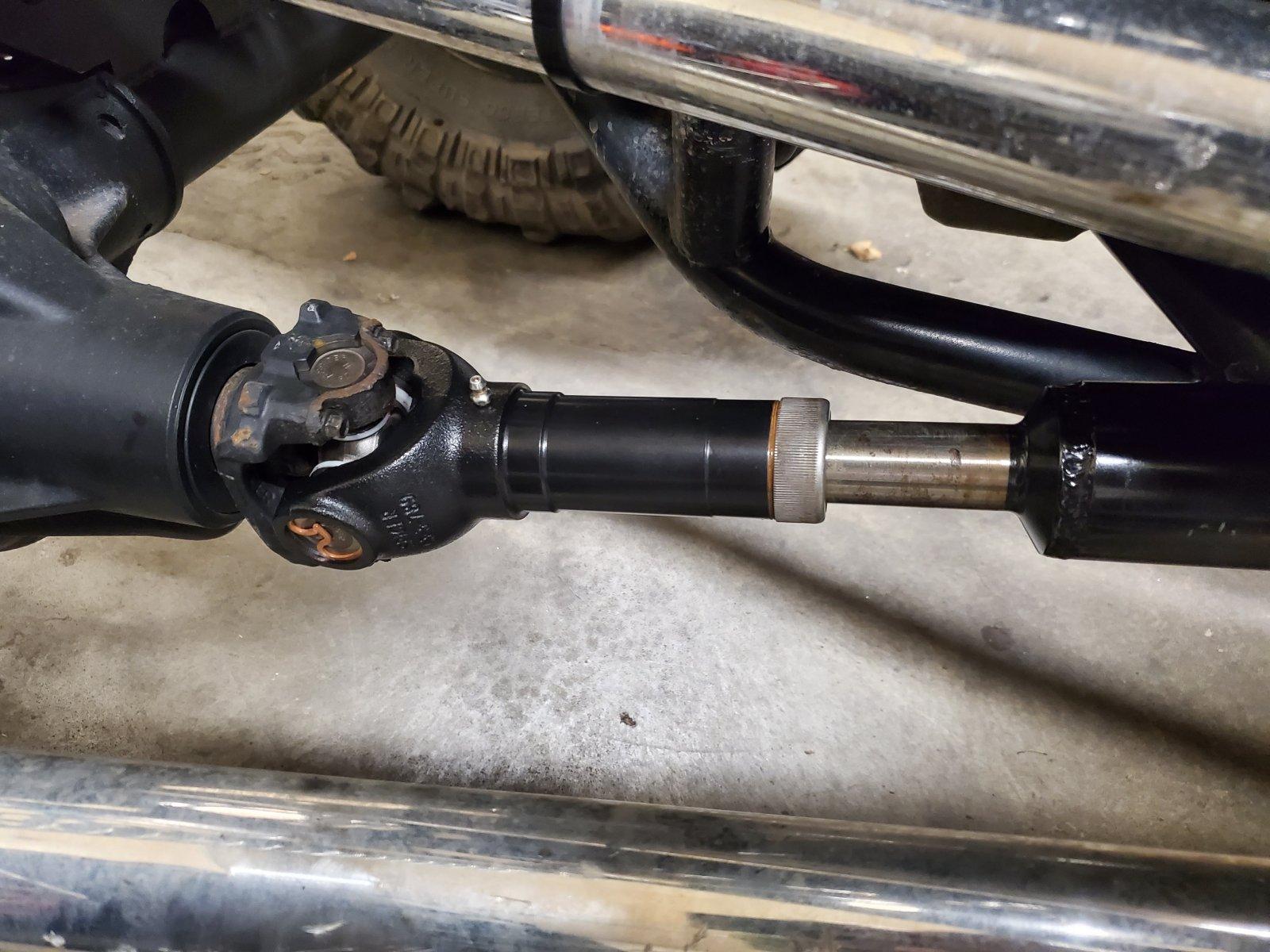

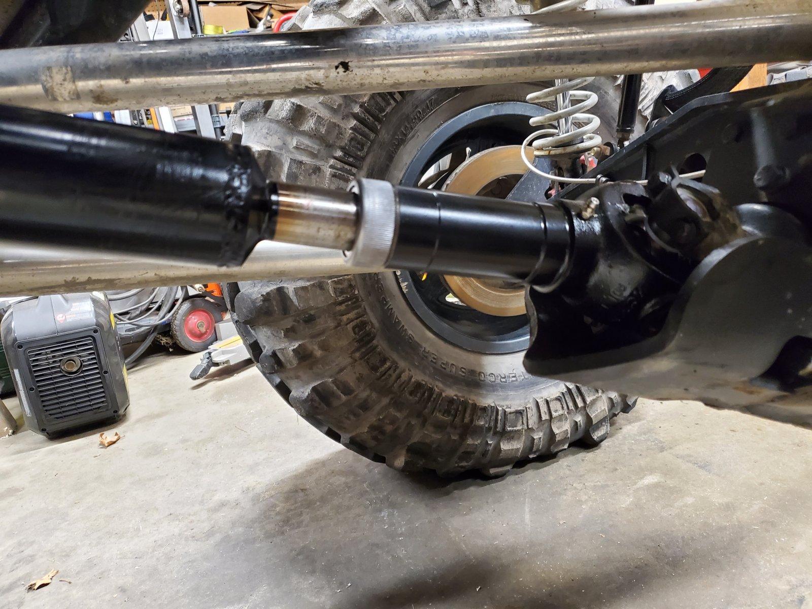

Small, lame update but I finally decided to address my driveshafts. Not long after I put it together, the blue plastic stuff on the splined end of the slip started puking itself out on the front driveshaft. I let it go but the last time I was out, I noticed the rear was doing the same. Both of them had a good bit of slop. Granted, they're 16x1.5 splines so I doubt they'd go anywhere soon but with the Harlan ride approaching, I'd rather not risk it. Luckily, I found some splined ends that are a little longer than my original ones so I could just chop off the old ones behind the weld instead of grinding it out to keep the original tube length. At least I gained a pair of good, spare ujoints

I may be splitting hairs here, but I'd flip those driveshafts around.
Female end at the highest point will help not retain mud/dirt in and the tube is stronger in case of the contact with a rock than the male shaft that will bend.
My 2cts.
