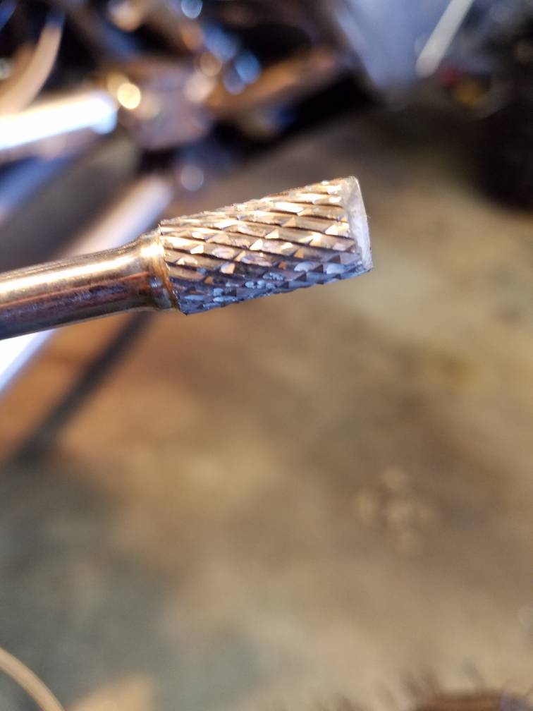

I doubt it. That stuff was tearing up my carbide burrs just cleaning up the holes I plasma'd in.

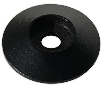

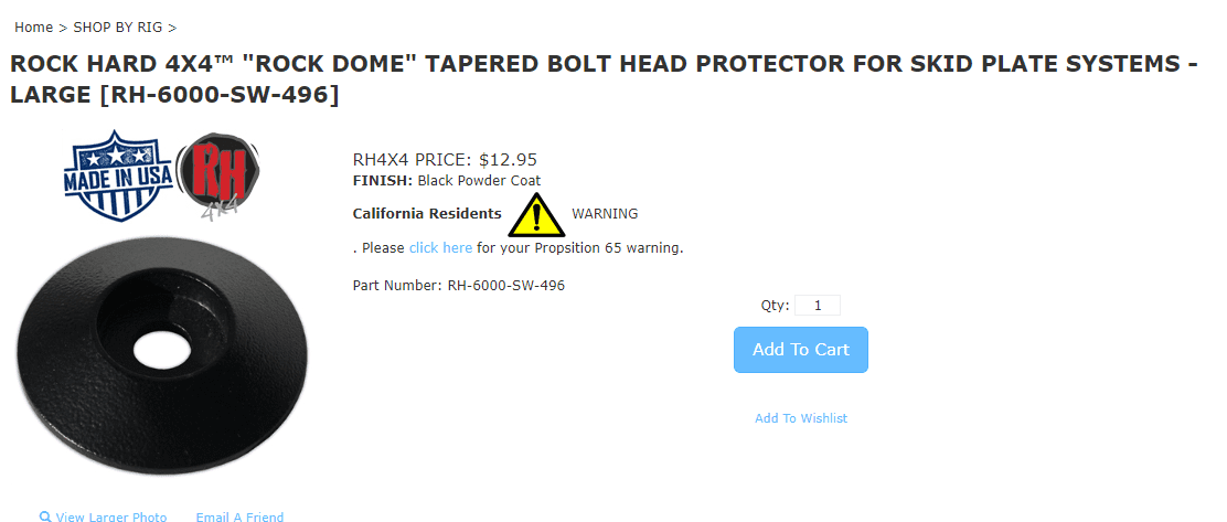

Eventually I'll probably run these bolt head protectors but at $8 a pop times 20 they get a little pricey. Not too bad but I could get at all of these with a monkey wrench if I had to.
holly **** no 13 buck each
