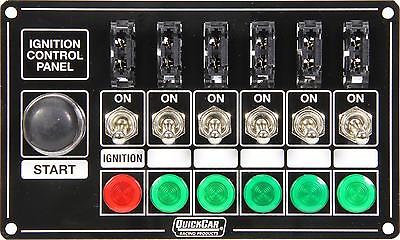

That cooling system is slick. Kind of bummed mine won't be ran through the chassis for a cleaner look. What switch panel did you go with?
Went with one from summit. Stole the idea from another thread on here.

I thought that was very affordable. I really like the 12 volt guy switch panels but 350$ is a stretch when I still need other stuff. Priorities. :'(
Man, I was thinking about using it as well but don't wanna look like a copycat... as if every other aspect of my buggy isn't cookie cutter already. ;(

And as per eddies request I took pics of the back of the panel
