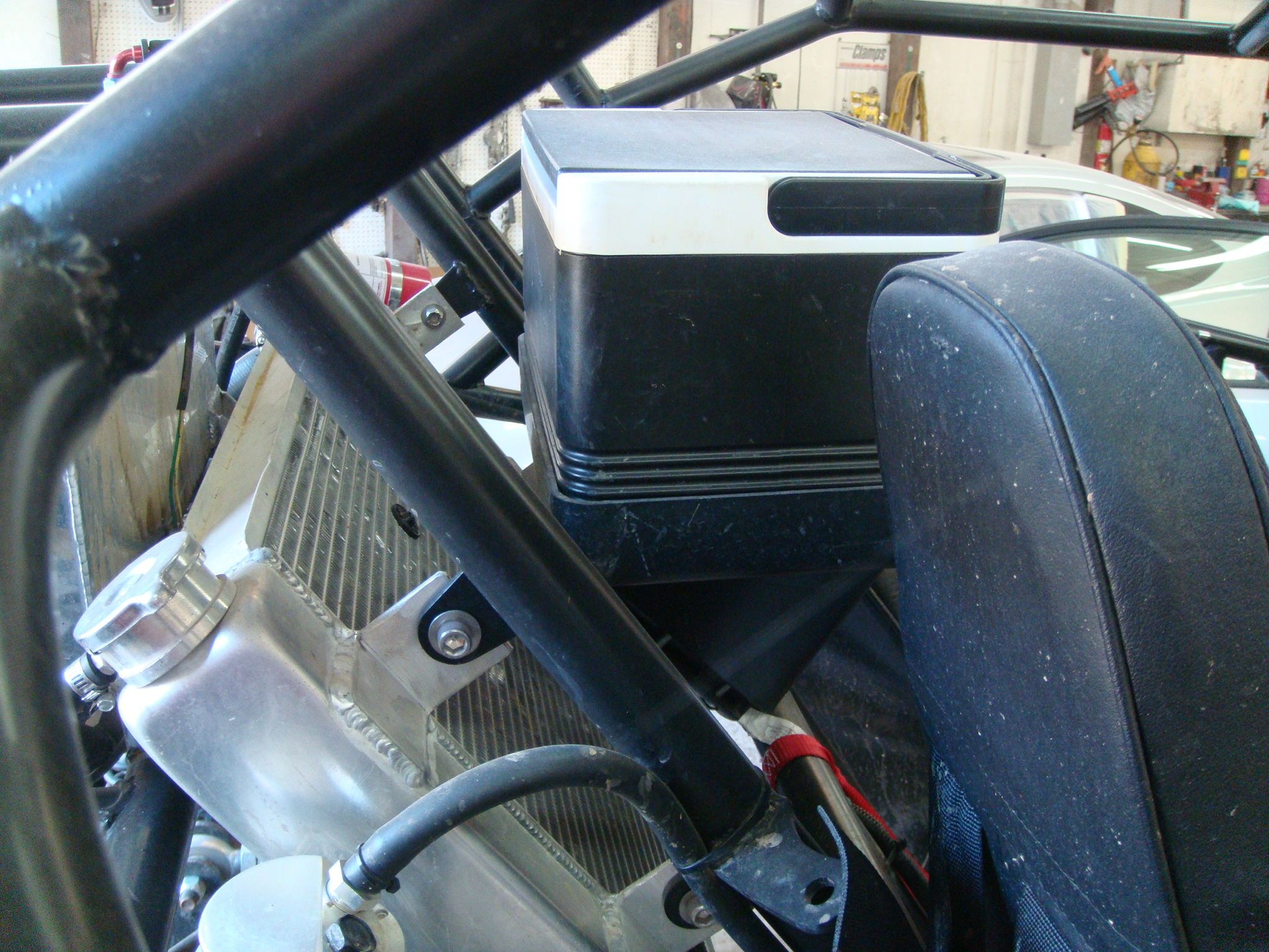

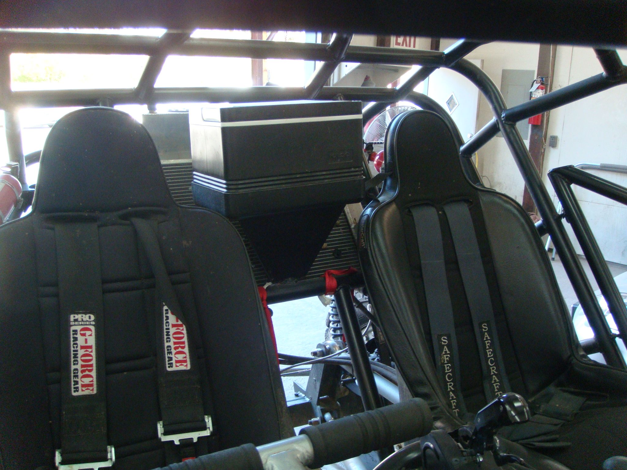

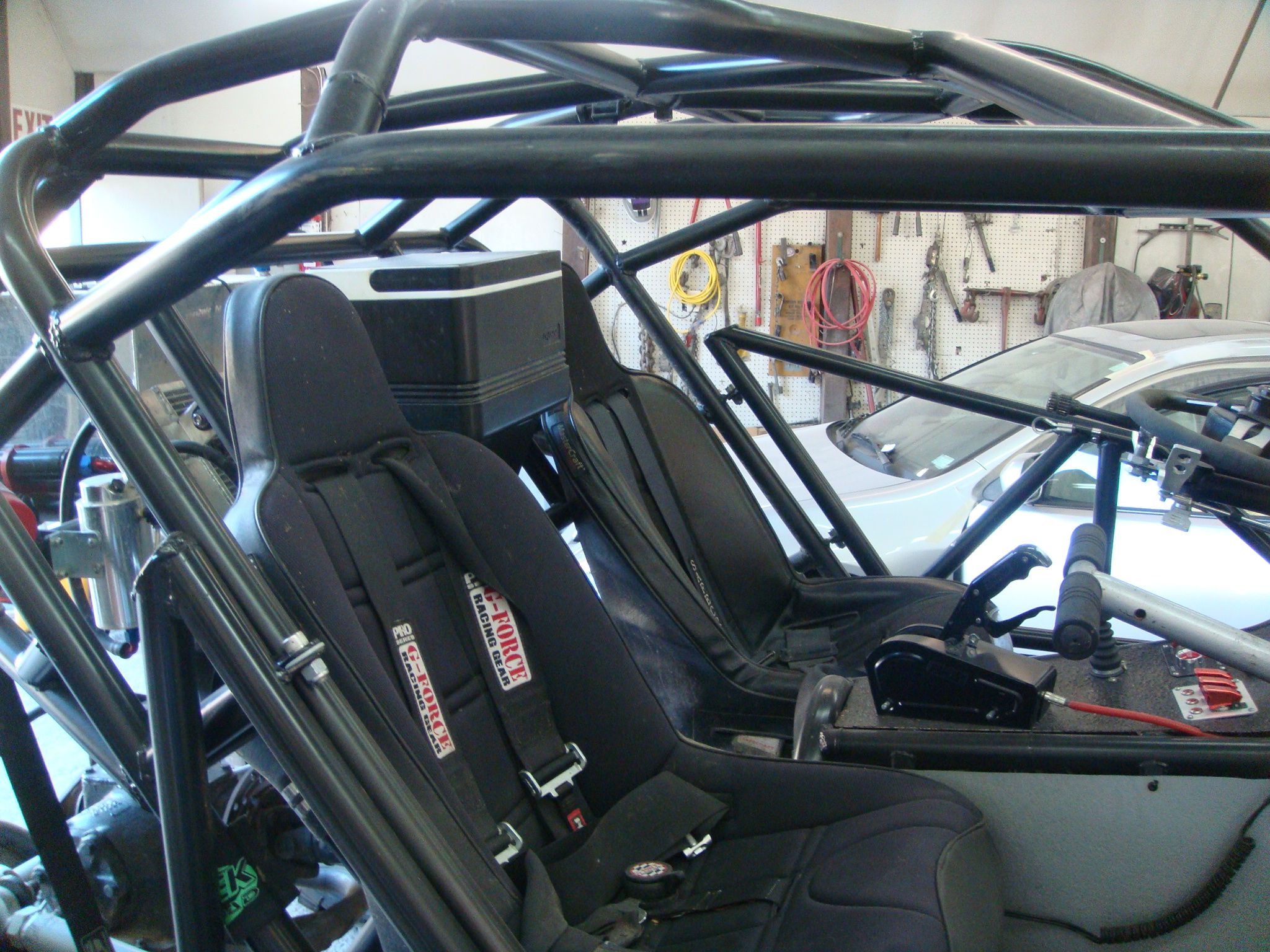

Buggy is looking GREAT! Here is a Picture of a cooler I put in my rig, a simple golf cart cooler. Weld a tube in and clamp her down. I put a strap over it for the upside down stuff but it worked out great so far? Just a suggestion, Keep up the NICE work.

I definitely like that cooler set up. I think I would want it a little lower, but definitely cool. What do you mean golf cart cooler?
Or a good roll and bout knock yourself out on it. I got stitches in my head from a soft cooler coming loose during a roll. of course it did have beers in it :drinkers:
