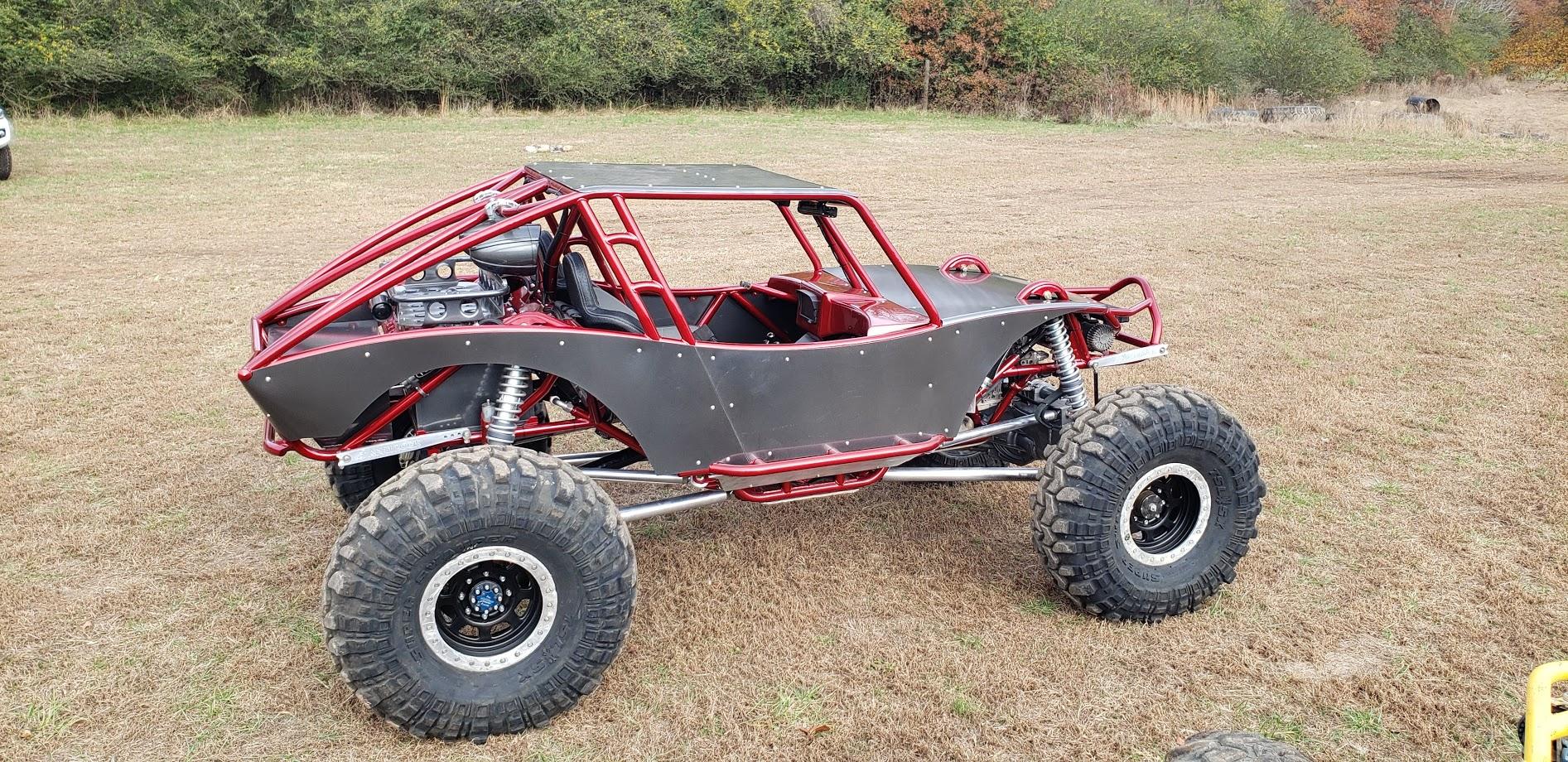

Turned out fantastic man. Any worry of the trans cooler getting plastered with mud and rocks?
The old cooler lived there just fine. I didn't drop it any lower. Just wider and taller than before.
That location has proven to work out pretty well as far as not taking spray off the tires. Many WOD buggies have coolers there and I've mounted coolers there as well previously.

Outstanding job Chris, looks like it came out perfect. One question though, what motor is it running and did you freshen it up any? I know you said he's running a MAST motor setup, just curios to what is in there. Your attention to detail is impeccable as I'm sure the Big Guy knows what he wants and expects.

If I'm not mistaken, the motor had been to MAST not too long before I started the rebuild. I know it has the MAST black label heads and a stroker bottom end. Andrew will have to elaborate on specs.

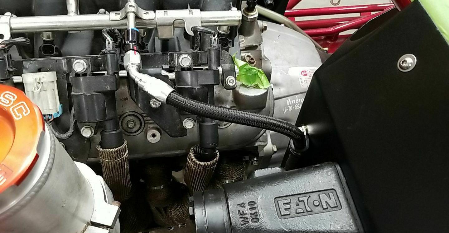

New fuel line with heat wrap and secured to the fire wall
I would not trust that plastic clip in the adapter fitting. It wasn't designed to hold a heaving fitting and line (even though you have it supported a few inches away).
I'd look in to changing it to a screw together adapter, or a compression fitting adapter on the end of the hard line.
Russell makes a screw together part # 644133
Earls makes a "fancy" compression fitting, or you could just use a brass one.
Same fitting has been on there for 8+ years. I understand and appreciate the concern. I re-used all the fittings I could and changed out hoses. It would be an easy part to swap out of Andrew feels the need.

It was freshened up by Mast shortly before Chris got it. It is a Mast built LS2 stroker, forged top and bottom end, Mast heads, 11:1. Makes plenty of power and is reliable.

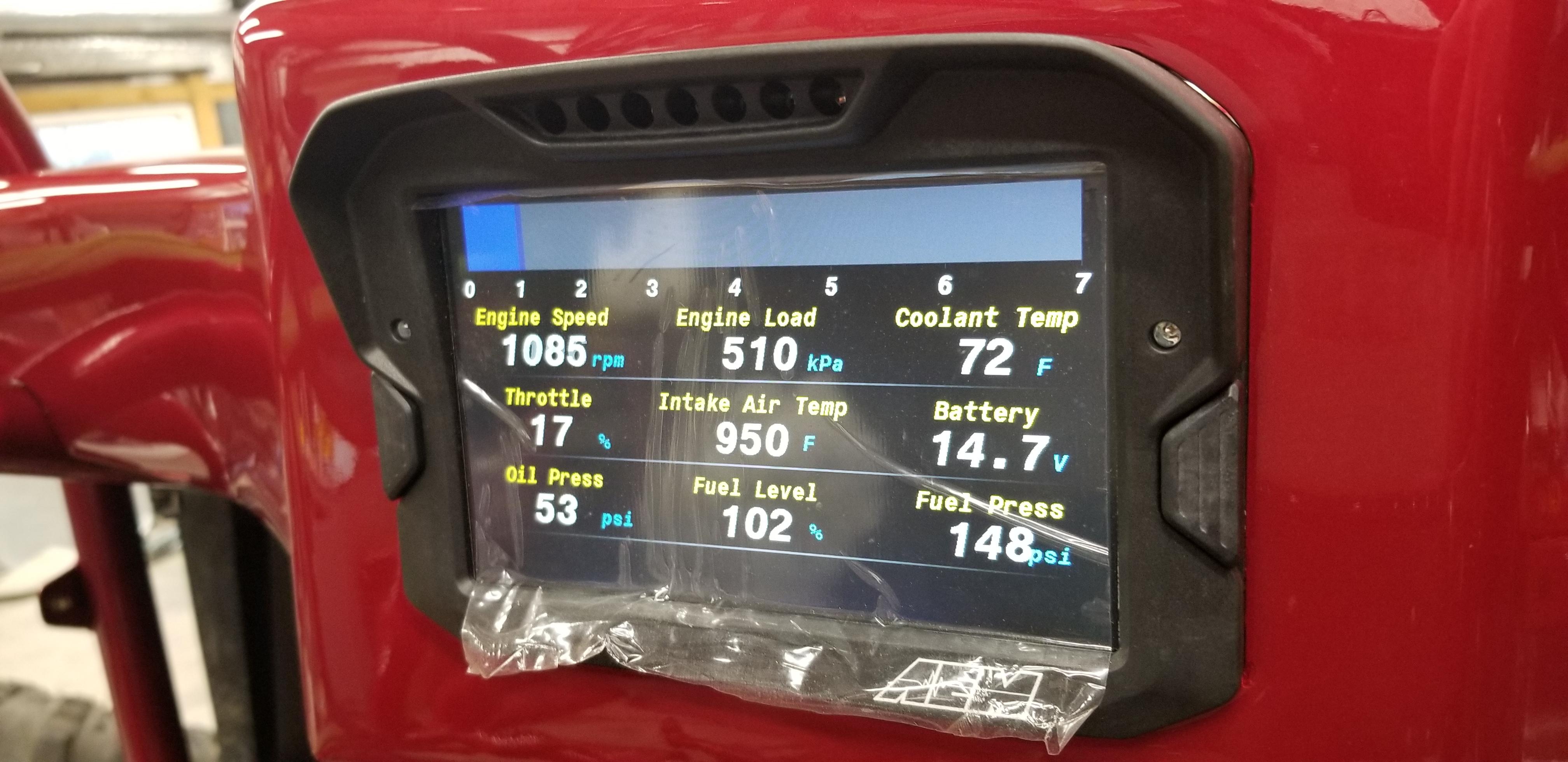

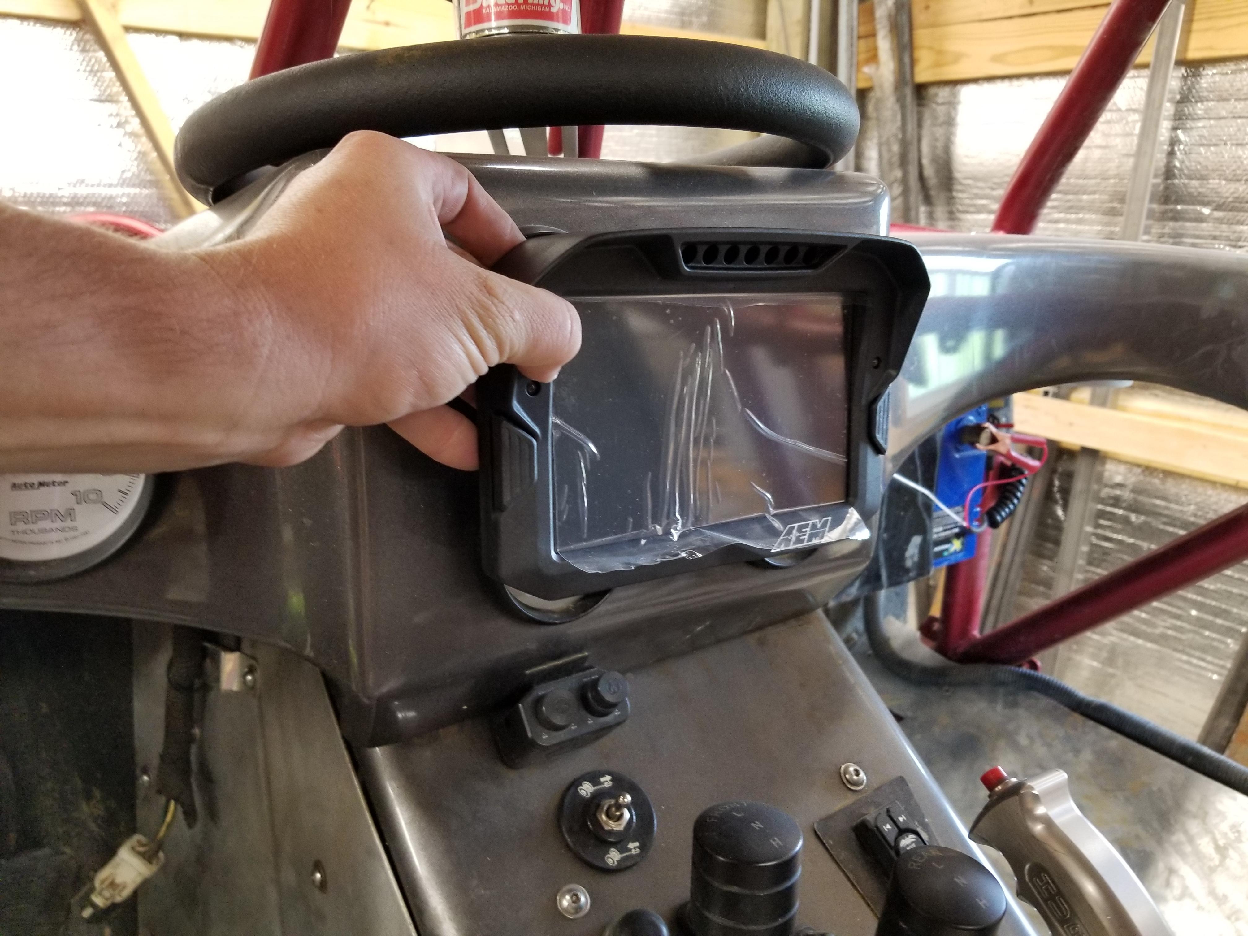

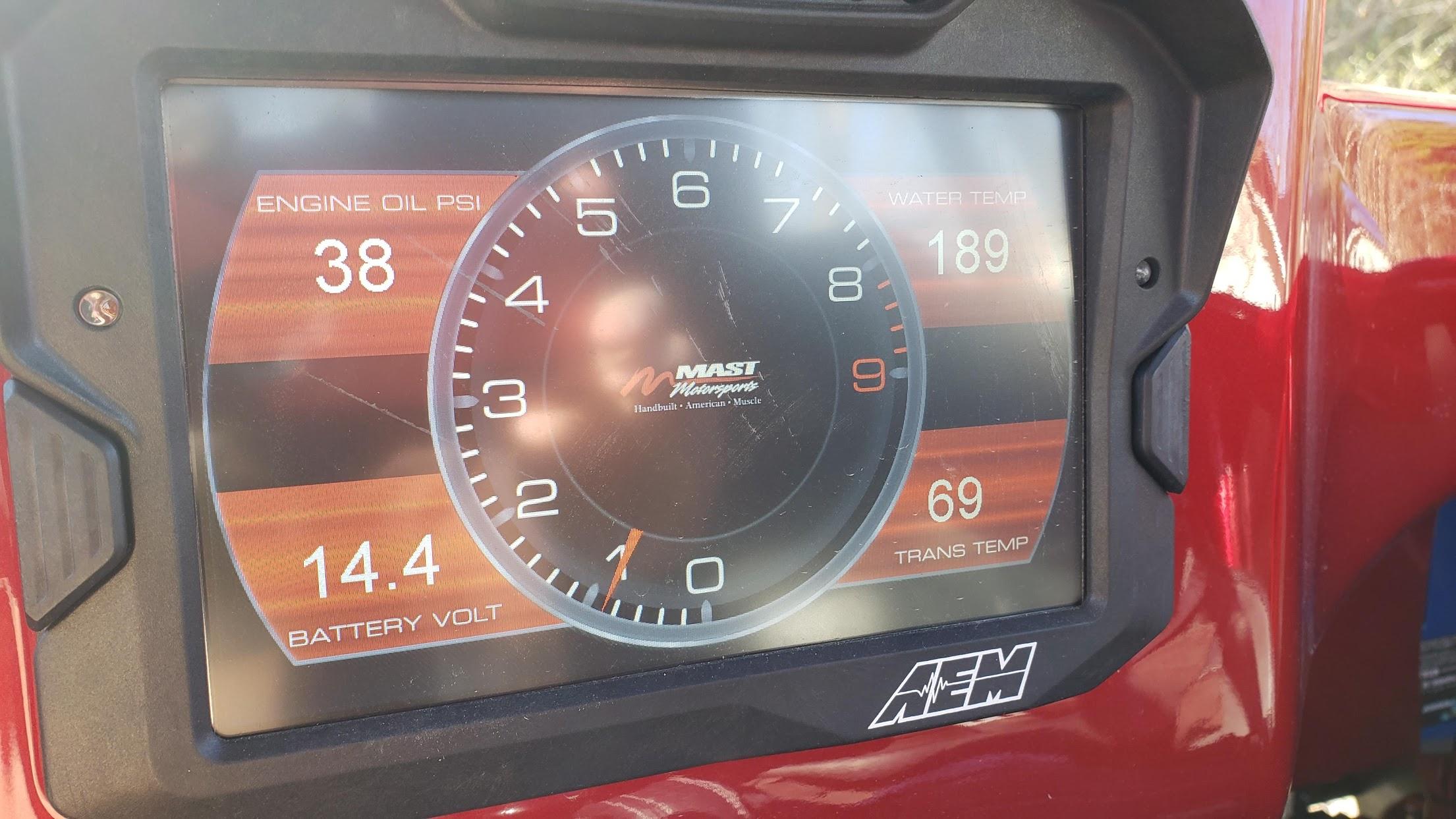

Something in particular Andrew wanted to upgrade was the gauges. He had done a bunch of research and decided on the AEM CD-7 set up.
Andrew worked with both MAST motorsports and AEM to get the MAST ECM and AEM CD-7 to work together. This is the basic display you get. Andrew has a custom lay out and back ground he can share.

If you are interested in the CD-7 absolutely go for it. I worked with AEM and Mast to get this done and it is extremely simple. All you need to do is download the CAN configuration from the AEM website https://www.aemelectronics.com/forum/can-configurations-3rd-party-hardware
You'll need to load that into your dash, pick up CAN1+ and CAN1- from the Mast harness, wire that into Port2 of the dash along with power and ground, go into the AEM dash design software and set your baud rate to 250k. That's it.
