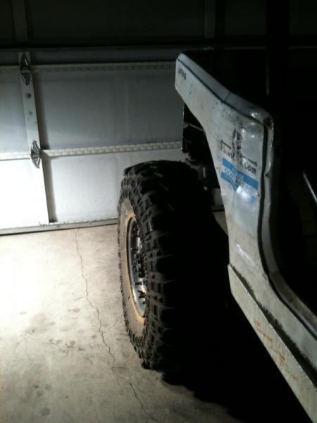

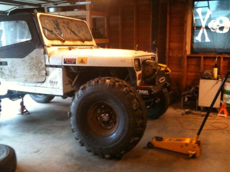

Looks good Matt. How do you like those RE springs? I just picked up a pair of them for the front of my truck, looked like a good way to gain much needed uptravel without having to get silly with mount placement.
If you need another set of those tires I know of a set of 4 with about 90ish percent tread, street and mud only that can be had for under $600...
I'm really happy with the RE springs. I got them second-hand from boxboy, and this is my second build of this Jeep using them up front. Quality spring that flexes well and can hold up to some abuse. My stock YJ packs were toast when I pulled them off, bent main leafs, s-shaped, etc and these are still goin strong.
I'm not sure if I want 14.5 tires, I will think on it and maybe get in touch with ya at a later date.

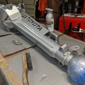

Now debating whether to really dig into shaving the 14 bolt by cutting the bottom off the housing and re-welding new plate, or just trim the big fat lip off the bottom. The 2nd option means I lose the bottom bolt... will it leak (with a trimmed stock cover)?

I am also debating this right now. I have heard some horror stories on pirate about lost fluid capacity on shaved diffs and burning up the fluid/bearings during high speed driving/highway type stuff.

I left mine alone in fear of this.With that bottom bolt missing I would be worried of some how hooking the cover on a rock and losing the fluid.
The lower lip of mine is shaved and smoothed. the cover is trimmed about 1/8" higher than the housing so it can't catch on a rock.
I have a 1/4" thick cover for it, when it goes on I'll tap a couple 1/4x20 holes in the housing for bolts again.
Any leaks with that bottom bolt gone? I suppose it wouldn't be a big deal to drill and tap for two smaller bolts to go in place a little further up.

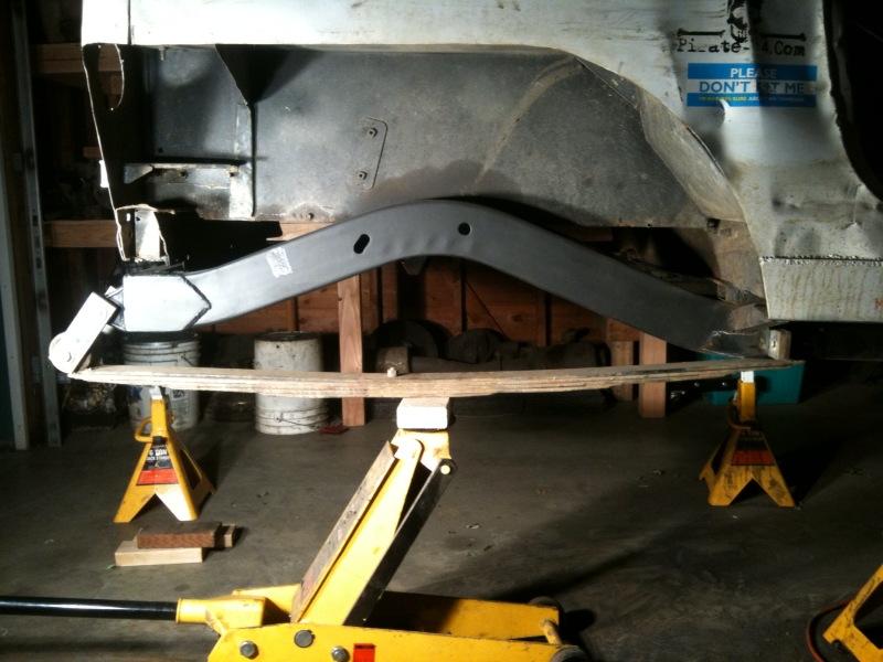

Also, finished the rear springs and did a quick dovetail on the rear body, just 4" out of the back section so I can still use my tailgate and still fit the back seat in.

Ahhh 42's last years 40, 1989s 35's! looks great man, love the spring mounts. clean job:cheer:
Yeah, they turned out *****in. I'm going to remove the extra main leaf from the XJ packs in the back to lower it down just a little more, depending on how much the extra tube, fuel cell and seat make it squat in the rear.
The front needs a little bit of re-working. I need to move the frame mounts forward about an inch for another inch of stretch, a little better shackle angle, and it will also tilt the pinion up a slight bit and the caster forward on the axle (it's dead on at 7 degrees right now, I'd like between 4 and 5). This will also give me a little extra room so I can hopefully run my tie-rod on top of the knuckles instead of below, since I'm not running high steer.
If I buy the 42's, I will put the 2" spacers on the back, and get dually hubs for the front and run the H1's un-recentered.
Now if Geno from Advance Adapters would just call me back to get the details on my transfer case so they can start building it, I would be one happy Matt.
