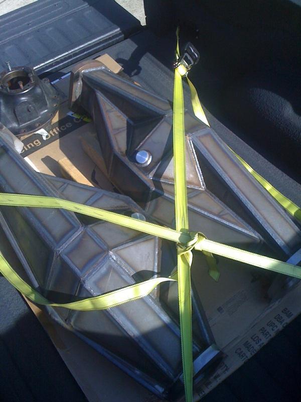

How about something like these.
rockwell front loader. a little bigger than the c103
why not a c103? it will accept 2" shafts and has a 12" ring gear
