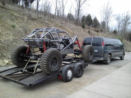

Didn't get to weigh it this weekend but did get out a couple of times with it briefly. Friday night I took it over to a friends farm and played around a bit until the front seal on the steering pump died. Saturday I replaced the pump and played around on the hills behind the shop for about a 1/2 hr. The engine still isn't tuned so I didn't beat on it too hard. So far I'm very happy with it. Coming from wheeling a mildly build TJ this buggy will open up a whole new world to me.

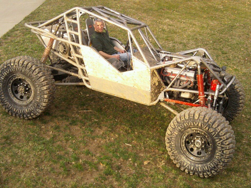

Spent some time on the dyno and then a few hours in the woods doing some tuning and addressing any issues. What a great day. It felt good to sling some mud. Ready for the riding season.
