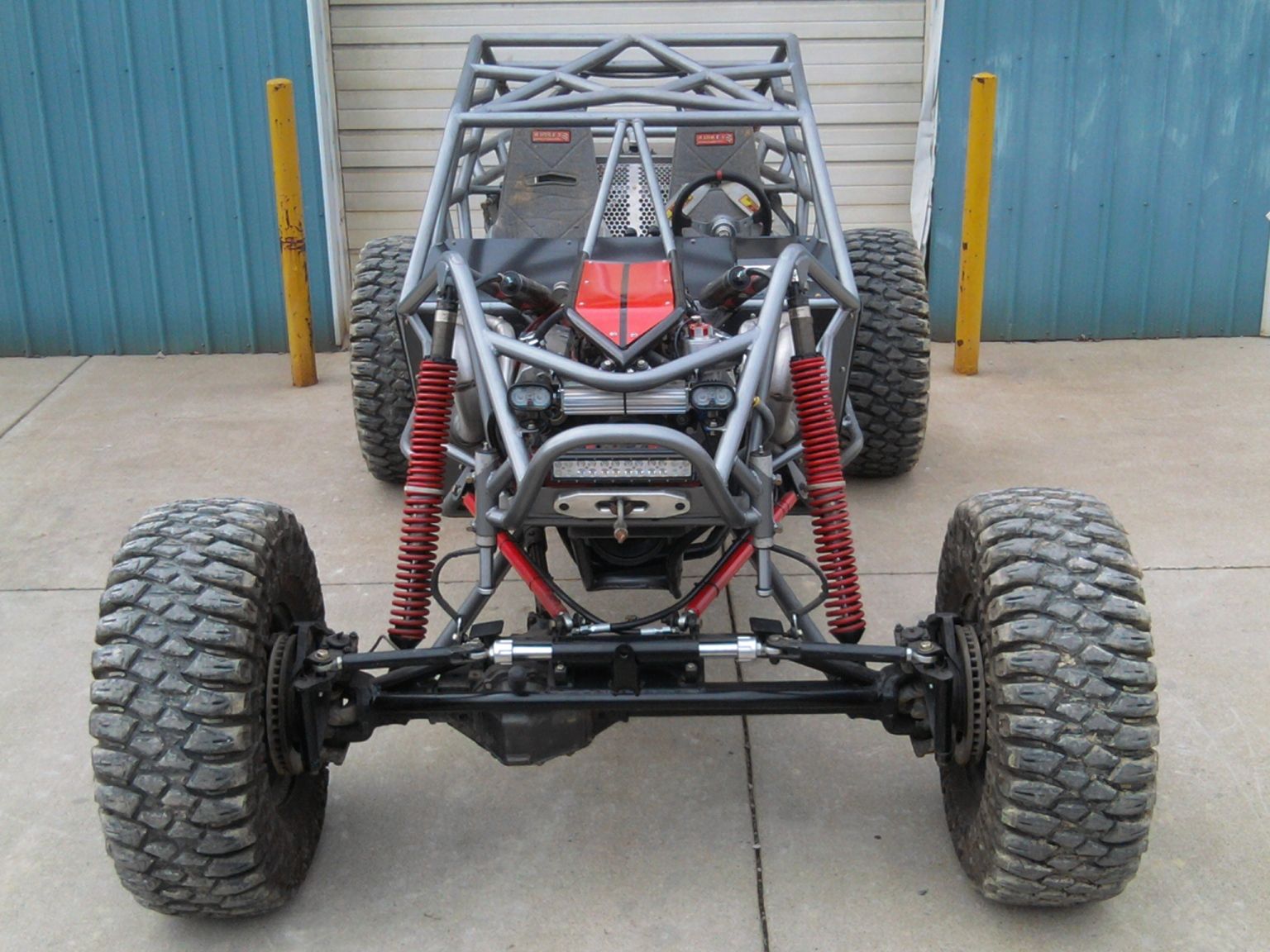

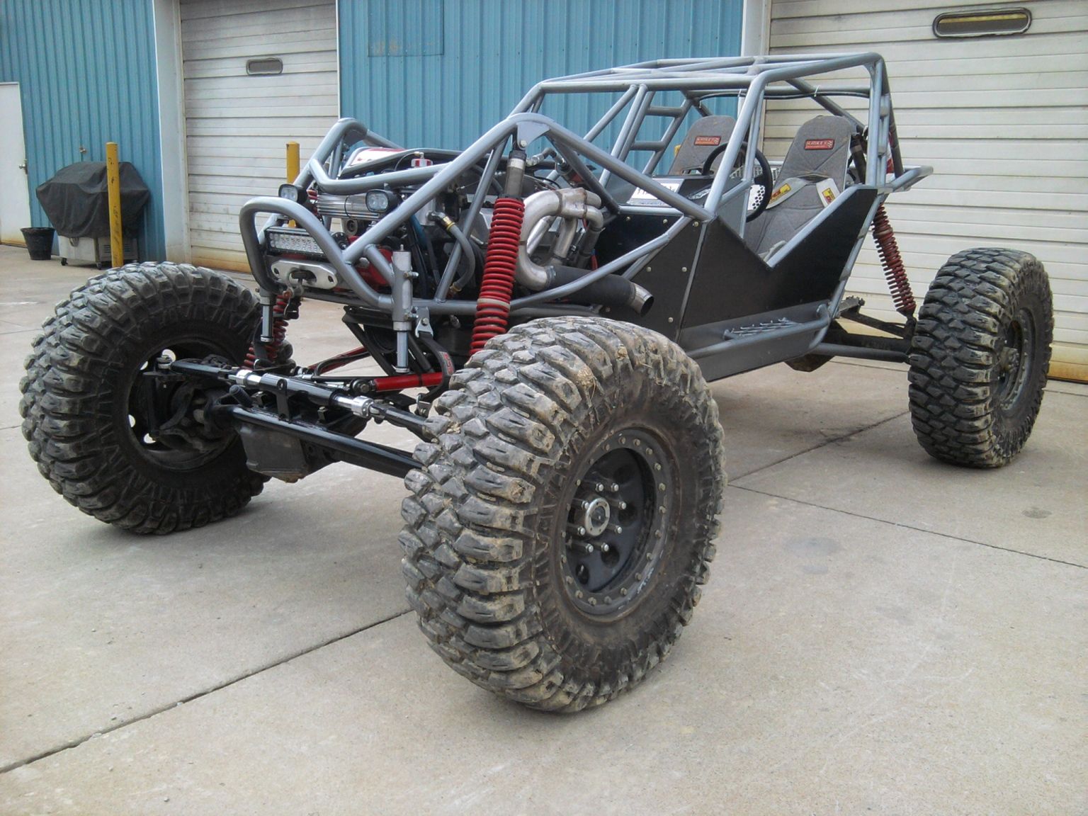

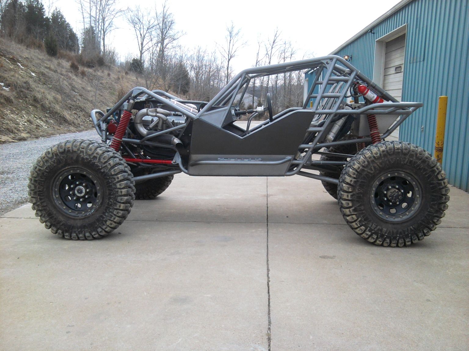

Heading to Rush on the May 10th. Dyno tuned the buggy last week at Cincy Speed. Made 334 rwhp @ 6000 rpm with the new 383. Power was still climbing but I set the limiter low for now. If I need more wheel speed, I'll turn it up. 100 more rwhp than the 406 I removed. After tuning I went out and rode for about 5 hrs with no issues. Looking forward to getting out and riding. Now if it would just warm up >:(

Maybe I'm just not seeing it but I see you ran hoses on the front links now instead of going through the tube. Why the change?
My ram self destructed last year and sent metal through the entire system. After attempting to flush the links out I didn't feel confident that I was able to remove all the metal and didn't want to risk damaging my new KRC pump, ram and orbital. It probably would have been fine but didn't want to risk it.
I think its 88.5" wide up front. The rims have about 6" backspacing so that negates some of the extra width of the dually hubs.
