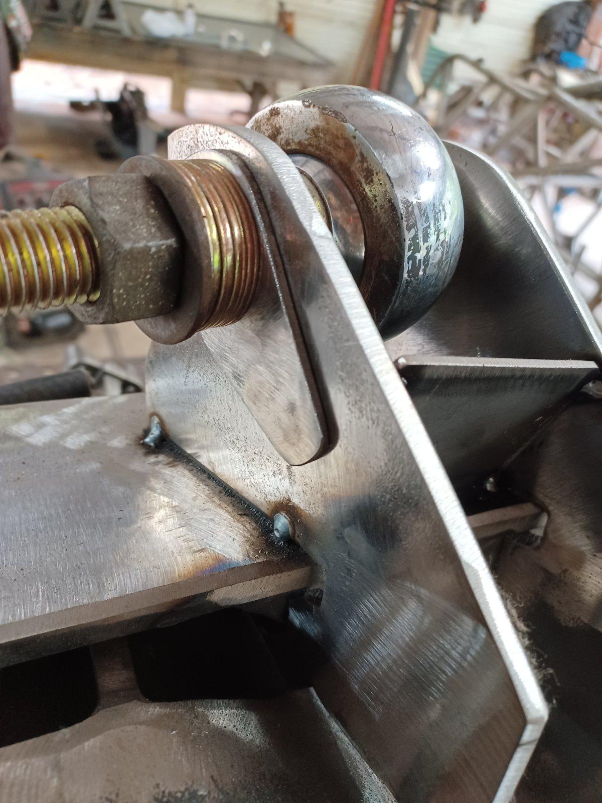

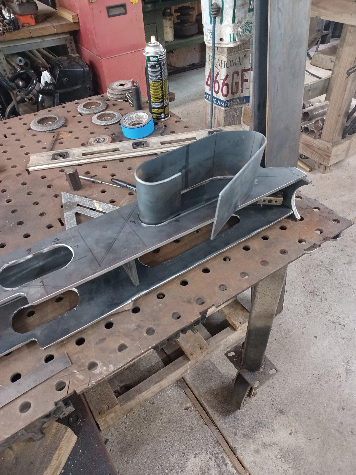

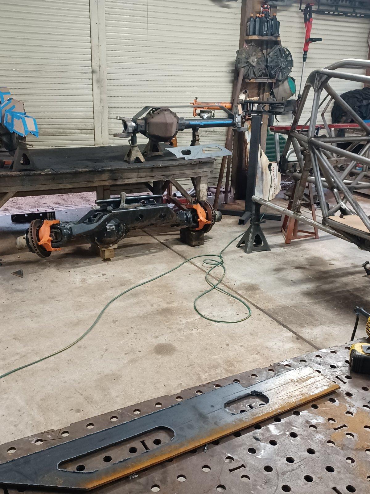

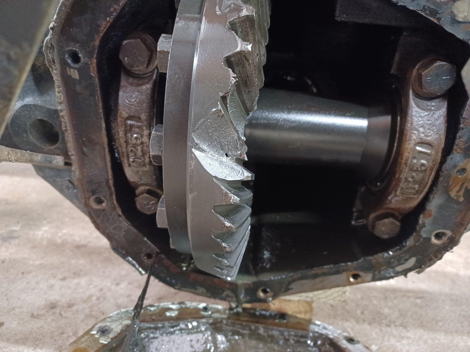

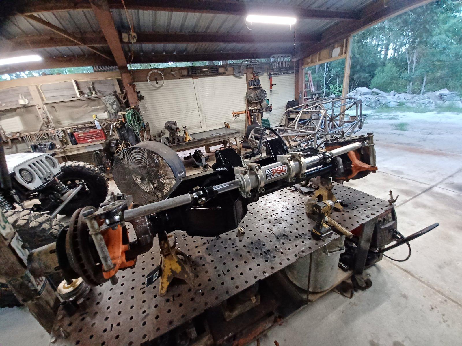

Baby 14 bolt for it, it doesn't break shafts(yet)but it destroys lp60 gears so this is done budget friendly just to get a better ring gear.
Solid Cs, everything out is robbed from the old 60. Crane rev14 seals and a MW spool, custom long side from ecgs should be here in a week and change. Short side is a random 15.97" dodge/ford that everyone stocks in 4340

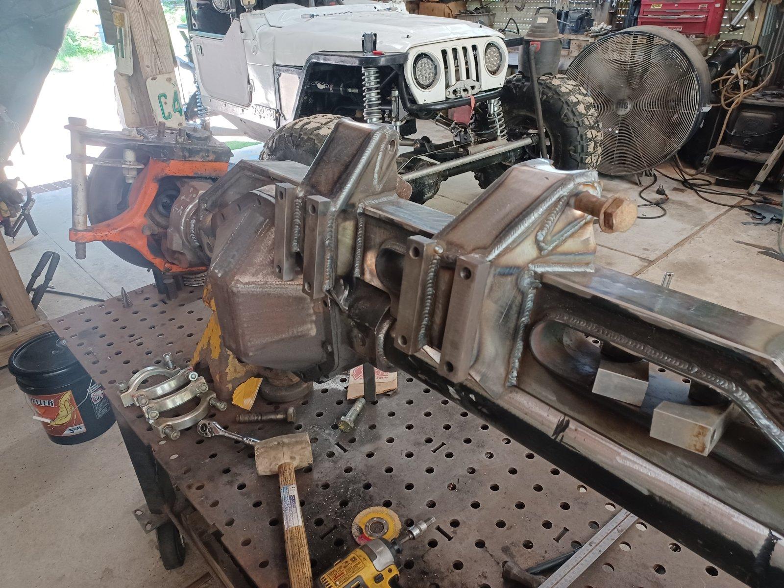

That's a short pass side tube.
How did you manage the lower link mount?
Idk yet lol, it's as long as it could be without the pinion offset and driveshaft getting into stuff. This is built to match the 60 wms, any wider and it wouldnt fit in his enclosed trailer. Half the bracket will get tigged to the cast with pre/post heat and with a lil luck it'll stay
