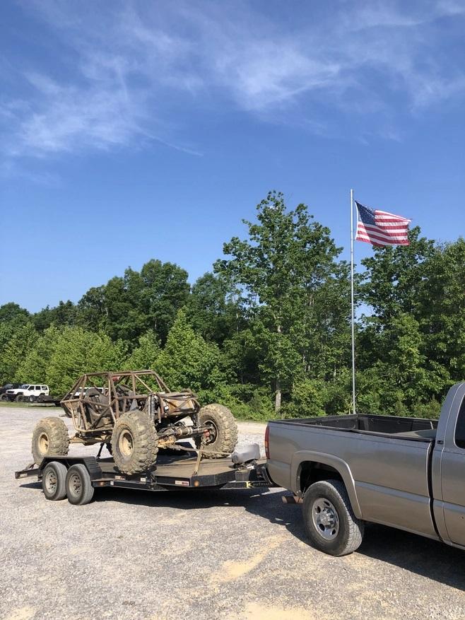

Thats awesome, a friend of mine had tim build it for him, its been in my shop since it was built. After i got my sons buggy built i needed something to go wheeling with him so i bought it earlier this year, been trying to get some things lined out on it, gonna LS swap hopefully this winter. We'll have to meet up some time and do some wheeling and ill have to check yours out to get some ideas for future upgrades.

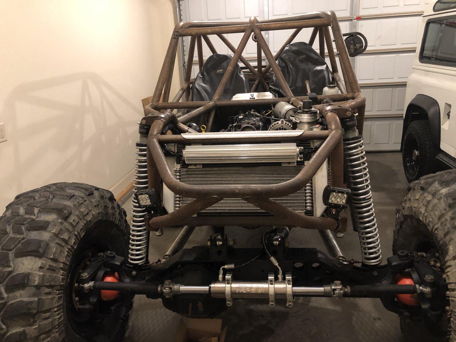

Bent the light bar a few rides ago. Had to drive out of Tackett Creek with no light which was a lil sketch.

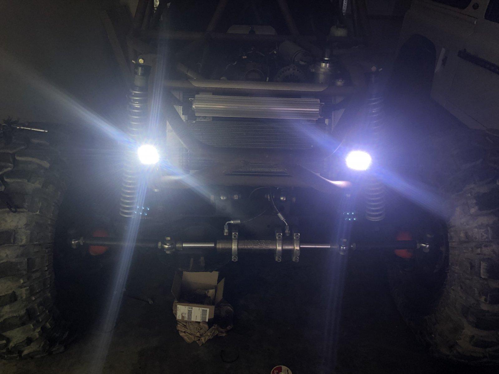

Removed it and swapped it for some pods. As much as I loved the big bar and the look it gave it, it also turned me into “that asshole” every time I’d turn it on and blind everybody around.
I’m hoping the pods will be more protected and the light output will be enough for what we do around here.
Everything is done with half decent wire and Deutsch connectors as usual.

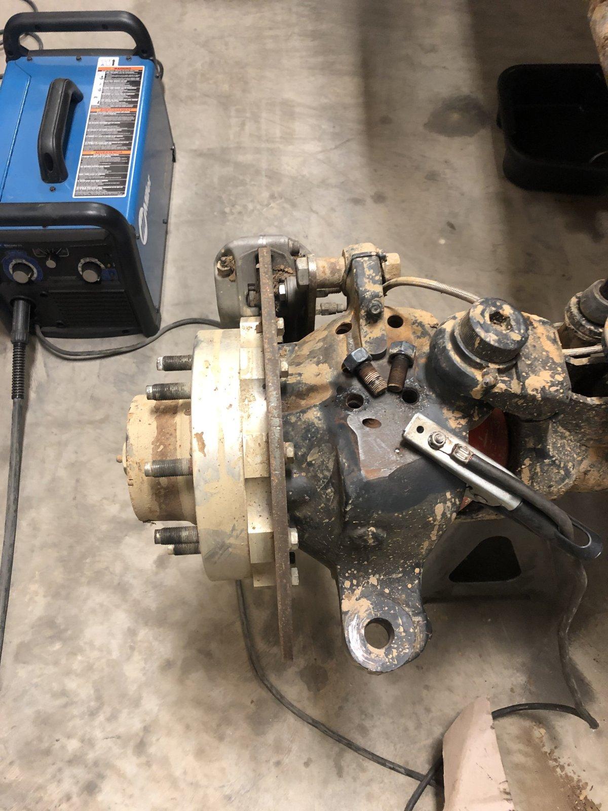

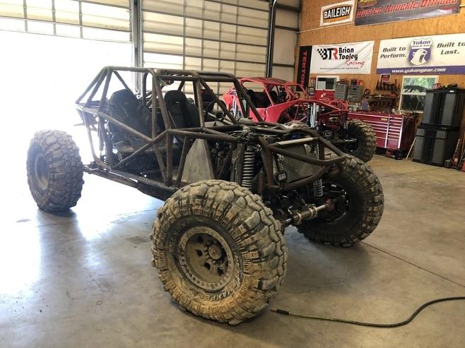

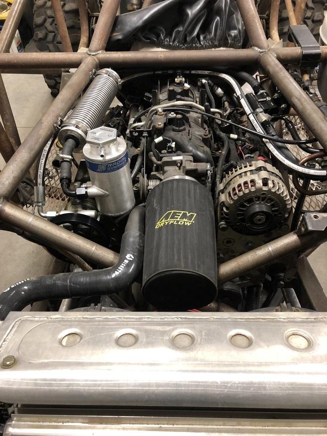

Replaced my P-Pump that died last ride with a new RD steering system (CB-X pump, filter and fancy resi). Moved the pump to pass side, way higher than previous setup. Everything is located the way it is in order for maintenance to be easy.
Rd

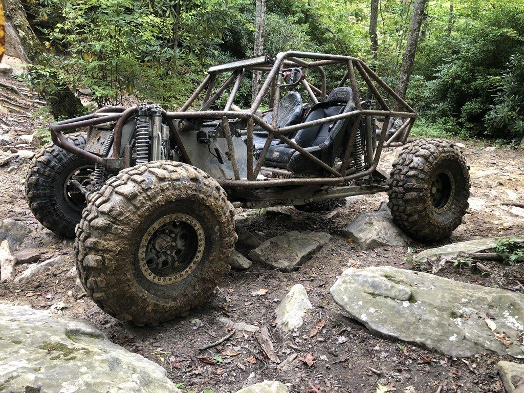

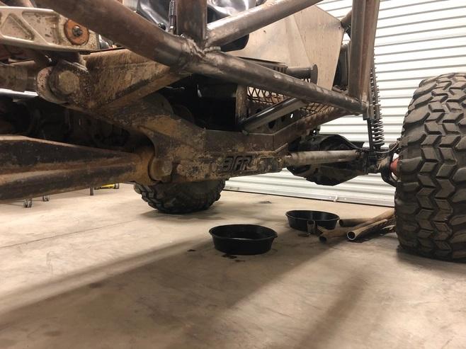

I chopped the steps that were bent to **** and replaced them with a 4ft piece of solid rod to help distributing the impacts and hopefully let it slide better on the rocks. I also added a .188 wall kicker going to belly.
Side
Side2
Side3

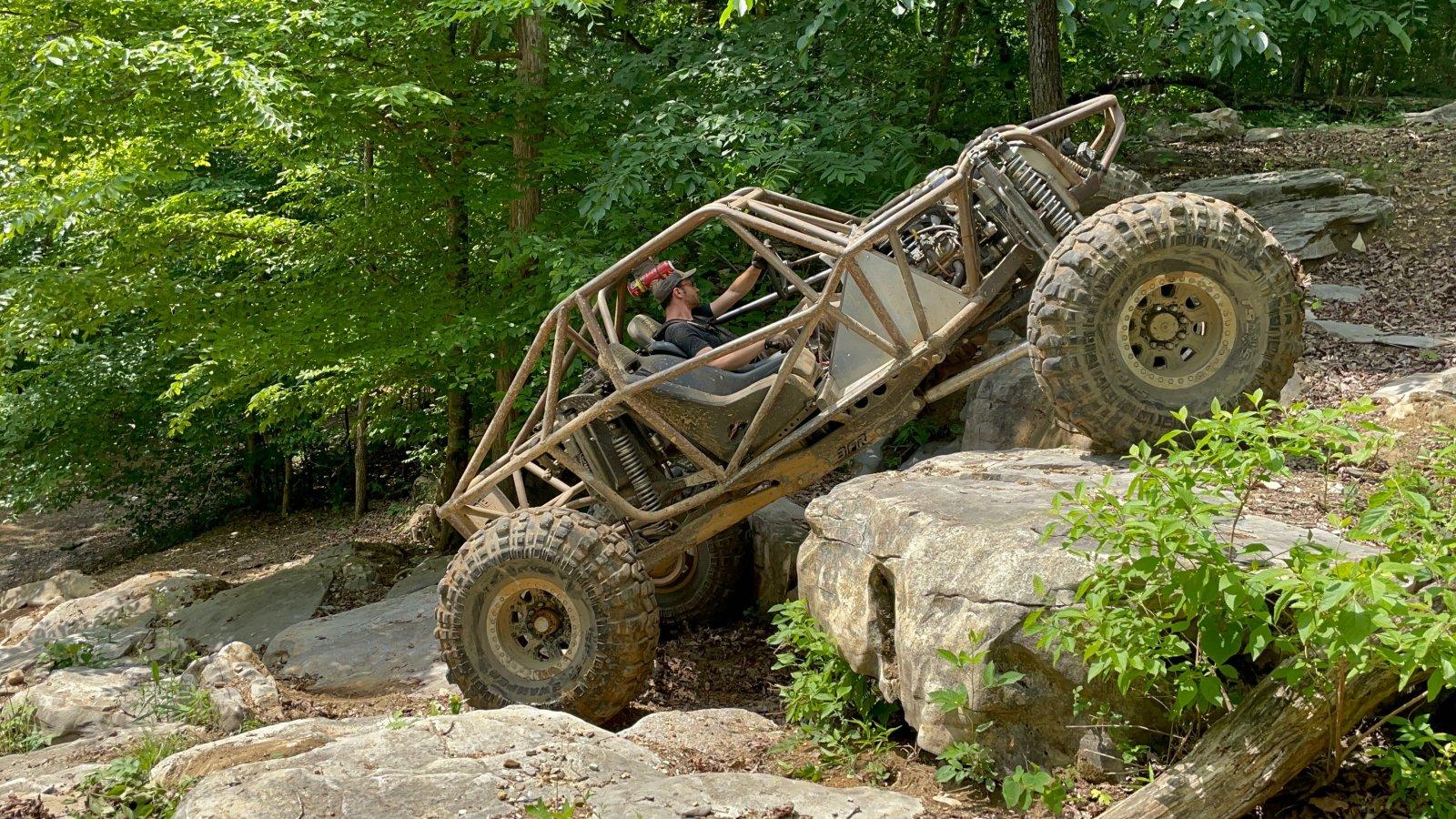

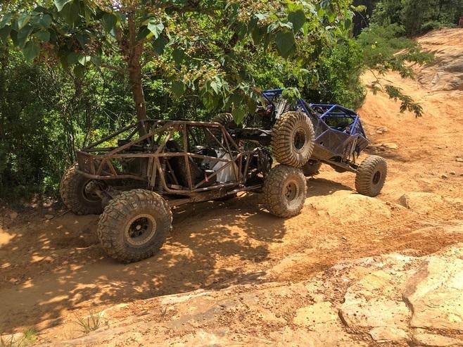

Went to Stony Lonesome for testing last weekend. Rode with Jake Burkey and the BK crew.
Didn't have to turn a wrench once. This rig impressed all day and made everything his biotch.
RD setup delivers ! (I'll write a more detailed report about that in the future). My face had a **** eating grin all the way back home.
