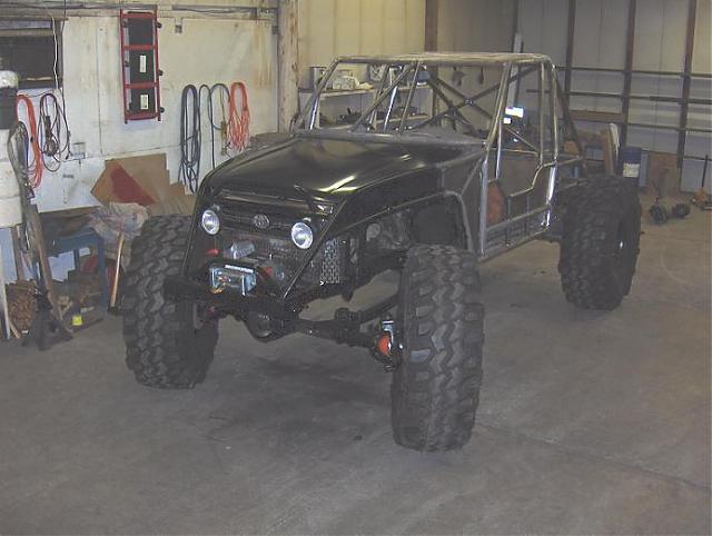

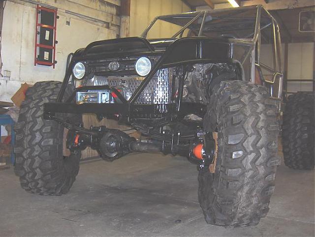

The usa 6x6 wheels are 2" wider than stock, so 10.25" wide, and the width was added to the outer half to keep the hummer backspace the same and to help protect the outer flanges a little bit.
Here is a couple of updated pictures for you guys. Got the front & rear axles & lockers all set up. Transmission and transfer cases and skid plate assembly all installed. Also put on a brand new 12,500 lb T-max wench. All wiring is finished and should be ready to do the final paint on wednesday. It is pointed south for the Hammers. :fawkdancesmiley:
