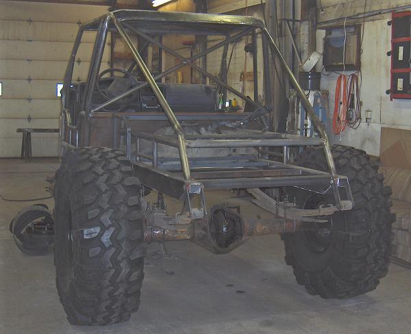

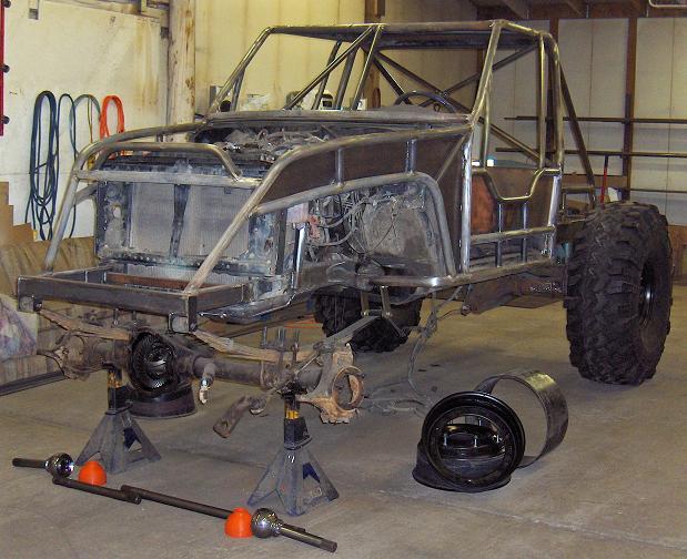

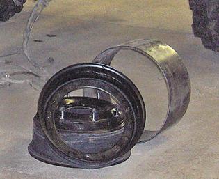

Well It Looks Like Bobby Finally Talked Me Into Building A Buggy. This Started Out As A 1998 Toyota Tacoma Sr5 Extra Cab 4x4 Pick-up Full Width 1 Ton Axles, 5.86 Gears, Detrioits, 47 Inch Ltb Swampers, Usa 6x6 Double Bead Locks, Dual Toyota Transfer Cases With 4.7 Gears In The Rear Case, 120 Inch Wheel Base And 63 Inch Chevy Springs, Full Hydraulic Steering, And Of Course So I Don

Why would you take a 98 Toyota( still pretty new) and make it into a buggy? Are you that rich? What ever is your cup of tea. I am NOT doggin' on you or anything, just asking!!! How are those tires doing for ya? Make sure to get alot of pics!!!

Thanks everybody! This thing is going to be a blast! I can't wait.
What did everyone do for full hydro? Ram, pump, resivoir............I need to order parts this week and need a little input, thanks.
