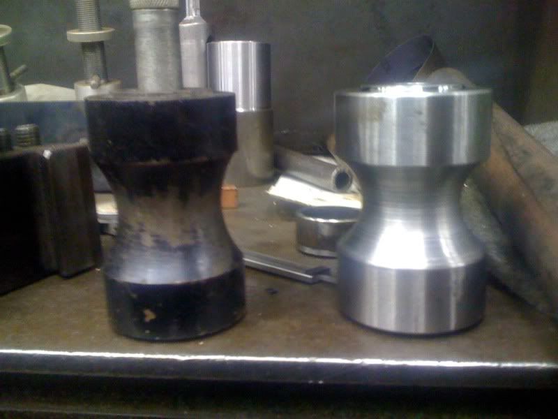

Well for us poor bastards who bend pipe with their $80 harbor freight bender know that anything bent past about 30* gets dents from the outer dies not being true to form. So I'm trying something. Made two new outer dies that fit the contour of the pipe.

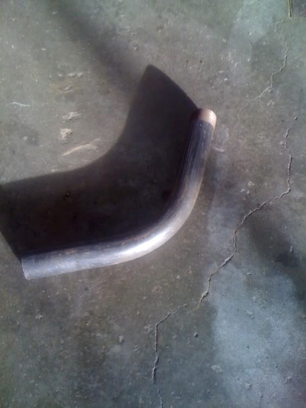

I bent a test piece to about 75*~80*......No dents. It works great!
Anybody interested is a set of these? These ones are for 1 1/4" pipe.

Yep those are good ideas too.... Im just bending pipe....NOT TUBE. I haven't bent to a full 90 yet. I think I would make a set for $75 + shipping. Made from 4140 steel.
The best 90 Ive seen on a HF bender was with a custom die made from a rope shiv built up on the sides a little. It was a complete 1/2 circle that was about 16" across. The die would barley fit between the rollers on the widest setting. It would do 1.75 .095 wall fairly good, and a 90 no prob.
I just used a piece of 3/16 flat plate welded across and bent a piece up as scrap to bend the flat plate then welded the other side worked on all the sizes of dies it had :awesomework:

I like the machined roller idea! It would save half the headache.
